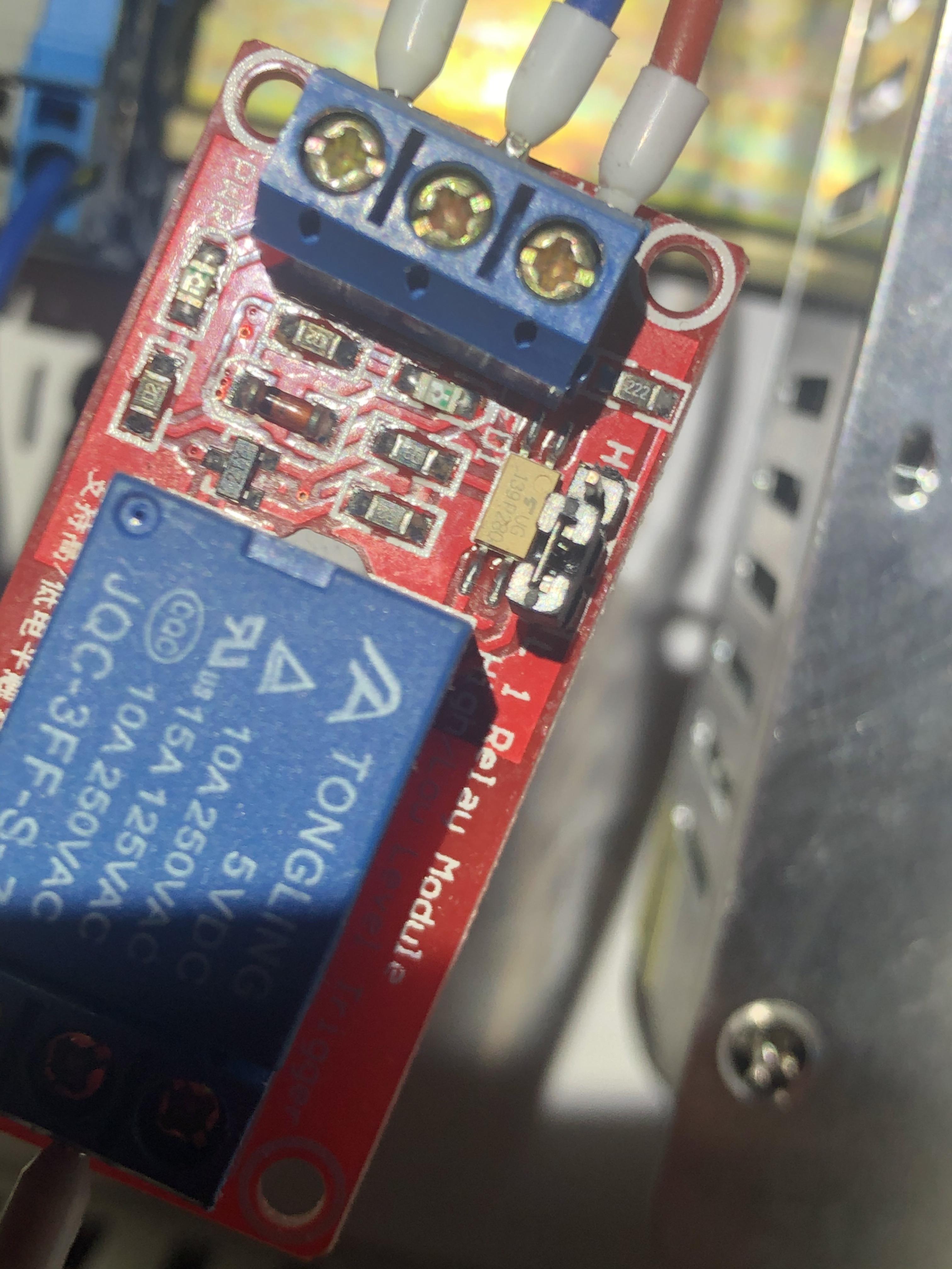

    I bought some fake wemos D1 mini on allegro for my project. Among other things, I connected 2 relay modules to it where the 5V power supply, ground and control from the microcontroller are connected separately.
    The wemos power supply goes from the 5V power supply and the relay coils also from the power supply. The wemos pins directly connected to the relay board. It's been running for about 2 weeks and today the wemos went haywire, it doesn't start at all and the esp chip immediately gets hot - smd version.
    I'm guessing that the stabiliser chip is probably dead and maybe that's why it's getting hot or some kind of short on it.... I'm going to order a second one for a replacement soon, but I'm wondering if maybe these relay modules pull too much current from the pin and that's why it whipped the stabilizer? Is it possible to connect the relays to the wemos directly like this? or do you need to via some transistor?

    The current capacity of the esp8266 pin is nominally about 8mA at 3.3V voltage. Until we know the schematic of the relay module, it will be difficult to know anything conclusively.

    the stabiliser is rather ok as I checked with a meter and the voltage on the 3.3V rail is as required. The relay module is opto-isolated so the esp pin is connected to the optocoupler so there should be no problem with too much load.
    • Wemos D1 mini and relay modules - is direct connection OK? IMG_4761.jpg (779.23 KB) You must be logged in to download this attachment.

    D1, D5 - high state controlled relays.
    D2 and D7 - shorting buttons to GND.
    D6 - 1wire I don't know if this can make a difference but I have a 5v power supply to the dallas
