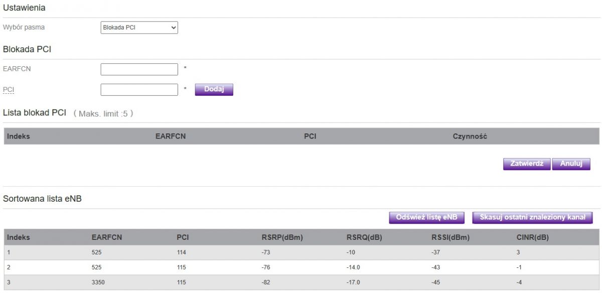

    Colleagues, I need help with setting locks on this equipment.
    Screenshot of PCI lock settings interface for BTS base station.
    How to set a lock on BTS LBN1023 eNB ID:32057.
    How to translate this into EARFCN and PCI?
