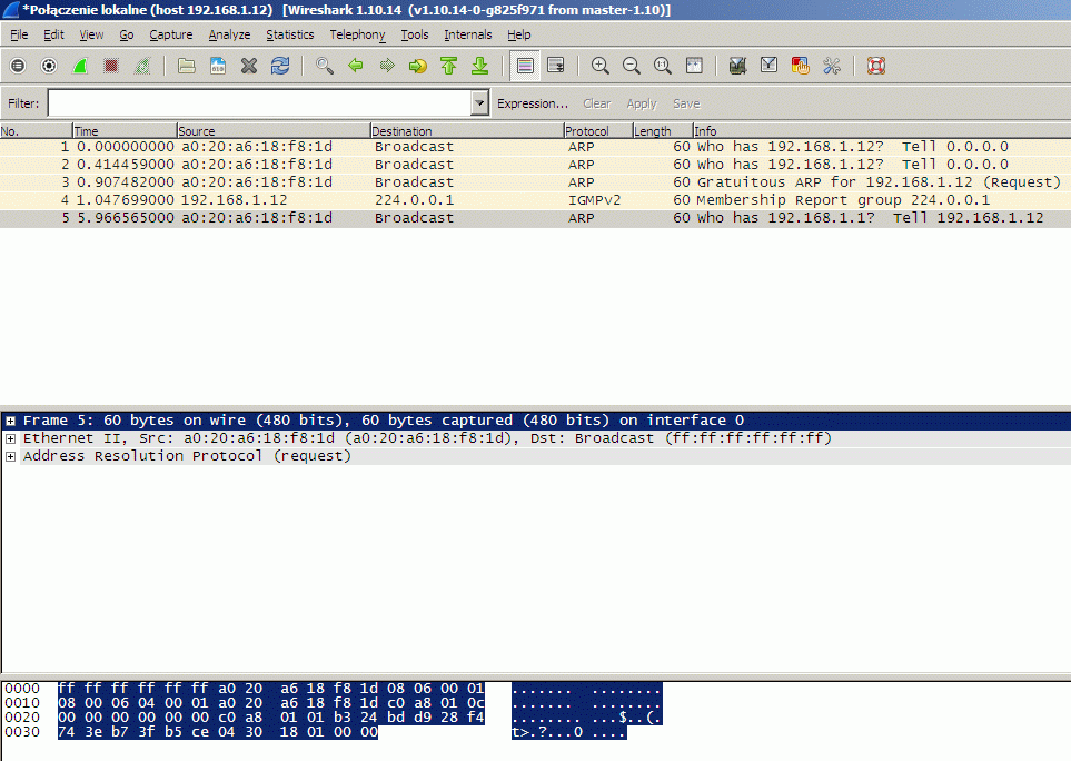

    I have searched for full documentation for the ESP-01 but to no avail. I managed to collect command descriptions, examples but I don't have a full description of AT commands with returned errors.
    Once every few days, querying the NTP server results in an UNLINK error. Nowhere have I found a description of the error, I presume there is no response from NTP. I have selected another server, it responds to pings, error same. I haven't yet fired up Wireshark to see what's going on in the network. I'll have to, then I'll take a look to see if a response is coming in.
    I'm sending the query by address, not name, so the DNS problem is ruled out.
    Other ESP functionality is working (it is a web server).
    Where can I find full documentation of the Chinaman in 'normal' language?

    EDIT .
    My euphoria was premature. I could find nothing about ULINK. The module answers:
    4,CONNECT
    OK
    OK
    Recv 48 bytes
    SEND OK
    UNLINK
    ERROR
    But in Wireshark I have only:
    ESP8266 AT Commands: Where to Find Full Error Code and UNLINK Error Documentation? .
    MAC query when sending the request. The conclusion is that the frame is not coming out of the ESP.
    How about resetting the router?
