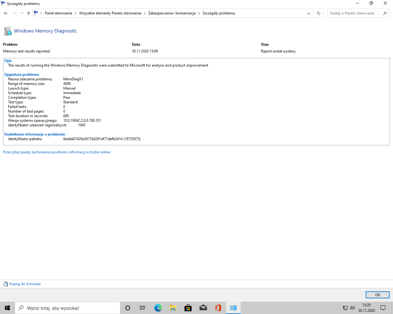

    If I already have the Windows Memory Diagnostics application on my computer, do I have to download memtest86?
  • Memtest and reseating RAM or SATA cables
    #32 19079811
  • #33 19079853
    W0j734
    Posts: 25
    Memory Diagnostics with Windows Memory Diagnostics did not indicate any error. Now I will download memtest86 and check what comes out with the tdgo device

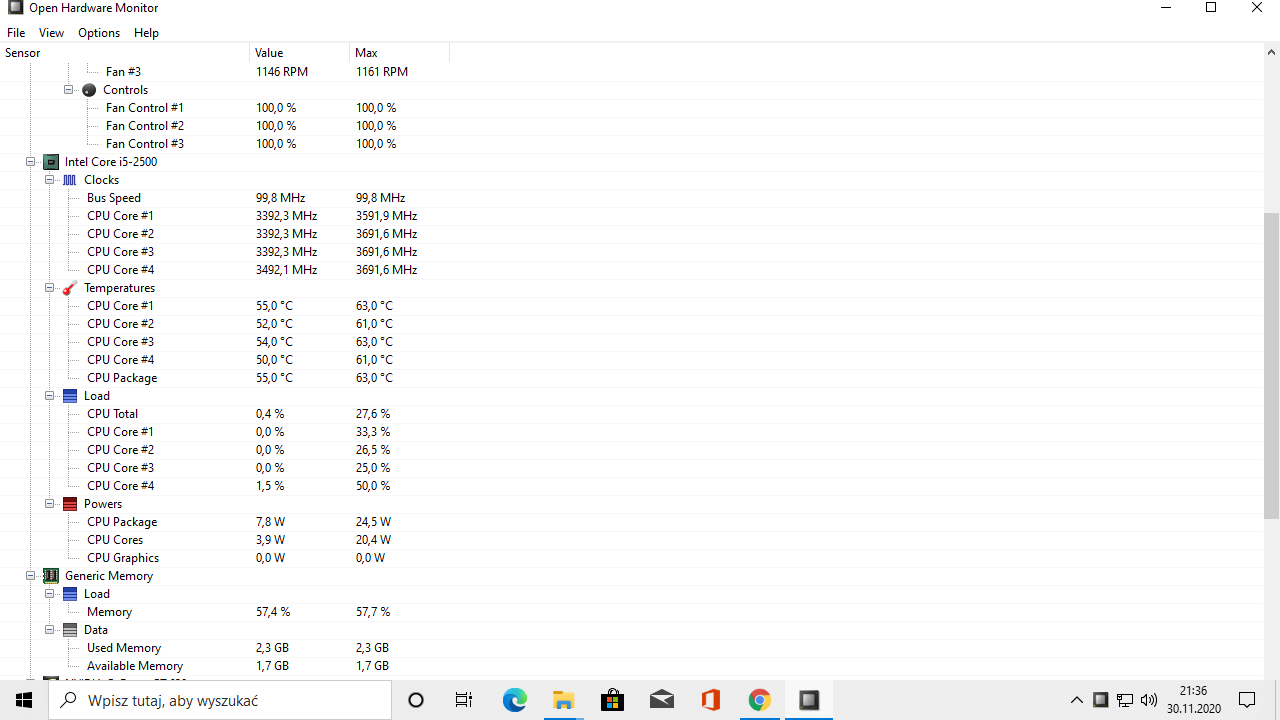

    W0j734
    Posts: 25
    I did 4 tests for 2h and 46min which did not detect any memory error. Continue the test or not?
    Added after 18 [minutes]:
    Now I'm going to turn off the memtest, send you these Tempreatur Snapshots and turn on the memtest for the night again
    Added after 34 [minutes]:
    https://obrazki.elektroda.pl/7131423200_1606768591.png

What temperatures are safe for an Intel i5-2500?
Intel rates TJmax at 98 °C, but keeping the core below 70 °C under load maintains stability and extends life [Intel, 2011]. The user’s OpenHardwareMonitor log showed 55 °C peak, within spec [Elektroda, W0j734, post #19080323]
