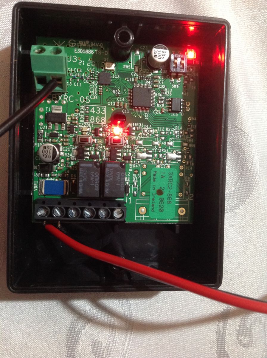

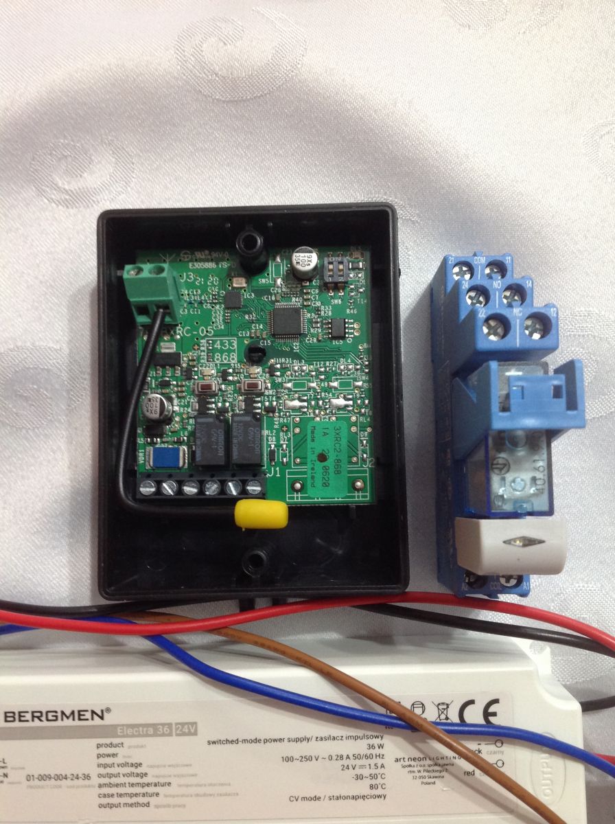

    I already have all the necessary components. How do I truthfully connect the relay with the radio and the lamp?

    I programmed the remote there are 2 channels, the first pulsed the second fixed, there is no voltage on both. Controlling a 200W street lamp with the Faac slh 868 remote control - connecting the Faac xr2 868 c

    And it won't because there are relay contacts and not a voltage output.

    Under which pins to connect the cables from the radio and under which from the 230v lamp? Controlling a 200W street lamp with the Faac slh 868 remote control - connecting the Faac xr2 868 c
