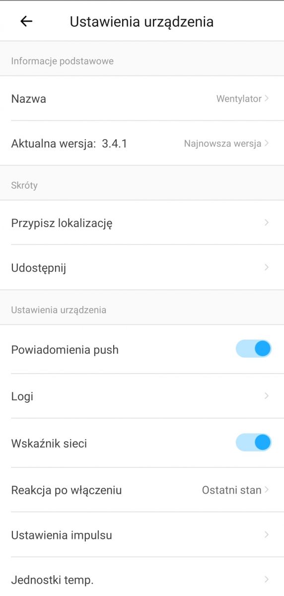

    Hello I am looking for a solution, to an idea. I have a keypad with a bell in the wicket of the property along with an electric door opener from inside the property there is a release button to exit. There is a 12v power supply hanging in the garage for this. I am adding a sanoffi wifi module to the wicket in order to open it via the app and now I am looking for a solution so that when someone rings the doorbell, whichfo the gong is inside the house, they also send me a notification via wifi to my phone, is it possible? And what should I buy and do thanks

    If you connect e.g. a sonoff mini (it doesn't have to control anything) and switch on the control inputs (here it depends what the signal from the bell looks like, maybe via some kind of relay) then you can set up PUSH notifications for this mini.
    The Sonoff mini and the phone must have internet access (it doesn't have to be on the same network or even on the same continent).
    The downside is cloud operation.

    I would use, for example, a potential-free sonoff - you don't have to write software, you have 1 or 2 swiche (there are 1Ch and 2Ch) which you can use - e.g. a drop-in flap and a take-out flap. You also have a NO/NC relay - you can do some signalling.

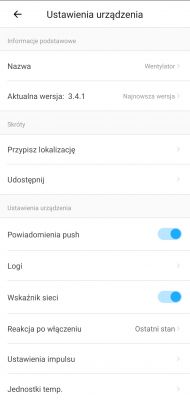

  • #11 19170427
    sk1977
    IT specialist
    Posts: 8047
    Help: 1326
    Rate: 742
    I haven't heard of uploading sonoff softwares to other devices - rather uploading to sonoff :) .
    I don't have a voltage free one to hand, this is a screen shot from th10.
    How do I transmit a notification over Wi-Fi to my phone when someone rings the doorbell? .
