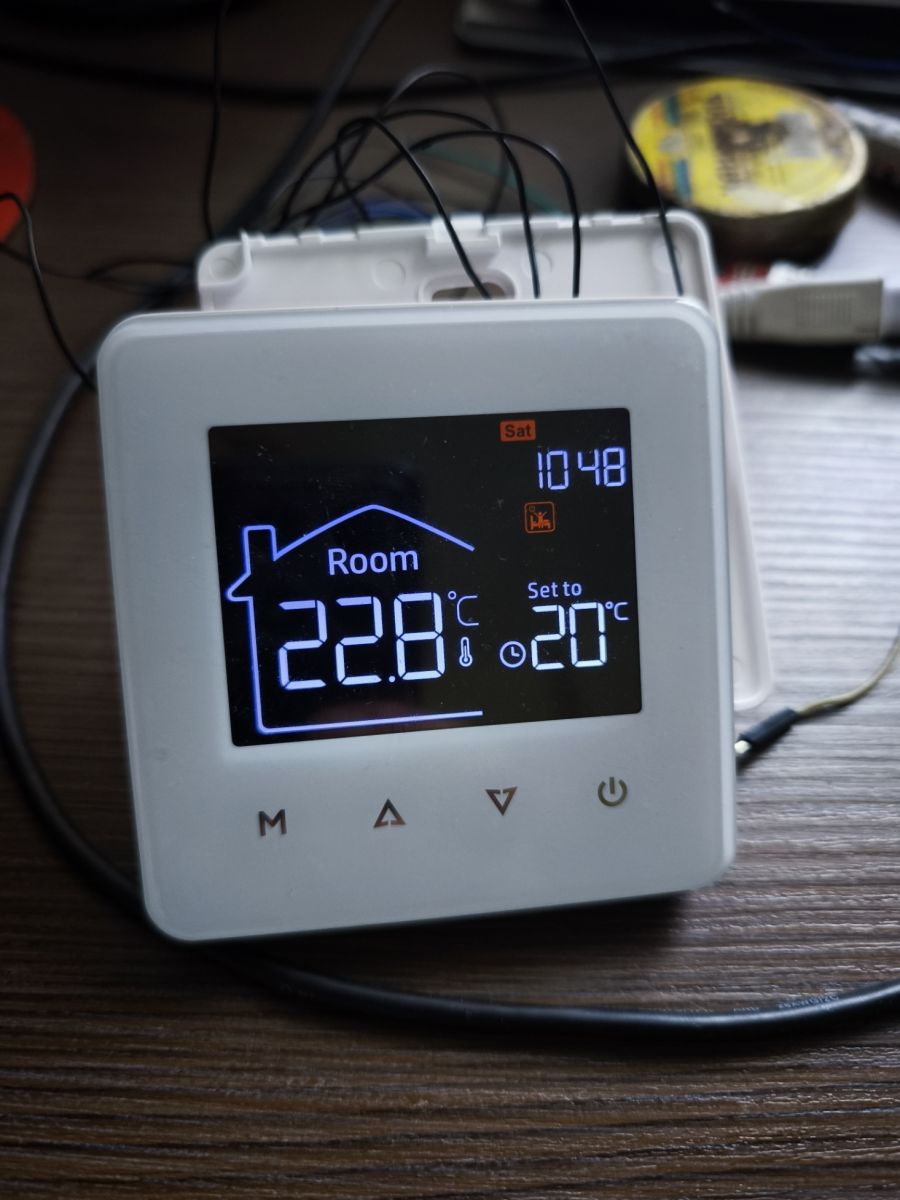

    I have a thermostat device, which is using bk7231N chip:
    Information window with BK7231N chip details, including MAC address and encryption key
    It uses Encryption key: 00000000 00000000 00000000 00000000
    I download firmware, and skip key check.
    But system does not find any OOB, and actually device does not boot after openBK7231N 1.18.157 install. Restoring RF partition does not help. Lost device.

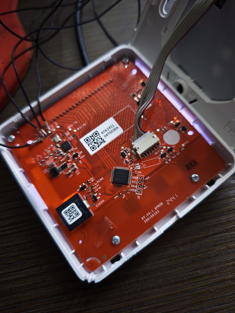

    Hey, can you show a photo of your device?
    Probably this can help: How to flash BK7231M/BL2028N non-Tuya devices with 000000 keys?

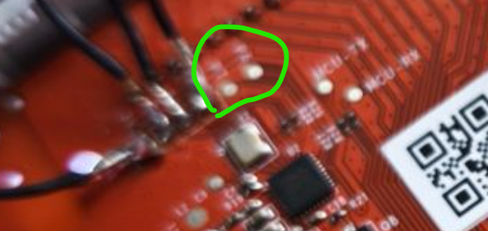

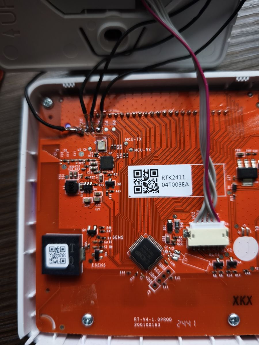

    What are these pads labelled as?
    Close-up of a PCB with four pads circled in green marker

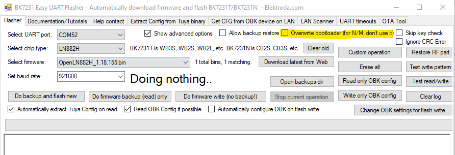

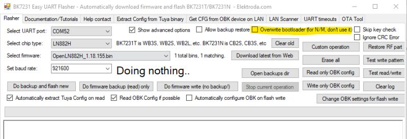

    also, have you tried overwriting bootloader in N/M modes to see if it boots then?
    Screenshot of BK7231 Easy UART Flasher with bootloader overwrite checkbox visible

    Hello, No, I did not try to rewrite bootloader, as it's written, not recommended for N/M devices. but I can try.

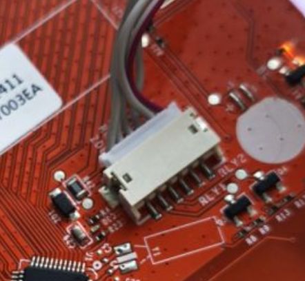

    pinouts are in the picture.
    Close-up of a PCB with labeled MCU-TX and MCU-RX pins and connected cables

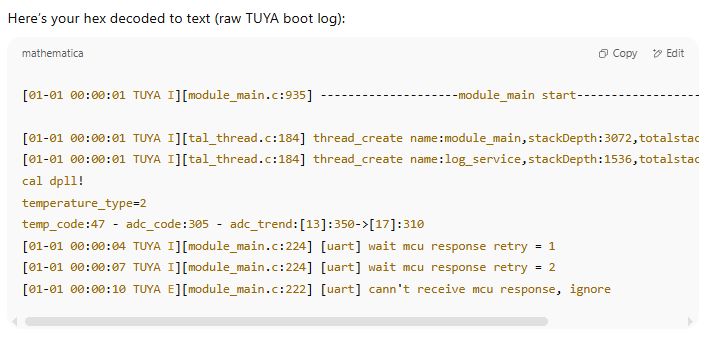

    Which baud is it? Maybe it's using alternate baud. This looks random for me?
  • #17 21643850
    Posts: 5220
    Help: 449
    Rate: 918
    that hex apparently = the ascii seen in previous post. that was 115200
    Screenshot showing decoded TUYA boot log messages displayed as plain text
    at 9600 baud it looks like
  • #18 21643862
    Posts: 14771
    Rate: 12914
    Wait, that's indeed ASCII! So you captured from wrong port - it should be from UART port, and not from log.
    Wait, but you said...
    divadiow wrote:
    here's a little bit more printed from TXD1/P11
    I am confused now. TX2 is log output and TX1 is TuyaMCU comm...

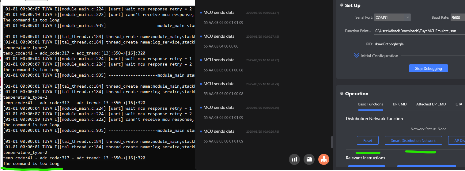

    it does appear to be listening on RX1/P10. If you listen on TX1 and send random TuyaMDA commands to RX1 it will respond with:
    The command is too long error in TuyaMCU emulator with MCU data transmissions visible

    Close-up of connector on red PCB with GND and 3.3V markings
    Can you make a clear photo? Maybe one of the lines is GND and second is 3.3V or 5V... and then you could safely power it, without connecting to mains. Then we could help you with packets capture and write a driver for it for OBK?
