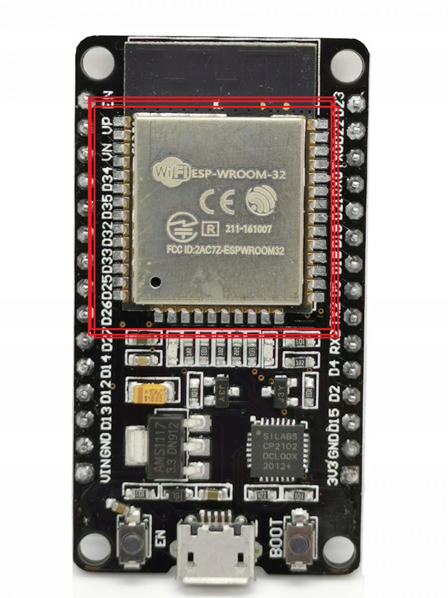

  • #14 19757054
    starob
    Posts: 1088
    Help: 128
    Rate: 137
    Do you have the whole board,Connecting Xiaomi Aqara Door Sensor to ESP Wroom: Software Recommendations? or just the one in red?
  • #16 19757101
    starob
    Posts: 1088
    Help: 128
    Rate: 137
    Michal8883 wrote:
    I'm looking for something like this https://czh-labs.com/products/.... hRCh2izgfuEAQYCCABEgIEd D BwE
    This one would also be suitable, it would just be enough to rename the names on the terminal blocks.
    There is nothing else there but a pin-screw connection;
    I have not seen anything else like it
