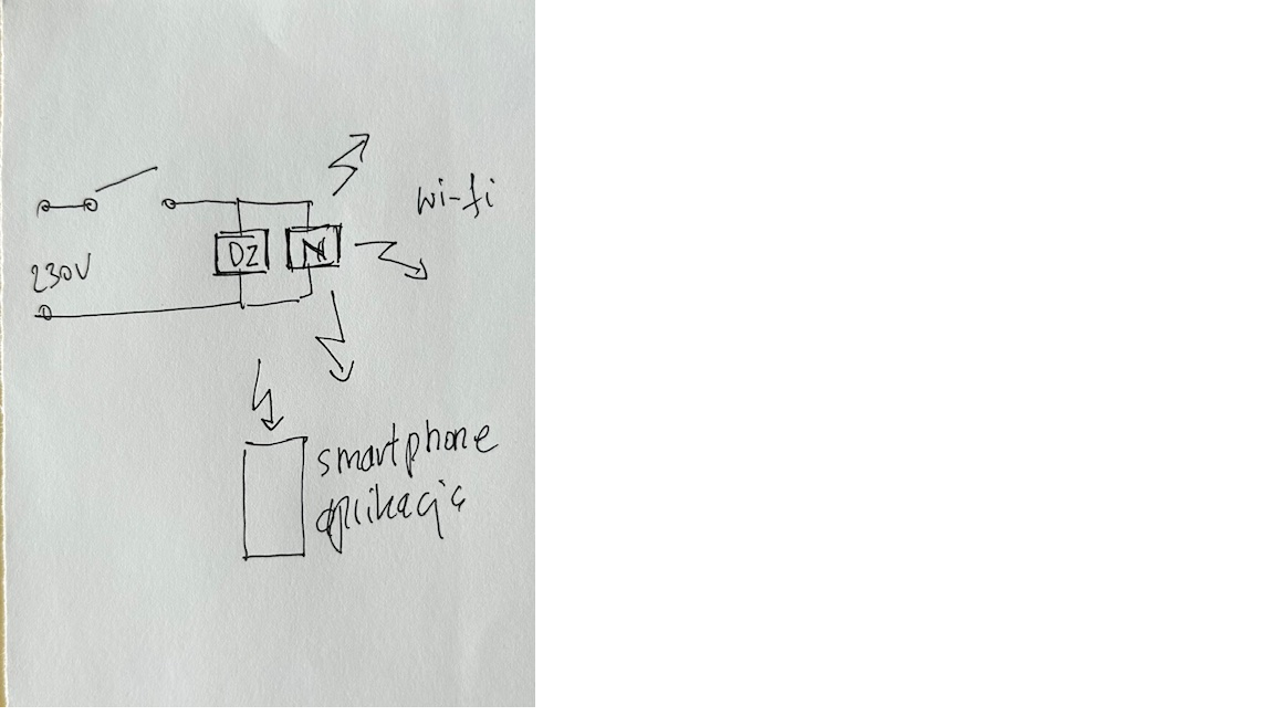

    Good day, please help - I need a "smart" transmitter which via Wi-Fi connects to the network at home and sends me a signal to my phone
    of course on the Wi-Fi network at home e.g. when someone rings the doorbell (attachment), the doorbell is on the ground floor and I work on the 2nd floor and I can't hear if someone is ringing, the doorbell is an old Zamel 230V, I don't want to change this ringing arrangement, I looked for Tuya, Tapo, Xiaomi but in my opinion nothing of such products
    Thank you Marek
    • What smart Wi-Fi transmitter for old Zamel 230V bell? Looking for Tuya, Tapo, Xiaomi smart connections_ door bell_smartphone.png (330.39 KB) You must be logged in to download this attachment.

    It will not work this way. It would be too short powered for the wifi device to connect and send a message.
