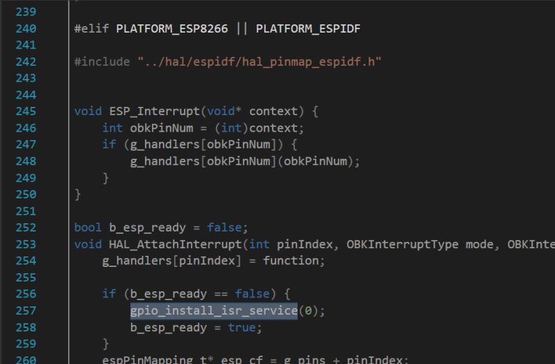

    ESP8266 1768_merge_a8731bd804dc
    seen at boot with Counter_f configured GPIO4
    then grounding IO4 =
  • #4 21640606
    Posts: 14771
    Rate: 12914
    Well, this indeed is called in previos bl0937 code:
    #elif PLATFORM_ESPIDF || PLATFORM_ESP8266
       esp_cf = g_pins + GPIO_HLW_CF;
       esp_cf1 = g_pins + GPIO_HLW_CF1;
       gpio_install_isr_service(0);
    Wait, but I do call it for ESP?
    Screenshot of code editor showing interrupt handler logic for ESP8266/ESP-IDF

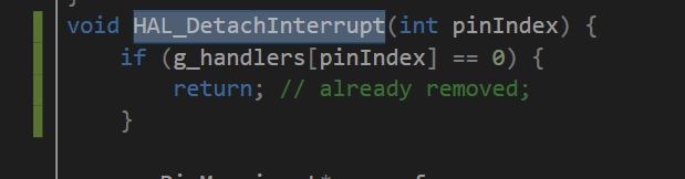

    Posts: 14771
    Rate: 12914
    ah maybe it tries to remove twice, I pushed a guard:
    Screenshot of HAL_DetachInterrupt function with pointer check condition
    Probably HAL_DetachInterrupt gets called from PIN_SetPinRoleForPinIndex even when it was not attached earlier

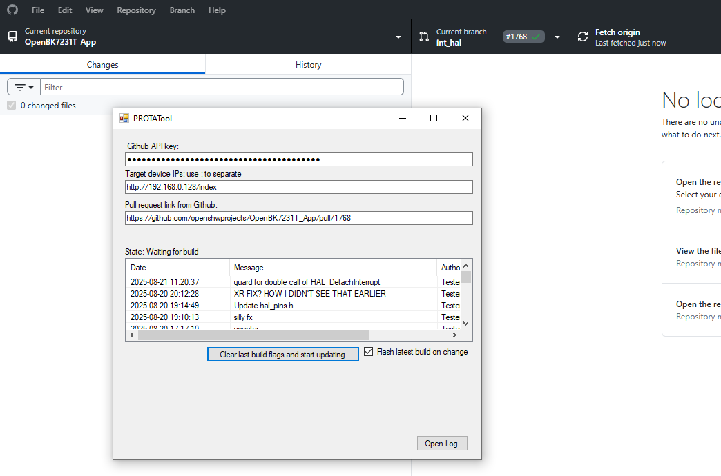

    I have ESP32 set up and I will try to fix on ESP32 for now. Or rather... one crash fix will be applied
    Added after 5 [minutes]:

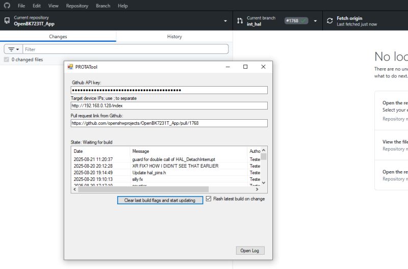

    Strange, I didn't push previous crash fix as well. Ok, both will compile soon. My PROTA is waiting:
    PROTATool window showing commit history and GitHub pull request input

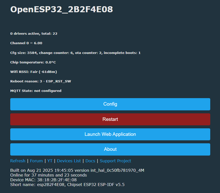

    Ok, ESP32 works for me:
    OpenESP32 web interface with system status and control buttons

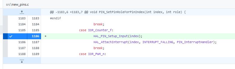

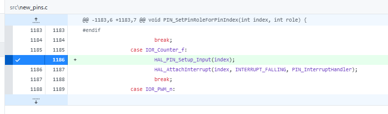

    Let's try this way:
    Code fragment in new_pins.c shows added HAL_PIN_Setup_Input line
    It's discussable whether we should rely on another HAL or just put pin setup into HAL_AttachInterrupt. Futhermore, it brings pull up/down options...

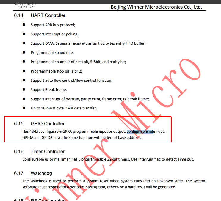

    Posts: 14771
    Rate: 12914
    Was BL0937 working on W600? I think it was?
    Excerpt from W600 documentation showing GPIO controller with interrupt support.
    They have interrupts:
    https://github.com/winnermicro/micropython/bl...05fbca6/ports/w60x/machine/machine_pin.c#L252
    Code: C / C++
    Well I guess I am missing tls_clr_gpio_irq_status , but it does not explain the crash on config and silence on w800

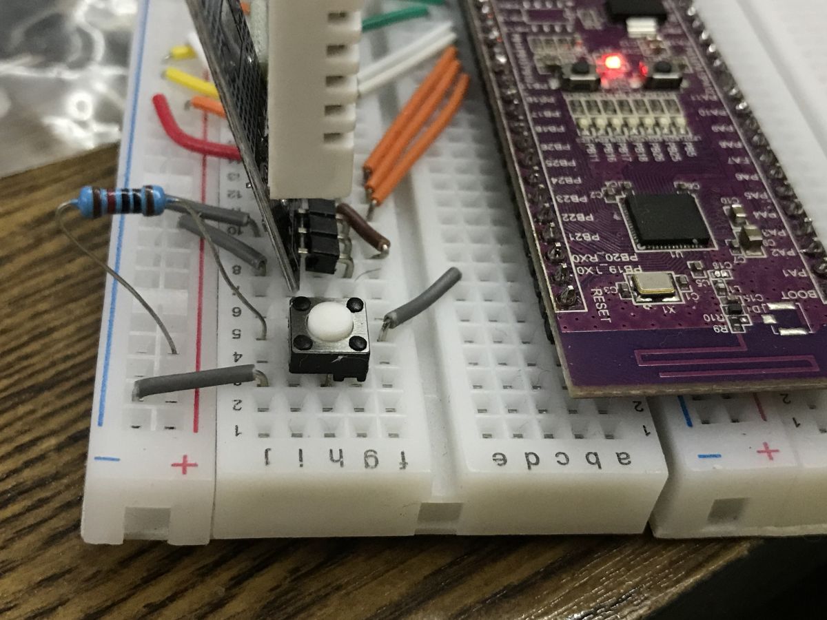

    Added after 1 [hours] 23 [minutes]:

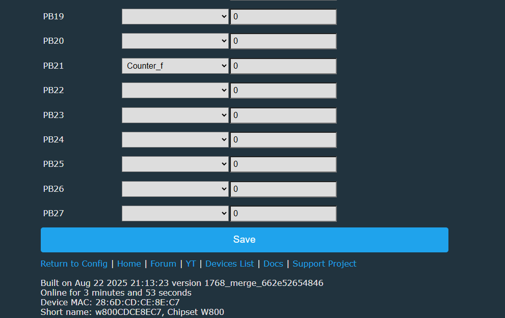

    W800, PB21, with a button to a ground. When button is not pressed, it increases steadily, if pressed, it stops.
    Configuration UI showing GPIO pins PB19–PB27 with Counter_f assigned to PB21
    Added after 3 [minutes]:
    Added pull up resistor 10k to VDD - seems to work better, only change on press? Almost always, sometimes not.
    Breadboard with microcontroller, pushbutton, and 10k pull-up resistor connected to VDD
    Added after 4 [minutes]:
    Ah, this is because I am calling HAL_PIN_Setup_Input for Counter_f .... so... so with no pullup/pulldown, there is noise on pin, that's why it changes so fast... it's to be expected, to be honest. Now the question is what should be the default? Input pullup? Pulldown? No resistor?
    Added after 6 [minutes]:
    I am not sure, but I changed default to input pullup so it works better without any resistor on gpio... otherwise you manually have to add pullup or pulldown...
