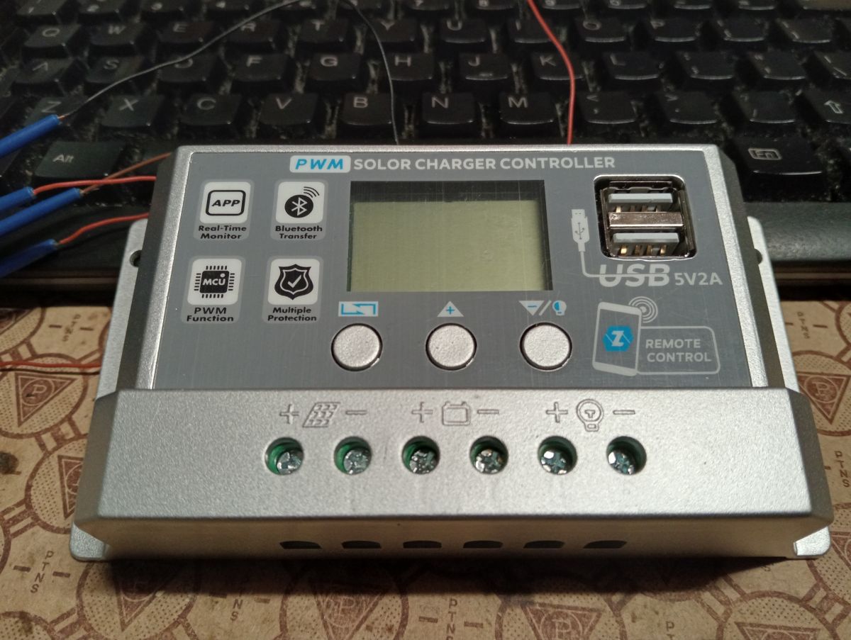

    I'm trying to reflash a WiFi module of a solar charging controller with an open source firmware.
    PWM solar charge controller with LCD screen and dual USB ports on desk Close-up of a BL-SM214R board with attached wires and USB-A socket Close-up of a PCB with tactile buttons, SMD components, and dual USB Type-A port RuiBlue AH_BL8BW005 WiFi module with attached wires ESP32-C2 Wi-Fi module on blue PCB with visible capacitors and SMD components
    Esptool reports:
    Flashing the module with:
    Code: Bash
    succeeds, but then the device (still powered only from my USB-serial adapter) doesn't boot, only reboots spontaneously, e.g.:
    I think it also doesn't boot when powered from a car battery since its AP doesn't appear.
    I've also tried tasmota and esphome, with similar results. Reflashed back with original firmware, the device works correctly.
    Any ideas on what I'm doing wrong?

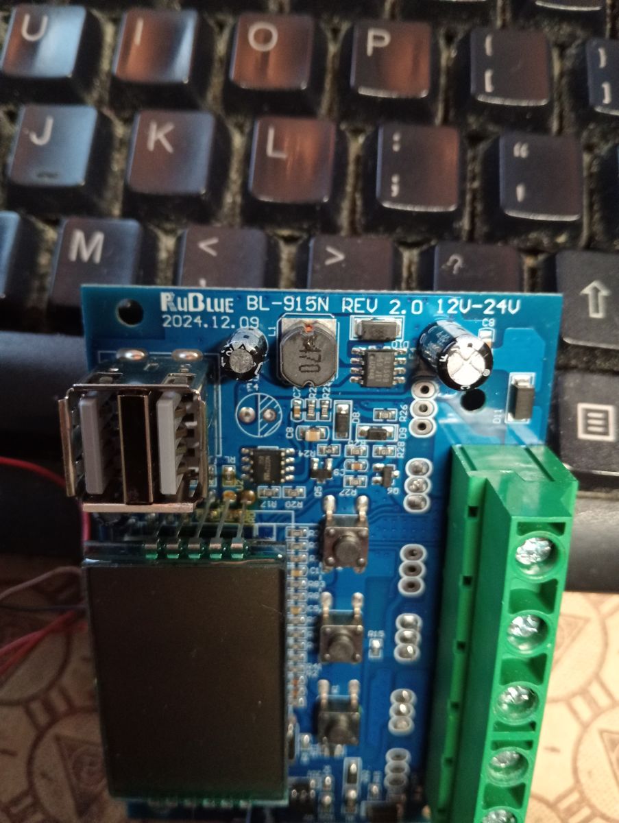

    AI: Could you provide the exact brand and model of the WiFi module and the solar charging controller it's from? This will help determine if there are any known compatibility issues or special requirements for your hardware.
    BL-915N REV 2.0 module with USB port and screw terminal against keyboard background
    https://aliexpress.com/item/1005008843512568.html

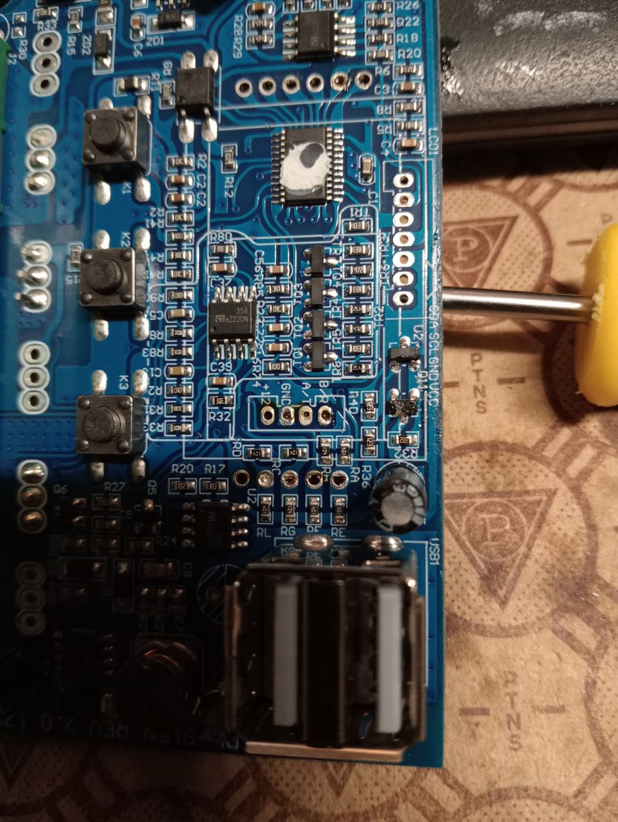

    But i see that you have only UART wired out on the module.
    So there is probably some custom UART protocol - you would need to sniff it manually with original firmware.

    Yes, only UART. My plan is to verify if Modbus protocol is in use.

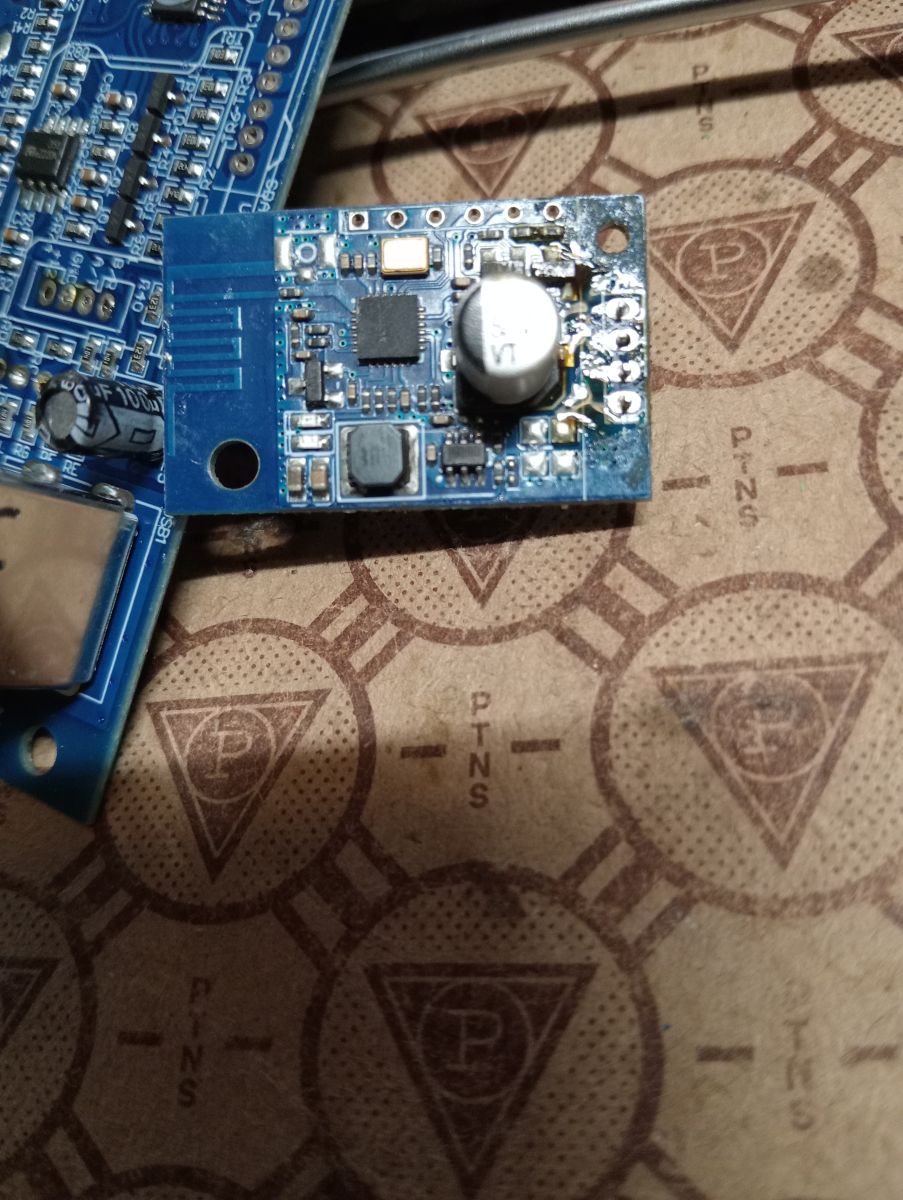

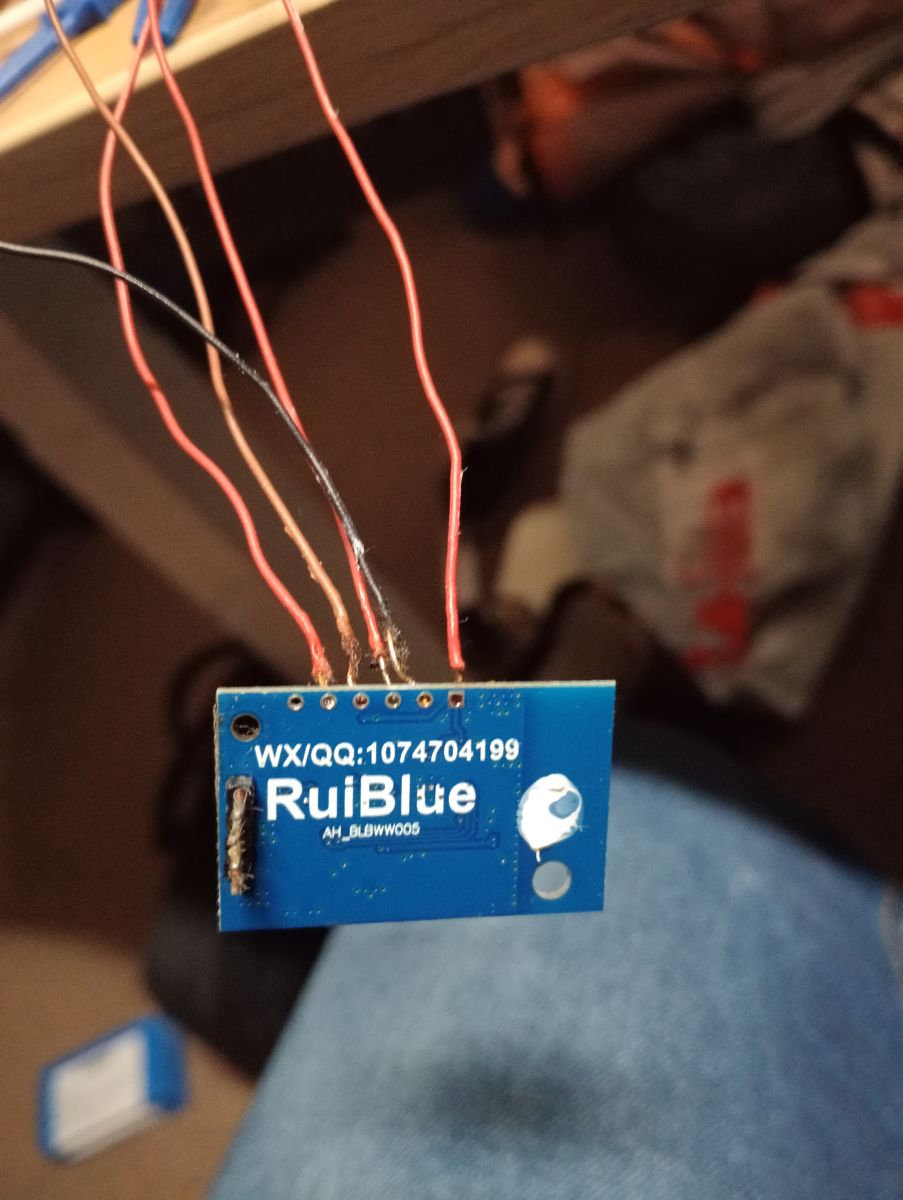

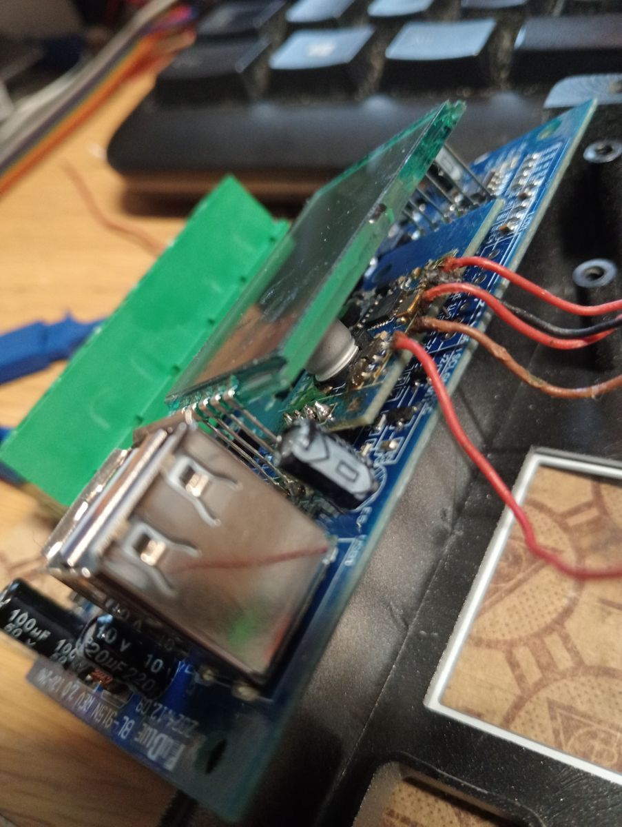

    OK, I received my new USB-serial adapter so I can continue with my attempts.
    First I tried the proposed ESPHome configuration tweaks but that didn't help.  It looks like if 2nd stage boot loader didn't work.  I'm wondering if maybe there is something wrong with partition layout.
    Then I successfully re-flashed the device with original firmware.  Here is a boot log:
    The last three lines are then repeated continuously.  Those look to me like Modbus messages.
    There is no response from the solar charger because only the WiFi module is powered up from the USB-serial adapter regulator.  There is also no WiFi connection established, probably because of the missing response.  Tomorrow I'm going to connect the device to a car battery and try to capture Modbus responses from the charger, hopefully reported to the serial console.  Then I'll clean up my WiFi credentials and dump the firmware for sharing.

    I think I've identified some registers. The range starting at register offset 0x1 seems to provides live values, while the other one starting at register offset 0x1001 is where settings are stored.
    Live values at offset 0x1:
    Settings at offset 0x1001:

    I've managed to boot ESPHome on my ESP32-C2 module with factory installed 2nd stage bootloader. I installed my ESPHome .ota.bin image with esptool at flash address 0x10000. My ESPHome .factory.bin image was just missing the 2nd stage bootloader code, replaced with all ones (0xff). That's an issue with ESP32-C2 support in the current ESPHome, I believe (I tried 2025.8.1 and 2025.8.2). Then, I'm not able to use OTA for firmware updates for now, but anyway, I can continue with exploring the device.  BTW, thank you @insmod for sharing your ESPHome configuration hints, those occurred quite helpful.  Here is the boot log.
    EDIT:
    OTA is possible, for it to work one needs to locate a partitions.bin file for the device in the esphome runtime file tree and upload it to the flash over serial with esptool at offset 0x8000.
    I also tried a similar trick with OBK .img but that didn't work. However, boot log looked different than when OBK .factory.bin was installed, maybe it can shed more light on why boot fails. Here is a copy:
    For completeness of the record, I've also tried booting ESPHome with OBK 2nd stage bootloader, and that does't work either.

    ESPHome configuration of Modbus UART:
    Code: YAML
    Other than that, there are two LEDs, rather not visible from outside of the device enclosure.
    Code: YAML
