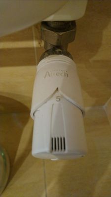

    I have a Brugman VK-Universal 21s 600/400 radiator in the room at 529W with a Schlosser head (probably a Diamant DZ model), and a D412/1150mm radiator in the bathroom at 478W with an Altech head. I intend to purchase so-called smart thermostatic heads and have become interested in such Netatmo NVP-EN .
    I have determined that the heads on my radiators are probably these:
    1) Schlosser Diamant DZ with RA-N thread M23.5x1.5 and here where it is also marked M23x1.5
    2) Altech with M30x1.5 thread.
    I am attaching pictures of my radiators and heads.
    Will these fit together?
    On the website of smart head manufacturer Netatmo I found this thread compatibility chart .
