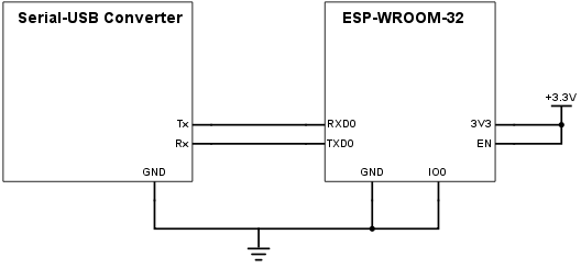

You can dump an ESP32-WROOM-32D over UART with a regular 3.3 V USB-UART adapter and esptool. [#19257510] Connect RX/TX at 3.3 V logic, keep GND common, tie EN to 3V3, and pull GPIO0 to GND while the chip boots to enter programming mode; if you power the device from elsewhere, still keep the grounds connected. [#19257659] [#19260159] A baud rate of 115200 is acceptable, although the thread notes that 512 kbps is also safe depending on the adapter. [#19257659] For a 4 MB flash, `read_flash 0 0x400000 ...` is the correct range, and for larger flash sizes esptool should still work or you can read the chip in 2 MB/4 MB chunks using the appropriate start addresses. [#19258465] [#19261208] If you split the dump, keep the parts separate at first because a simple concatenation may fail due to checksums. [#19262861]

    Welcome,
    I'm new to the subject so I'm very much asking for your understanding and help.
    I need to rip firmware from an IoT device that uses the ESP32-WROOM-32D module. I am very much asking for advice on how to bite this. I've taken the device apart and verified that I can plug into the pinouts: (2) 3V3, (34) RXD0, (35) TXD0, (3) EN, (25) IO0, (38) GND.
    What is the best tool to use? Will a simple UART converter do the job?
    Warm regards

    gigiraffa
    Level 4  
    Posts: 8
    Ok, thank you.
    Is there anything I should watch out for when linking?
    What baud rates does this module operate on? Or how can this be easily calculated?
    Best regards

    gigiraffa
    Level 4  
    Posts: 8
    Extra, thanks!
    One more question - could you please advise how to find which addressing to use in the read_flash command to read the firmware? Would it be read_flash 0 0x400000 for 4MB flash or should I limit the range somehow? Additionally, how do I check the COM port?

    gigiraffa
    Level 4  
    Posts: 8
    Thank you!!!
    And one more question regarding the earlier connection diagram. What if I would like to have the power source from the wall and not from the UART dongle? Do I still need to connect the EN somewhere?
    Additionally, I came across a tutorial that talks about pressing a button on the dev board to enter programming mode. Do I need to override this somehow without having a programming board? Is connecting IO0 enough to boot into programming mode?
    Thank you very much for your help and understanding!

    gigiraffa
    Level 4  
    Posts: 8
    Super! Thank you again!
    One last (I hope) question: I connected to the device and found out from the esptool flash_id that the flash is 16MB. I used esptool first as a test to read the first 2MB from read_flash and everything worked nicely. Now I have tried to read the whole 16MG but it crashes at 72% and goes no further. Could this be because the range that can be read is smaller than 16MB? What is the best way to check the correct addressing to read_flash?

    gigiraffa
    Level 4  
    Posts: 8
    With speed do you mean baud rate? I set 115200 - checking the port screen this baud rate gave me reasonable output, others I tried gave garbage. Is this a reasonable baud rate for read_flash? Maybe use some other one better?
    Additionally, as I mentioned - it crashed at 72%, and 72% of 1600000 is 1152000 which is a total of ten times the baud rate set. Is this somehow related to each other?
    As for the device - it's a hub that connects other iot devices so maybe that's why the larger (custom) flash?

    gigiraffa
    Level 4  
    Posts: 8
    sudo esptool -p /dev/ttyUSB0 -b 115200 read_flash 0 0x1600000 flash.bin - did I mess something up here?
    I am now trying to read in chunks. What is the best way to then combine them for analysis in Ghidra?

    gigiraffa
    Level 4  
    Posts: 8
    yes yes, I just grasped that too! but I think it was 6 zeros and not 5 as you stated?
    Added after 55 [seconds]: .
    Speaking of merging, a simple merge will be ok?
