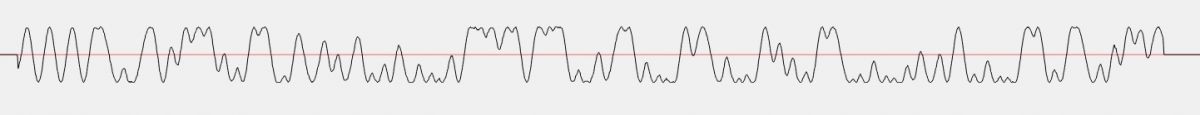

    I'm sitting around trying to figure out the communication with the ISTA water meter.
    Unfortunately I'm stuck.
    Every 42 seconds the water meter transmits something like this:
    How to decode the communication from ISTA? The water meter sends such a packet every 42 seconds. .
    Maybe someone can associate what this modulation and possibly coding is.

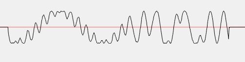

    After transmitting "this something" there is a pause of 17.26 ms and flies :
    This is clear:
    GFSK, 76kbit, 20khz deviation etc....
    We have:
    preamble(4), sync (2), date (1).
    This agrees with what we were able to extract from the CC1101 (from the registers).
    I just don't know what kind of crap is flying in front of it.
    This decoded packet is the same all the time. .
    edit . However, no. This 'data' byte changes from time to time. Each water meter in the range transmits a different value.
    I suspect this is information about the end of the communication window.
    The question is how to decode this 'something' from the beginning.
    Maybe someone / something ....
    Nothing ?
