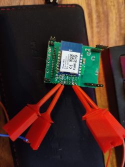

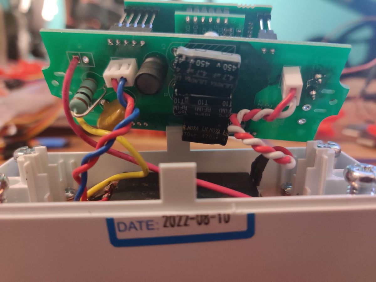

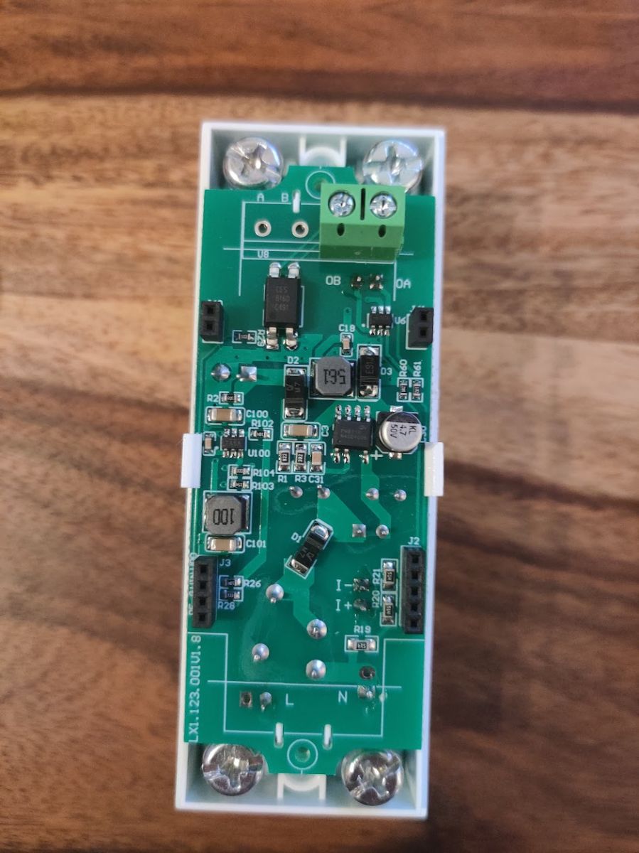

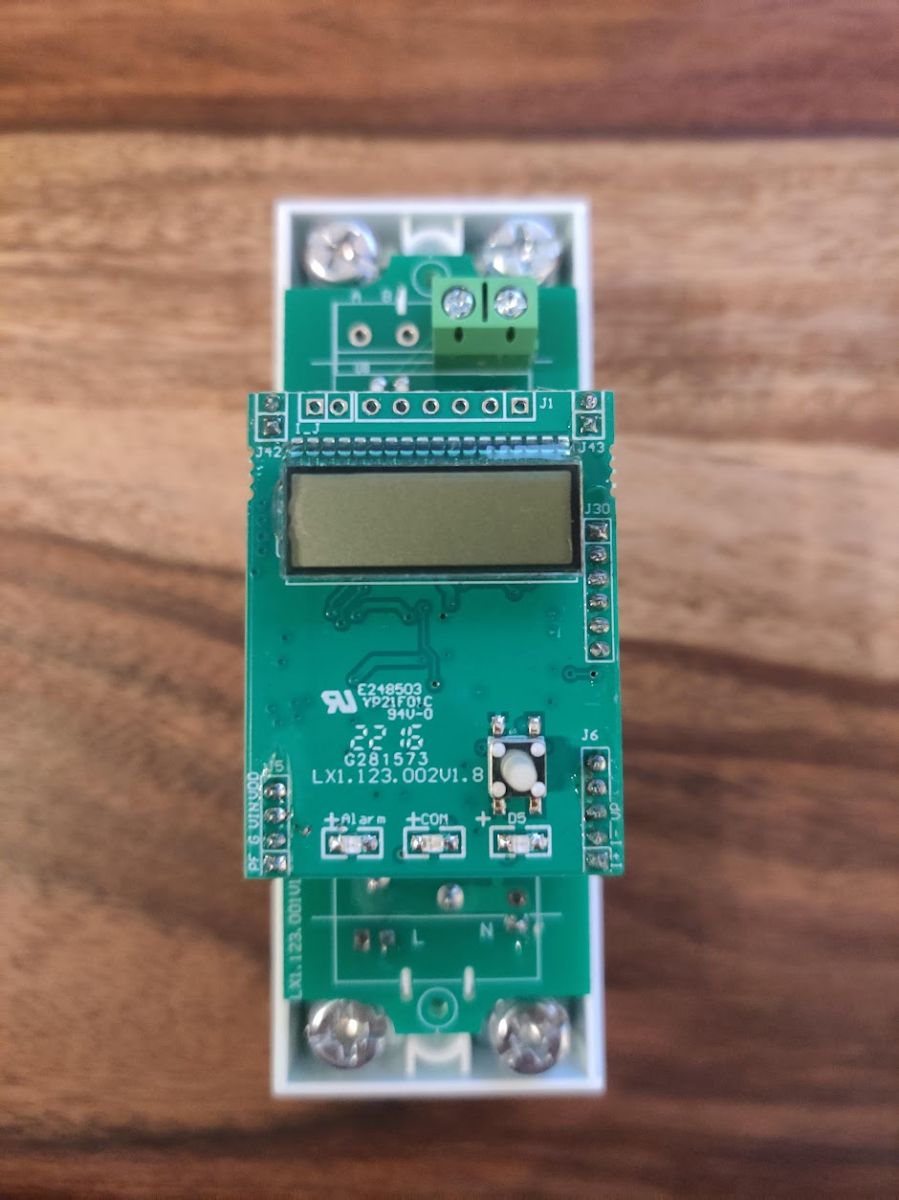

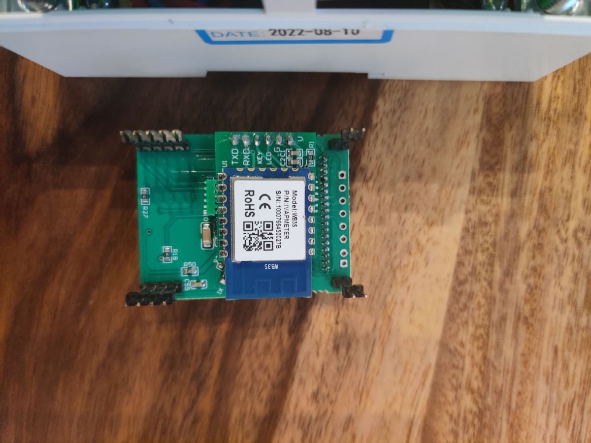

    I just received this smart meter and it seems it no longer uses the ESP8266.
    I found the OpenBK7231T (WB3S) project, and successfully flashed the device, but I'm not really sure how to configure the device from here.
    I was originally planning on using this guide for Tasmota: https://github.com/krikk/Hiking-DDS238-2-WIFI-Din-Rail-Energy-Meter-flashing-Tasmota
    I've attached the original BIN dump.
    Here's some photos from the teardown and flash.

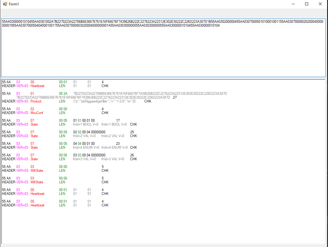

    Hello, it looks like a TuyaMCU device and the guide from Github confirms it. Have you tried to configure the TuyaMCU? There are some examples for that, for example:
    https://www.elektroda.com/rtvforum/topic3895301.html
    https://www.elektroda.com/rtvforum/topic3898502.html#20253434
    They are for different kinds of devices, but in general the TuyaMCU protocol is the same in all cases.
    Do you know the dpIDs of, for example, relay function?
    We can try to configure it together, for a start, let's get relay working.

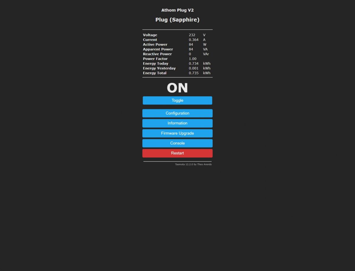

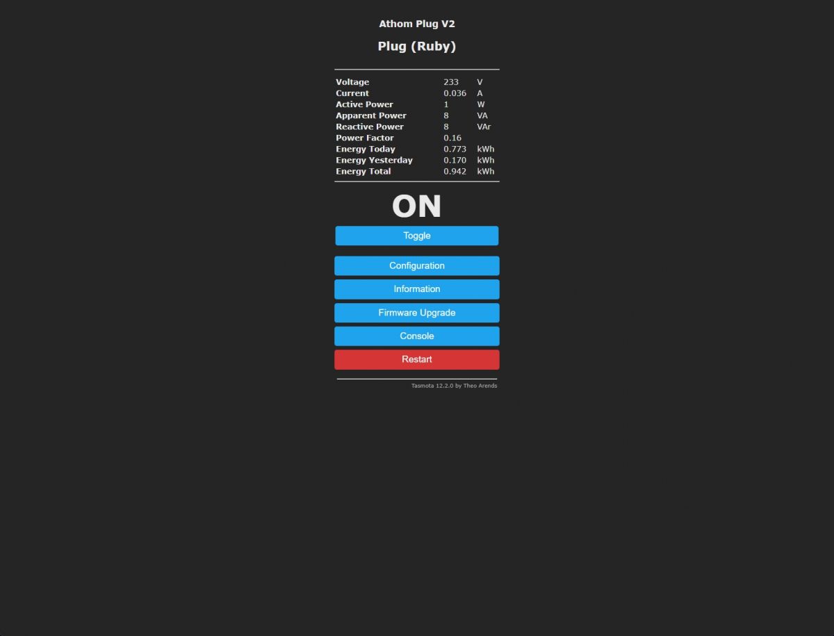

    I think there are some of the dpIds in the Tasmota guide, as it mentions:
    Tasmota Config for TuyaMCU to paste into Console:
    Backlog TuyaMCU 33,20; TuyaMCU 32,18; TuyaMCU 31,19; TuyaMCU 37,101;
    dpId=9 seems to be a timer to toggle the device relay, set it to any value and it starts counting down, by the time it reaches 0 the relay toggles state. As far as I know, this can't be used in Tasmota
    Where the command `TuyaMCU {fnId},{dpId}` is as outlined here.
    So based on what you mentioned, the relay seems to be dpId 9.
    The others (above) seem to relate to:
    dpId 20 = voltage power monitor (V)
    dpId 18 = current power monitor (A)
    dpId 19 = active power monitor (W)
    dpId 101 = not sure as the fnId of 37 is not listed here

    So let's try to get this running together. I don't have much time and I don't know this device, so we will do it step by step, carefully.
    Not really, it seems that it's a timer to turn off relay. Timer turns off relay after some time. It's not like a direct access to relay. But let's try that.
    dpId=9 seem to be a timer to toggle the device relay, set it to any value and it starts counting down, by the time it reaches 0 the relay toggles state. As far as I know, this can't be used in Tasmota
    OpenBK7231T (WB3S) Config for Hiking DDS238-2 Smart Meter: Tasmota Guide & Teardown
    Ok 31, 32 and 33 are POWER, but what is 37 in Tasmota?
    Docs does not specify that.
    https://tasmota.github.io/docs/TuyaMCU/#tuyasend-command
    Is 37 for direct access to relay (NOT a timer?)
    This is an autoexec.bat that you shall drag on file system on LFS.
    NOTE: you can just also type those 3 commands in console, but then they will NOT be remembered corrrectly.

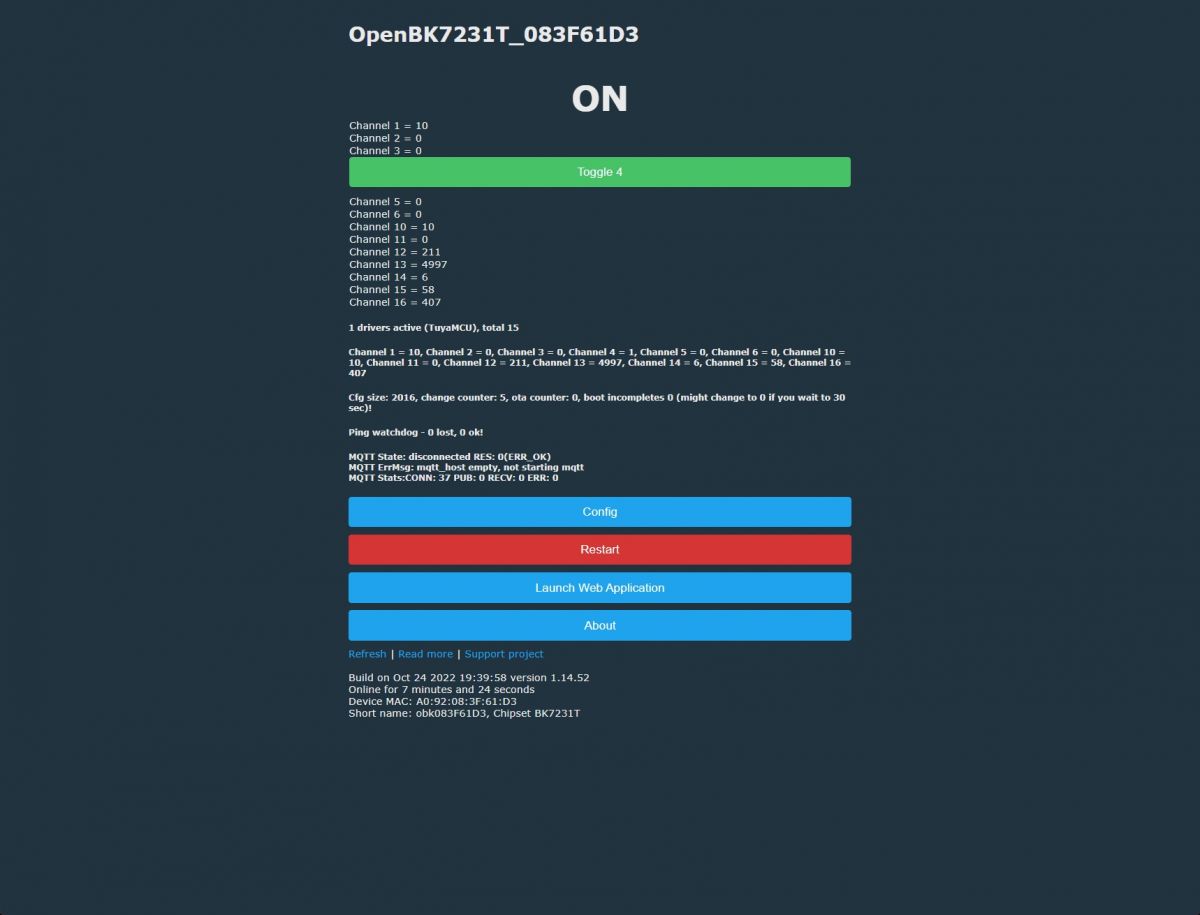

    Unfortunately no luck. I even tried dpId 1 and 4 (some others mentioned in the Tasmota official docs for switches and relays).
    (see below for update)
    1 & 2: Both fields displayed and were clickable
    3: No response on the device on click
    4 & 5: No response on the device after changing the values
    Also, I had to use `setChannel ...` instead of `setChannelType ...` as it seems to have changed in your docs and `setChannelType` gave a "command not found" error.
    EDIT: OK, I see that `setChannelType` works in the webapp console but not in the standard config console (outside the webapp). However, it does not change the outcome.

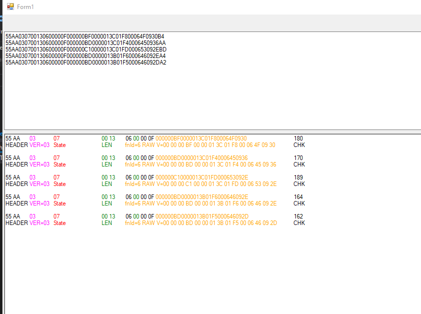

    I checked the logs and found the following dpId outputs:
    1:
    Info:TuyaMCU:TUYAMCU received: 55 AA 03 07 00 08 01 02 00 04 00 00 00 04 1C
    Info:TuyaMCU:TuyaMCU_ProcessIncoming[ver=3]: processing command 7 (State) with 15 bytes
    Info:TuyaMCU:TuyaMCU_ParseStateMessage: processing dpId 1, dataType 2-DP_TYPE_VALUE and 4 data bytes
    Info:TuyaMCU:TuyaMCU_ParseStateMessage: raw data 4 int: 4
    6:
    Info:TuyaMCU:TUYAMCU received: 55 AA 03 07 00 13 06 00 00 0F 00 00 00 0C 00 00 00 10 01 C3 00 00 77 09 1C AD
    Info:TuyaMCU:TuyaMCU_ProcessIncoming[ver=3]: processing command 7 (State) with 26 bytes
    Info:TuyaMCU:TuyaMCU_ParseStateMessage: processing dpId 6, dataType 0-DP_TYPE_RAW and 15 data bytes
    9:
    Info:TuyaMCU:TUYAMCU received: 55 AA 03 07 00 05 09 05 00 01 00 1D
    Info:TuyaMCU:TuyaMCU_ProcessIncoming[ver=3]: processing command 7 (State) with 12 bytes
    Info:TuyaMCU:TuyaMCU_ParseStateMessage: processing dpId 9, dataType 5-DP_TYPE_BITMAP and 1 data bytes
    Info:TuyaMCU:TuyaMCU_ParseStateMessage: raw data 1 byte:
    16:
    Info:TuyaMCU:TUYAMCU received: 55 AA 03 07 00 05 10 01 00 01 01 21
    Info:TuyaMCU:TuyaMCU_ParseStateMessage: processing dpId 16, dataType 1-DP_TYPE_BOOL and 1 data bytes
    17:
    Info:TuyaMCU:TUYAMCU received: 55 AA 03 07 00 22 11 00 00 1E 00 00 00 00 00 00 00 00 00 00 00 64 00 01 0E 00 00 AA 00 00 00 00 00 0A 00 00 00 00 00 00 81
    Info:TuyaMCU:TuyaMCU_ProcessIncoming[ver=3]: processing command 7 (State) with 41 bytes
    Info:TuyaMCU:TuyaMCU_ParseStateMessage: processing dpId 17, dataType 0-DP_TYPE_RAW and 30 data bytes
    18:
    Info:TuyaMCU:TUYAMCU received: 55 AA 03 07 00 15 12 00 00 11 00 05 00 64 00 05 00 1E 00 3C 00 00 00 00 00 00 00 09
    Info:TuyaMCU:TuyaMCU_ProcessIncoming[ver=3]: processing command 7 (State) with 28 bytes
    Info:TuyaMCU:TuyaMCU_ParseStateMessage: processing dpId 18, dataType 0-DP_TYPE_RAW and 17 data bytes
    101:
    Info:TuyaMCU:TUYAMCU received: 55 AA 03 07 00 08 65 02 00 04 00 00 00 04 80
    Info:TuyaMCU:TuyaMCU_ParseStateMessage: processing dpId 101, dataType 2-DP_TYPE_VALUE and 4 data bytes

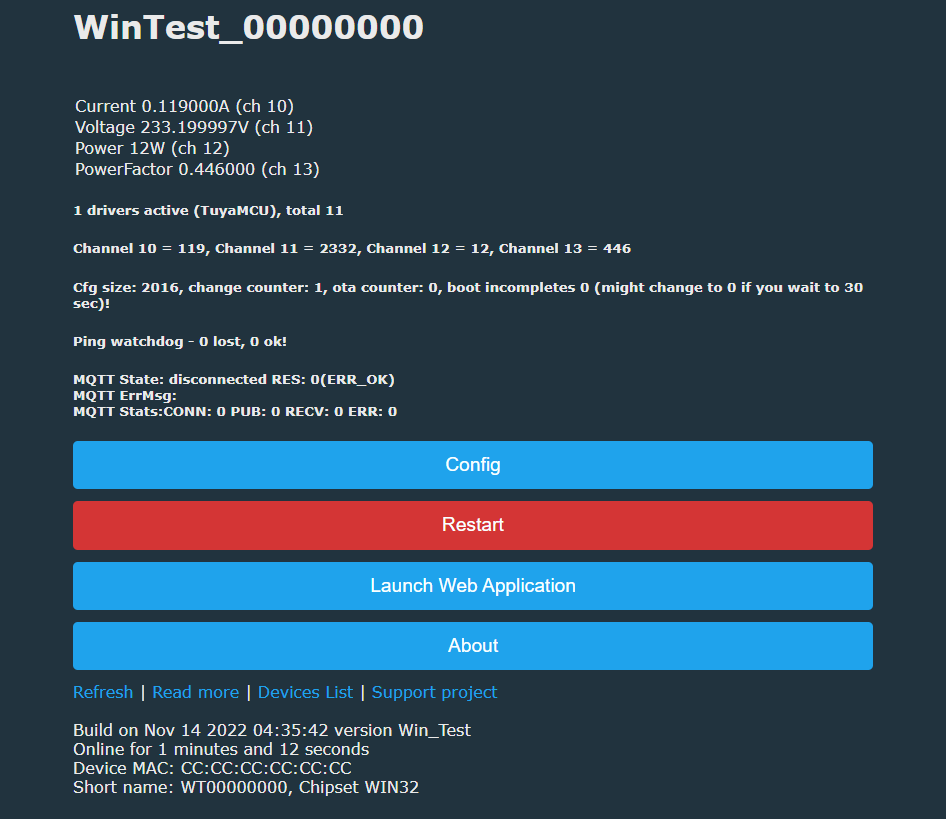

    Added after 10 [minutes]:
    The display still works (separate chip??) but the values seem to match to my current load as:
    103 = Active Power (W)
    105 = Frequency (mHz)
    110 = Reactive Power (VAr)
    111 = Power Factor (PF)
    (will update as I go)

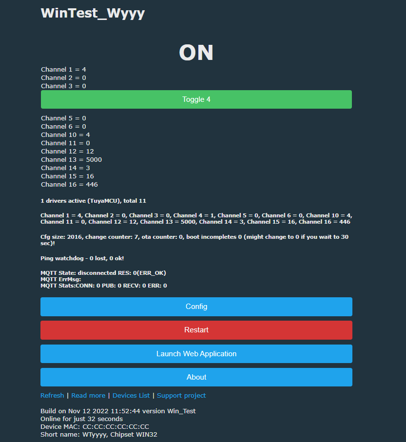

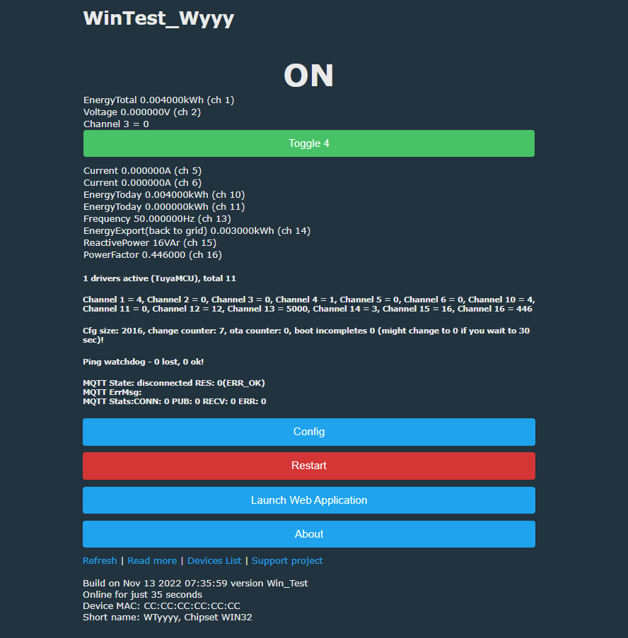

    Added after 35 [minutes]:
    OK dpId 16 is the toggle.
    I'm finding out more as we go:
    Here's the config I'm using so far to discover values:
    startDriver TuyaMCU
    setChannelType 1 ReadOnly
    linkTuyaMCUOutputToChannel 1 2 1
    setChannelType 2 ReadOnly
    linkTuyaMCUOutputToChannel 6 0 2
    setChannelType 3 ReadOnly
    linkTuyaMCUOutputToChannel 9 5 3
    setChannelType 4 Toggle
    linkTuyaMCUOutputToChannel 16 1 4
    setChannelType 5 ReadOnly
    linkTuyaMCUOutputToChannel 17 0 5
    setChannelType 6 ReadOnly
    linkTuyaMCUOutputToChannel 18 0 6
    setChannelType 10 ReadOnly
    linkTuyaMCUOutputToChannel 101 2 10
    setChannelType 11 ReadOnly
    linkTuyaMCUOutputToChannel 102 2 11
    setChannelType 12 ReadOnly
    linkTuyaMCUOutputToChannel 103 2 12
    setChannelType 13 ReadOnly
    linkTuyaMCUOutputToChannel 105 2 13
    setChannelType 14 ReadOnly
    linkTuyaMCUOutputToChannel 109 2 14
    setChannelType 15 ReadOnly
    linkTuyaMCUOutputToChannel 110 2 15
    setChannelType 16 ReadOnly
    linkTuyaMCUOutputToChannel 111 2 16
    Not sure yet how to display RAW values properly, as I think they hold the current and voltage.

  • Power factor scaling and TuyaMCU update rate question
    #7 20256920
    kraavok
    Posts: 6
    RAW values... how would YOU like to display them?
    I can add any channel type for you, I can add a "voltage" channel that will format value as volts, I can add a "current" channel, etc, it's up to you.
    Ah, ok, didn't realize they needed a new channel format. Makes sense now!
    I guess the following channels would be useful, to match my Tasmota plugs:
    OpenBK7231T (WB3S) Config for Hiking DDS238-2 Smart Meter: Tasmota Guide & Teardown OpenBK7231T (WB3S) Config for Hiking DDS238-2 Smart Meter: Tasmota Guide & Teardown
    Also.... dpID 111, power factor, values like that need to have a multiplier, right?
    It shows on the LCD display of the device as a decimal of the value listed. For example 542 shows as 0.542 so I suspect the value is simply clamped between 0 and 1000 and acts as the multiplier.
    The Apparent Power could then be calculated by multiplying the Active Power (W) by 1/ Power Factor (PF as decimal).
    Also, is there a way to ask TuyaMCU to update more frequently or is it fixed in their IC?
  • Request for dpID raw values and multipliers
    #8 20257021
    Posts: 14791
    Rate: 12937
    How often are you getting TuyaMCU updates? I will look into it.
    Can you specify again all found dpIDs with their raw values and meaning? I know to know the multipliers.
    Something like:
    - dpID 111 - power factor - raw value 542 means 0.542 (multiplier 0.001)
    - dpID 103 -voltage - raw value 221 means 221 (multiplier 1)
    - etc
    I want to add channel types for you, but I need to know multipliers.
  • Request for TuyaMCU dpID values and multipliers
    #9 20257052
    kraavok
    Posts: 6
    Right now, on the LCD display it's every second. In OpenBeken it arrives every minute I think.
    Something like:
    - dpID 103 - voltage - raw value 221 means 221 (multiplier 1)
    - etc
    Here's the current status of what I've figured out:
    1 - Energy Total (kWh) [UNCONFIRMED] - 0.001 multiplier
    6 - Voltage - 0.1 multiplier
    9 - [UNKNOWN]
    16 - Relay switch
    17 - [UNKNOWN - possibly current (more likely)] - if current, probably 0.01 multiplier
    18 - [UNKNOWN - possibly current] - if current, probably 0.01 multiplier
    101 - Energy Today (kWh) [UNCONFIRMED] - 0.001 multiplier
    102 - Energy Yesterday (kWh) [UNCONFIRMED] - 0.001 multiplier
    103 - Active Power (W) - NO multiplier
    105 - Frequency (Hz) - 0.01 multiplier
    109 - Energy Export [back to grid] (kWh) - 0.001 multiplier
    110 - Reactive Power (VAr) - NO multiplier
    111 - Power Factor (PF) - 0.001 multiplier
  • #10 20281655
    bizquik
    Posts: 7
    Hi,
    Do you have an update here?
    I have a DDS238-1, but it seems to work the same.
    For example, how can I read the voltage?
    Thanks.
  • Request for more TuyaMCU packet samples
    #11 20281707
    Posts: 14791
    Rate: 12937
    I will try to look into it today. I have ported OpenBeken to Windows and I will just add an UART simulator to 'fake' the TuyaMCU packets and write the support for their interpretations.
    If anyone wants to help, please provide me more TuyaMCU packets dump, preferably from the RX pins of WiFi (the packets that WiFi module receives) in a hex form.
    I have tools for analyzing them:

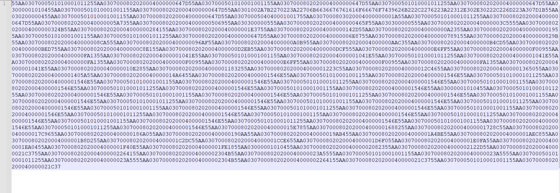

    How to make TuyaMCU packets dump
    1. solder RX of UART to USB connector to the given UART lane of your choice (for example, to RX of the Beken to see what Beken receives)
    2. Open RealTerm
    3. Go to Capture, set "Capture as Hex", disable other options (no commas, timestamps), enter file name, press "Start capture" and wait - it will capture to file (and will stop displaying output on RealTerm screen, just will be forwarding it to file"
    4. Get a file like:
    but this is just a general guide, I will try to use the data already provided here by @kraavok
    UPDATE Ok ok I am looking into it right now, I running OBK on Windows and created a packet simulator to run data that @kraavok provided:
    https://github.com/openshwprojects/OpenBK7231...mmit/984575f19fc1541641b59674072b84449cab2a0f
    I hope that the provided data will be enough
    UPDATE
    I only added variable types so far. Haven't done ROUNDING yet.
    I have a question about id 6. This is not an enum nor an integer. It is 15 bytes of data.
    Can anyone provide me more detailed samples of TuyaMCU packets, for example, with a certain known loads or voltages, so I can investigate more?
    I mean this data point:
    6:
    The DP_TYPE_RAW with 15 bytes of data is not even handled in my code yet. What kind of data is that?

    If your TuyaMCU is sending something, this is still very helpful. No need to solder wires. Let me plug this into my analysis tool.
    55 AA	03	07		00 13	06 00 00 0F 000000BF0000013C01F800064F0930 		180
    HEADER	VER=03	State		LEN	fnId=6 RAW V=00 00 00 BF 00 00 01 3C 01 F8 00 06 4F 09 30	CHK
    55 AA	03	07		00 13	06 00 00 0F 000000BD0000013C01F40006450936 		170
    HEADER	VER=03	State		LEN	fnId=6 RAW V=00 00 00 BD 00 00 01 3C 01 F4 00 06 45 09 36	CHK
    55 AA	03	07		00 13	06 00 00 0F 000000C10000013C01FD000653092E 		189
    HEADER	VER=03	State		LEN	fnId=6 RAW V=00 00 00 C1 00 00 01 3C 01 FD 00 06 53 09 2E	CHK
    55 AA	03	07		00 13	06 00 00 0F 000000BD0000013B01F6000646092E 		164
    HEADER	VER=03	State		LEN	fnId=6 RAW V=00 00 00 BD 00 00 01 3B 01 F6 00 06 46 09 2E	CHK
    55 AA	03	07		00 13	06 00 00 0F 000000BD0000013B01F5000646092D 		162
    HEADER	VER=03	State		LEN	fnId=6 RAW V=00 00 00 BD 00 00 01 3B 01 F5 00 06 46 09 2D	CHK
    but from a quick glance, I have not yet determined where the voltage is stored. I analyzed the data above in the hex editor and I can't see your voltage value yet, neither as a 32-bit float, nor an integer (most likely multiplied by 100 or so)
    I would need more samples. It would be extremely helpful to get, for example, a sample from voltage like 234V and then from 225V or even 180V if you have an autotransformer, but I assume that most people don't own one. Hmmm. I will think about it more later today.
    Also, maybe voltage is in different ID and not 6?

  • Voltage parsing confirmed from big-endian packet data
    #15 20282231
    Posts: 14791
    Rate: 12937
    Please do. And make a longer log file for me for analysis, maybe I will come up with something.
    First let's decode those dpIDs, then we will handle the MQTT publishes.
    Good thing also would be a test with 60W bulb and then a test with 10W bulb and two separate log files for comparison.

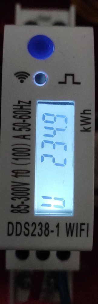

    Huh, now @btsimonh made me realize I haven't checked the big-endian values.... thanks @btsimonh !
    000000BD0000013B01F5000646 092D
    This stands for 2349 which is most likely the voltage...
    So that's it! I will now consider how to handle it in code.
    Voltage parsing done, now I need two packet dumps:
    - one with 60W bulb load
    - one with 10W bulb load
  • Current appears stored in dpId 6 raw payload
    #16 20283360
    bizquik
    Posts: 7
    I didn't managed to take package dumps with controlled loads, but I think I found where the current is stored.
    I did this with more samples, but take this example:
    Info:TuyaMCU:TUYAMCU received: 55 AA 03 07 00 13 06 00 00 0F 00 00 00 D3 00 00 01 26 02 3A 00 06 13 09 4C D5
    Info:TuyaMCU:TUYAMCU received: 55 AA 03 07 00 08 67 02 00 04 00 00 00 D3 51
    Info:TuyaMCU:TuyaMCU_ParseStateMessage: processing dpId 103, dataType 2-DP_TYPE_VALUE and 4 data bytes
    Info:TuyaMCU:TuyaMCU_ParseStateMessage: raw data 4 int: 211
    Info:TuyaMCU:TUYAMCU received: 55 AA 03 07 00 08 6F 02 00 04 00 00 02 38 C0
    Info:TuyaMCU:TuyaMCU_ParseStateMessage: processing dpId 111, dataType 2-DP_TYPE_VALUE and 4 data bytes
    Info:TuyaMCU:TuyaMCU_ParseStateMessage: raw data 4 int: 568
    103 is power (so 211W) and 111 is power factor (0.568)
    Voltage is 094C so 238V.
    If my math is right, the current should be ~1.56A.
    The display confirmed this value.
    From dpId 6 if we take 2 or 3 bytes, before the voltage, we get 000613 (so 1555)
    Seems right to me.
    dpIds 117 and 118 didn't change in all my samples.

    Info:TuyaMCU:TUYAMCU received: 55 AA 03 07 00 08 6F 02 00 04 00 00 02 C4 4C
    Info:TuyaMCU:TuyaMCU_ParseStateMessage: raw data 4 int: 708
  • Current OpenBK7231T config and remaining meter variables

    This is the current config I use in the simulator (based on your packets):
    startDriver TuyaMCU
    setChannelType 10 Current_div1000
    setChannelType 11 Voltage_div10
    setChannelType 12 Power
    setChannelType 13 PowerFactor_div1000
    // special syntax for 15 bytes packets containing multiple variables
    // (no channel specified, it will set channels by their type automatically)
    // This sets Current_div1000 and Voltage_div10
    linkTuyaMCUOutputToChannel 6 RAW_DDS238
    // this links tuyamcu var 103 to channel 12 which is Power
    linkTuyaMCUOutputToChannel 103 Enum 12
    // this links tuyamcu var 111 to channel 13 which is PowerFactor_div1000
    linkTuyaMCUOutputToChannel 111 Enum 13
    This is how it looks like on panel:
    What next do we need? There is much more variables, but I am not sure about their meanings.
    For example, are we sure about that "today consumption total" and "yesterday"?

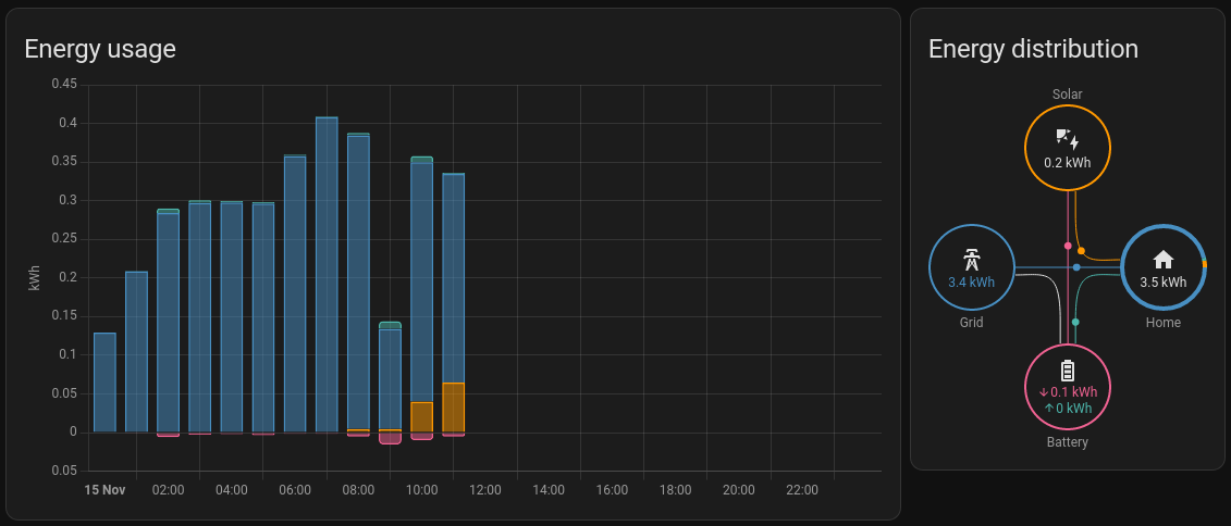

    MQTT with plain text is fine for me.
    I already integrated it in Home Assistant and it calculates hourly/daily/monthly/cost/etc.
    Automatic discovery in HA would be nice, but I only have one BK7231T device, so it wasn't a problem for me.
    It works great.
    Thanks a lot!
