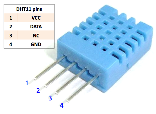

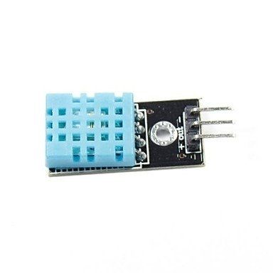

    Hi there, I got the ESP8266 NODEmcu V2 WIFI module up and running, uploaded the sample programs, connected to the internet, sent POST variables to my site, received the correct data, everything worked great. Until I connected DHT11 module according to this guide . The only thing that didn't match in the tutorial was the order of the pins in the sensor, but I connected according to the description on the board.
    Now, after connecting the module to the computer, the LED lights up faintly (I don't think it lit up much before either) the port is visible, recognised correctly but nothing can be uploaded, an error appears:

    I think it is correct but applies to a different version of the sensor, I have one:
    ESP8266 NODEmcu V2 not uploading code after connecting DHT11 sensor .
    there the signal is in the middle and in the guide on the left. I connected to the module board according to the description on the board because it seems more reliable to me, there may be a different version.

    Grzecho83 wrote:
    Now when you connect the module to the computer, the LED lights up faintly
    Check that you have 3.3V on the module with the ESP Maybe there was some kind of short circuit or power failure when connecting the DHT?
