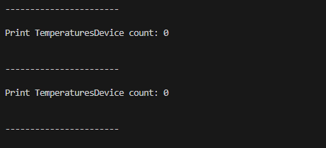

    Hi.
    I have an ESP8266 WiFi Module + NodeMCU v3 to which I have connected two DS18B20 sensors under pin D7.
    For some reason the sensors are not detected.
    main.cpp
    Code: C / C++
    TemperatureSensorController.cpp
    Code: C / C++
    Result of program:
    Screenshot showing the program output with the result Device count: 0.

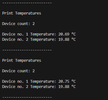

    Physically the connections are ok - running the code where everything is in main.cpp reads are executed correctly.
    main.cpp
    Code: C / C++
    Output displaying temperatures from two sensors.
    Thanks in advance for your help.
  • Temporary object assignment breaks OneWire pointer linkage
    #2 21075389
    Posts: 14756
    Rate: 12883
    I have a definite suspicion of what might be going on here. I've flipped the code into Visual and done a little example:
    Code: C / C++
    Result:
    Screenshot of program output showing pointer addresses and variable values.
    You may now wonder why these pointers are pointing to different objects of the OneWire class....
