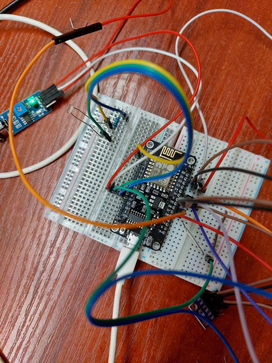

    While programming a weather station on an ESP8266 NodeMcu v3, I encountered a problem. When nothing is connected on the pin there is a high state, despite changing the state to 0. Here is the program code:

    It's about the reed switch on D5, On D8 it reacts as it is supposed to (when a magnet is approaching it shows a high state, when no magnet is present it shows a low state) When I tried to change to a different location it still shows a high state everywhere (D5). Even when I do not connect anything to the pin I am programming.

    I have checked the program code without the reed switch connected (open circuit) as well as with it connected (on open circuit and closed circuit-approximate magnet) in each case a state of 1 instead of 0 despite assigning a state of 0 to a variable, as in the program. It all works as far as the reed switch which is disconnected to D8 is concerned. The reed switch is also high all the time after being moved from D8 to D5. So something must be wrong with the program or the board.

    Pin D8 has a pull down to GND. D5 does not have this. Give a pull down resistor of 10k . And even better use reverse logic i.e. short circuit gpio to GND.

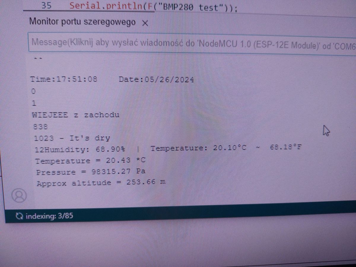

    How to do such reverse logic? I just have to instead of 3.3v --> Reed --> D5, make GND --> Reed --> D5? Do I have to do D5 as output in this case? And I understand that there is no e.g. pull down to GND, but why do I see in the serial monitor that the value is high? Even though the pin is physically empty, because I do not even connect the reed switch to it?
    Serial monitor display with sensor data. Breadboard with connected wires and an ESP8266 module.
    Under the hour, the first value shows the state of pin D8.
    The second value shows the state of pin D5 (which is currently empty).

    will someone write me how the reverse logic looks like? or how to do it? I can't very much from the information I've found draw conclusions that will guide me to it.

    So it's better to use the input pulled up to 3.3V, and let the reed switch short them to ground.
    I don't trust internal resistors and always use physical 10kOm to 3.3V.
    Also note that you are using D8 which is already physically pulled down to GND. If it is pulled up to plus during boot then the ESP8266 will not boot.
    You will not change the state on the input programmatically. You can only do this on pins declared as output. That is, you can, but its state read by digitalRead will be the voltage on it at the time of reading.

    I familiarised myself once again with the topic of pulling down to earth and succeeded.
