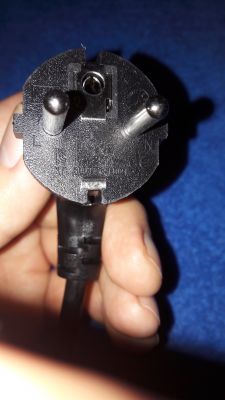

    There is an informal standard for the CEE 7/7 plug that was supposed to be universally applicable throughout Europe, but has not been officially adopted due to a lack of agreement among CENELEC delegates. Several countries did not support this. This non-existent but existing "Euro plug" has the markings L and N next to the pins on the plug in such a way that L is next to the pin that connects to the right contact of the socket. I have two devices with such a plug at home. One has a UPS power supply, the other is from the computer. I also saw a portable induction cooker in some store and it was equally polarized. As for the UPS, connecting it to a socket with the phase on the left triggers the RCD. It's a photo plug.
    Standards regulating the connection of wire colors to pins in molded plugs
    The plugin is common in Western Europe, especially in France, Belgium, Spain, as well as in Russia and Ukraine. UPS came to me from Germany, so I guess they use them too Added after 10 [minutes]:

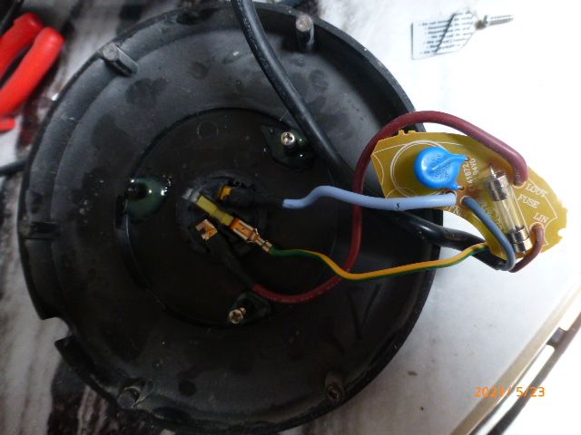

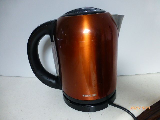

    E.g.: kettle with metal casing:
    1. The electric heater shorts out and shorts out to the metal bottom which is connected to the metal casing.
    2. The internal fuse located in the socket is blown.
    3. A blown fuse cuts off the brown wire connected to the right pin in the plug.
    4. Depending on which side the phase in the socket is connected, the following scenarios will occur:
    a) phase on the right side of the socket. At most we will hear: " F.... the Chinese crap has gone bad again ".
    b) phase on the left side of the socket. Possible real electric shock.
    Since the rest of the world (according to my observations and the entries of others) uses the phase on the right side of the plug, even though there is no rule in Poland, the phase should also be installed on the right side of the socket.
    Otherwise, connecting class I devices poses a risk of electric shock.
