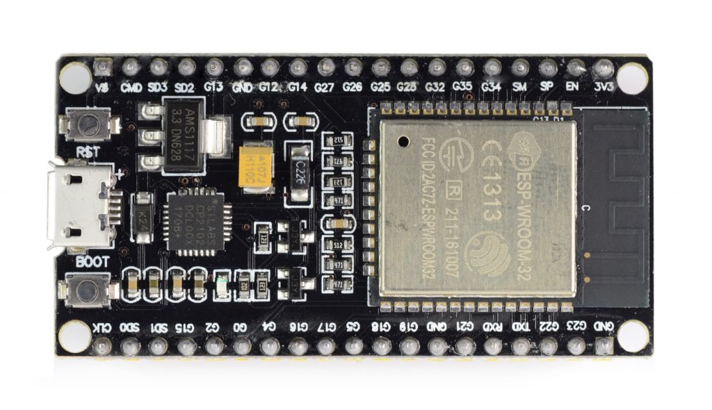

Why does my ESP32 freeze when the 230 V solenoid valve closes, and how can I suppress the interference?
The freeze is most likely caused by electromagnetic interference from the solenoid valve or its wiring when the relay switches it off, not by the pumps or the relay board alone [#19427419][#19430661] Add an RC snubber/suppressor on the valve switching contacts; one recommendation was about 100 Ω with 10–22 nF, because 0.470 µF with 1 kΩ was considered far too large [#19426866][#19429659] After fitting suppressors (100 Ω + 22 nF) the circuit initially became stable [#19427982] Keep the valve wiring as far as possible from the ESP/display wiring, and if needed test the ESP from a battery or use a fully isolated relay supply to rule out mains noise [#19427419][#19431545]

    khoam wrote:
    globalinfo wrote:
    Can you suggest to which pins to connect the 100nF capacitor at the ESP32 as I have power supply via microUSB.
    Power supply pin 3V3 (2): capacitors 100nF (ceramic) and 1000uF (as close as possible)
    EN pin (3): 100nF capacitor (ceramic, as close as possible)
    [/url]
    To the circuit itself I'm unlikely to solder it.
    Maybe to the trunk which is on the attached board.
    • ESP32 - Suspension of the program when closing the solenoid valve in the CH and CUW system WROOM.jpg (104.48 KB) You must be logged in to download this attachment.

    Well, what should I think - from yesterday's suspensions until today it has been OK - the valve works without any problems.
    When the capacitors arrive I'll put them on.

    globalinfo
    Posts: 430
    Rate: 30
    khoam wrote:
    globalinfo wrote:
    What am I supposed to think - from yesterday's suspensions until today it's OK - the valve works without any problems.
    Maybe you've changed the routing of the wires in the meantime?
    Tek every time I open into the box it changes the position of the cables e.g. to the display and relays.

    globalinfo
    Posts: 430
    Rate: 30
    I think it's going to work now, it hasn't jammed for a long time.
