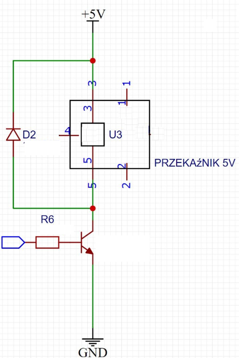

    Hey.
    I have more or less the following circuit controlling a relay:
    Relay control circuit diagram using a transistor, diode, and resistor. .
    I've deleted the values because I can't open it up to read the data precisely now, but the circuit works to some extent.
    The control is provided to me by the GPIO25 output on the ESP32 Vroom 30pin chip.

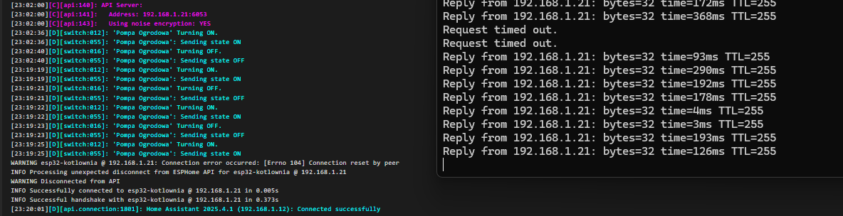

    When switching the state on the GPIO25 pin, 4 times out of 5, the relay, and at the same time the contactor, switches on/off. On the other hand, this one time out of five, the ESP32 feels like it reboots, at which point it loses connection to WiFi.
    Screenshot showing ESP32 and Home Assistant logs with network connection loss and ping timeouts when switching a relay. .
    When I have only the relay connected, the ESP32 works stably and does not lose WiFi connection. The trouble starts when I add the aforementioned contactor to the whole thing.

    nkznkz wrote:
    Should I focus more on interference from the power supply side of the ESP32, or should I pay attention to electromagnetic interference though?
    One and two, you haven't shown the workmanship of the whole thing and what power supply you don't know if the AC is far from the cables and board. But the problem is with the power supply "peaks" on the esp.

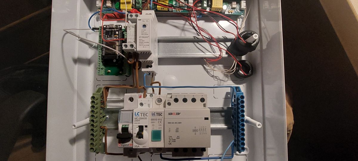

    I won't draw out the schematic now but I am posting a picture which may be enough for some:
    Interior of an electrical cabinet with relays, contactors, wires, and a YINGJIAO switching power supply.
    The power supply is a Chinese YINGJIAO with voltage regulation (as pictured).
    I should mention that there will eventually be two contactors in the box, with one 3f. So as you can see the environment is somewhat toxic.
    I'm considering a gasifier circuit, but on the other hand I'm thinking of taking the low voltage electronics outside because even the 5% unreliability mentioned by @khoam will annoy me greatly.
    On the other hand I'm thinking of replacing the ESP32 with something else without wifi with ethernet hooked up to the chip, something more resistant to the interference mentioned.
    After testing what I've built for myself, I have quite a bit of confusion.
  • #8 21524989
    TvWidget
    Posts: 4425
    Help: 472
    Rate: 699
    This 5V relay has a coil with a large number of turns. There are interference-generating components nearby. This coil acts as a very effective antenna. As far as simple solutions are concerned, in addition to the gasifier circuit, you can try connecting the relay to 5V through a diode. Also observe if the problem occurs when the contacts are opened or shorted.

  • #11 21527875
    nkznkz
    Posts: 24
    Yes.
    Supplying the 5V power supply from the same source on which the contactor was standing, generated the problem, as a surge to another supply reduced the effect by 90%.
    Nevertheless, there were still occasional reboots, so I was forced to take the ESP32 out of the box which has already eliminated the problems definitively.
    Thank you all for your comments and feedback.
