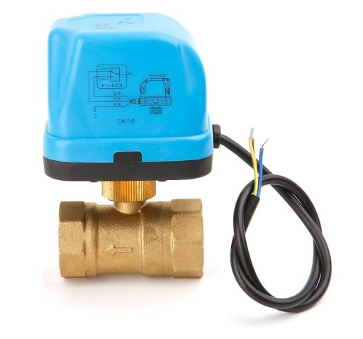

    I am controlling 3 circulating pumps and one solenoid valve in a CH and CUW system using ESP32.
    I have a problem because when closing the solenoid valve the program crashes you.
    When switching the pumps on and off and opening the solenoid valve it has never crashed.
    The ESP is powered via USB from a power supply hooked up to a small UPS.
    The pumps and electro-valve are powered by ~230V - wires of about 2.5m each.
    I also added a 2200uF capacitor at the ESP power supply but this did not help.

    The valve is barely 6W.
    UPS is not enough?
    It should protect against interference.

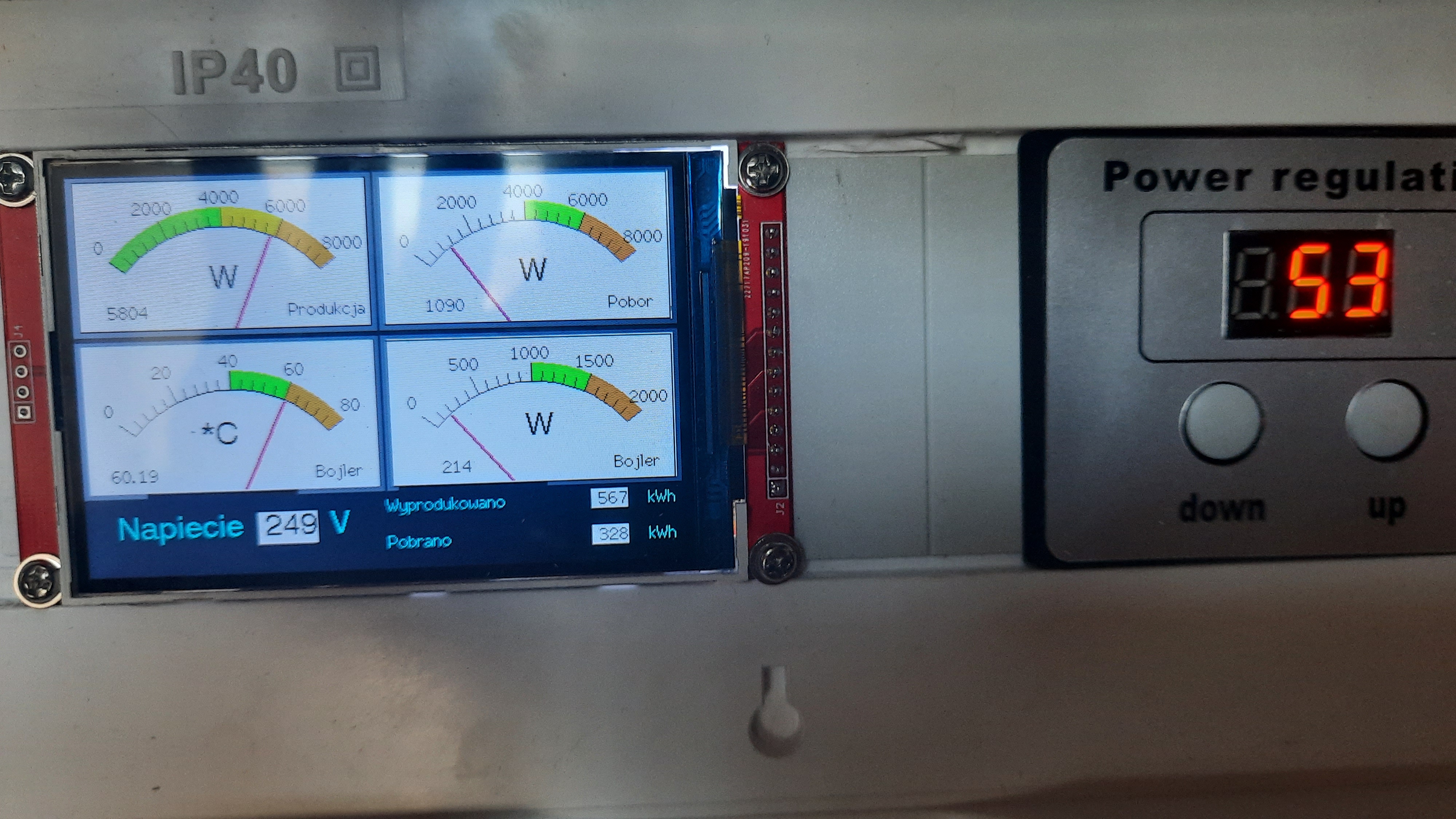

    I fitted two circuits with suppressors (100 ohm resistor + 22nF capacitor) to the switching contacts for the solenoid valve.
    At this point the circuit is working stably.
    I will leave it for two days for testing.

    I'm sure about the program and controller - I tested it without connecting the solenoid valve and pumps - it never crashed or reset.
    Of course there was a bit of fiddling when connecting the display, but that got it right.
    Below is a link to a video of the circuit during the test .
    Link .
    Link2 - display driver tests

    Specifically this - the display goes black, the relays to the fans stop working (don't switch on), the power consumption controller does not receive control signals, no data is sent to the server - this state persists until the ESP is switched off and on.

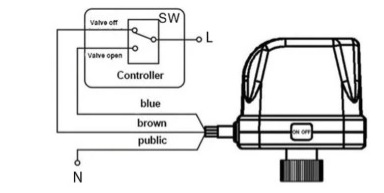

    I should add that the solenoid valve is not on a solenoid but has an actuator on a ~230V motor.

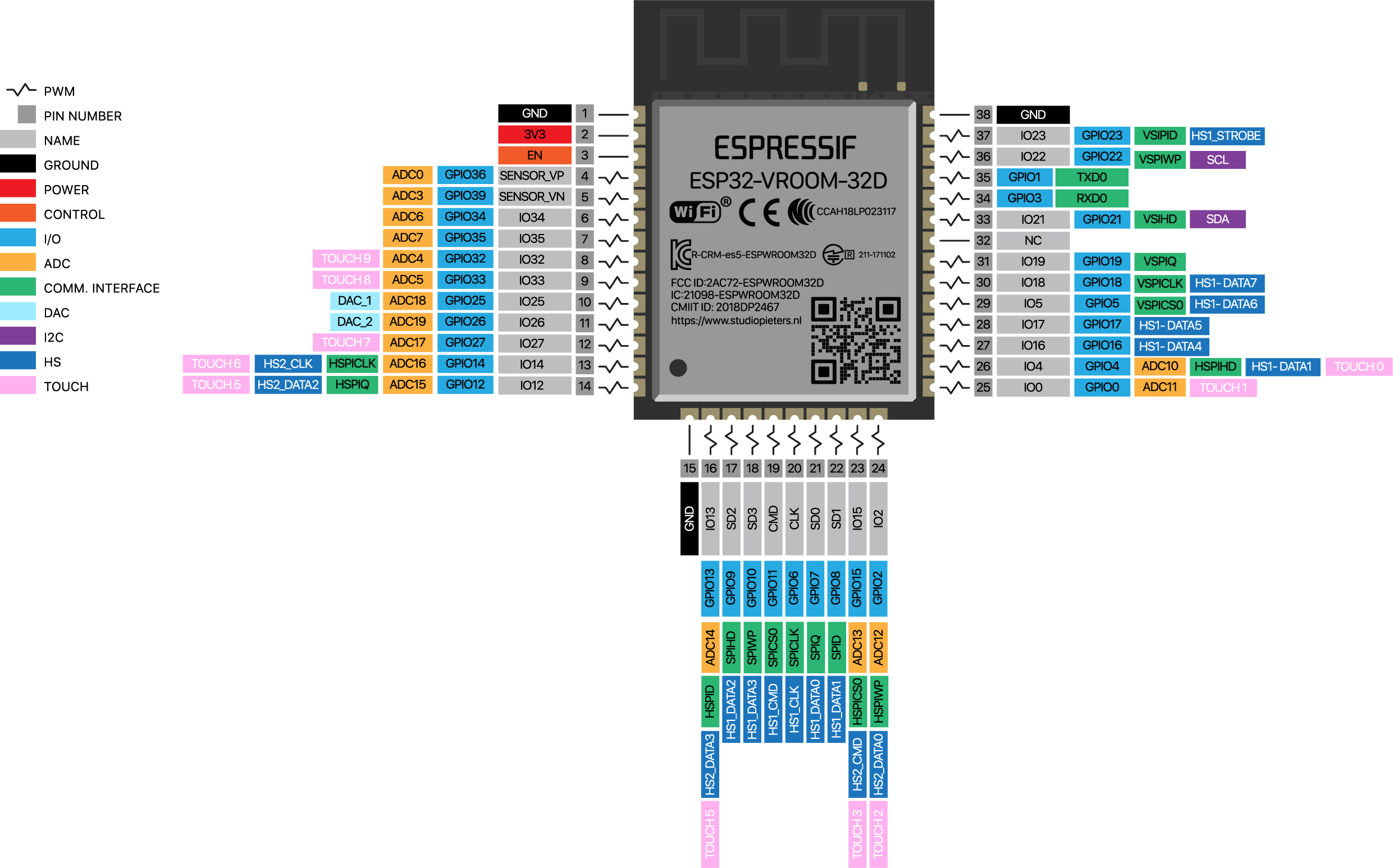

    Can you suggest to which pins to connect the 100nF capacitor at ESP32 as I have power via microUSB.
