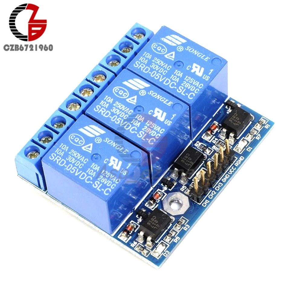

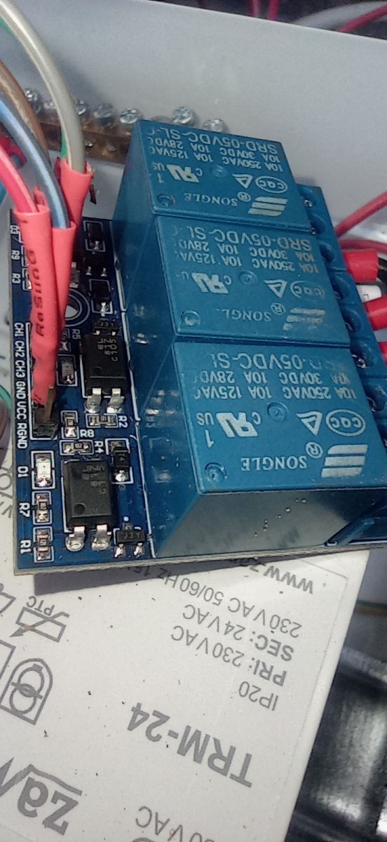

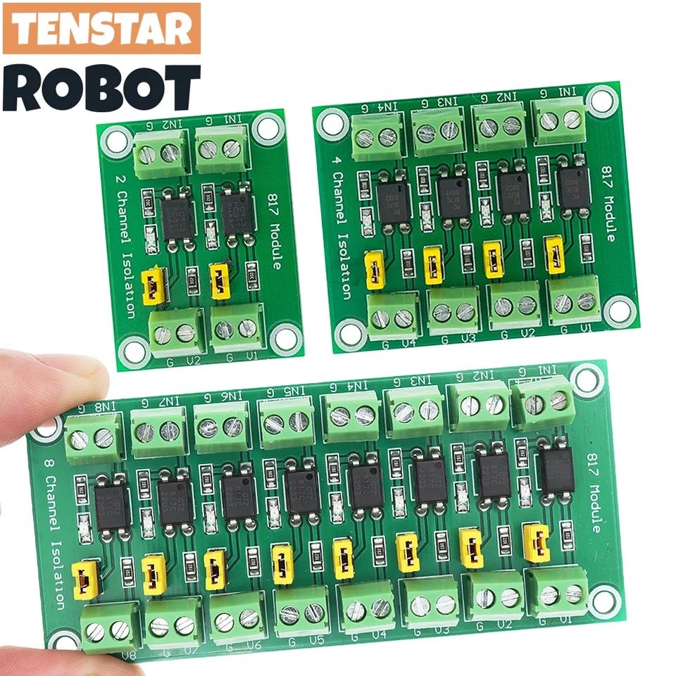

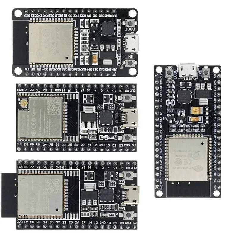

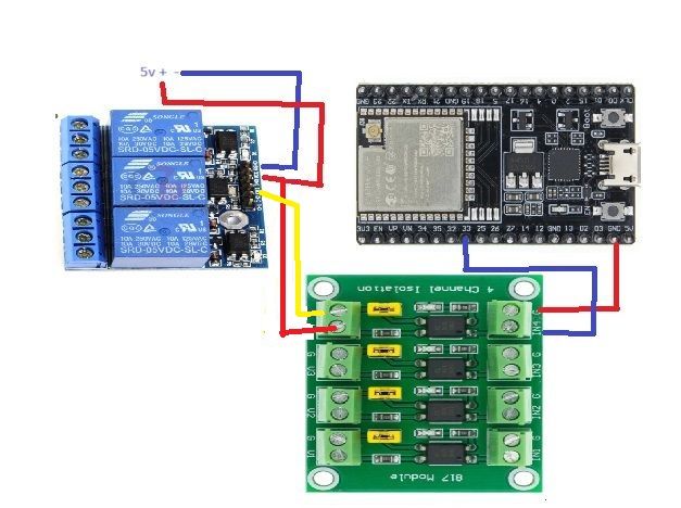

    Hello I need to control via ESP module relays that are about 30m away from the ESP , I have such modules as shown in the pictures and I am combining but it does not want to work . Can someone tell me how to connect this? Controlling relays 30m away with ESP module - how to connect? Controlling relays 30m away with ESP module - how to connect? Controlling relays 30m away with ESP module - how to connect?

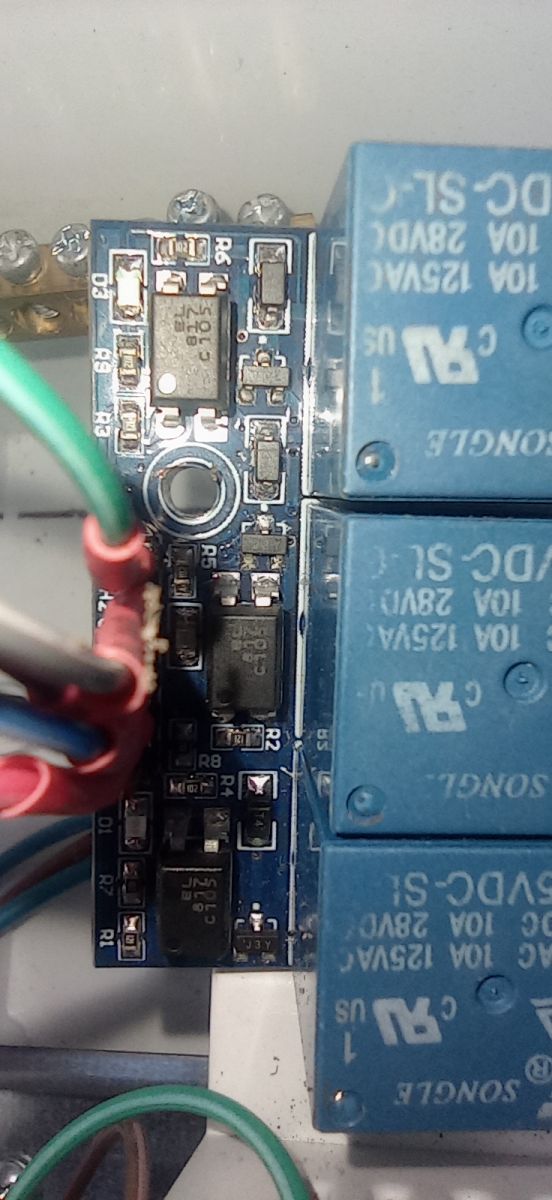

    Draw how you clip it together, because here you have two modules separating, one at the relays (opto) and the other on the green boards.

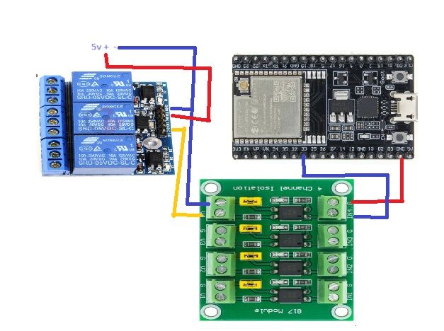

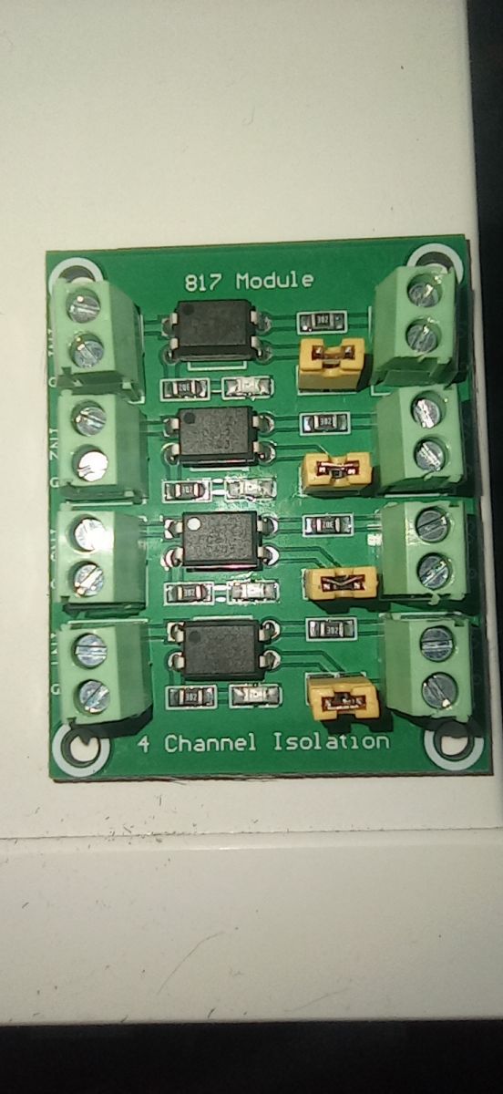

    From the ESP I connect GND and GPIO to the green board, and from the green board I connect GND and IN1 to the relay, and 5V power from the USB charger.

    And do you know how to draw diagrams? One diagram will explain more than a thousand words.
    Jarzabek666 wrote:
    30m is a lot for 3.3V you need to change concepts.
    Not a tragedy, I used to do about 70m on 5V. Although it is actually better to change the concept.

    A bit too far for this way of working and connecting. Strengthening the line (power) between the relays and the "green board" will probably solve the problem. However, you need to change the concept.
    Probably it is the control of some gate ? gate ? If so, it might be easier regarding access to the 12/24V power supply

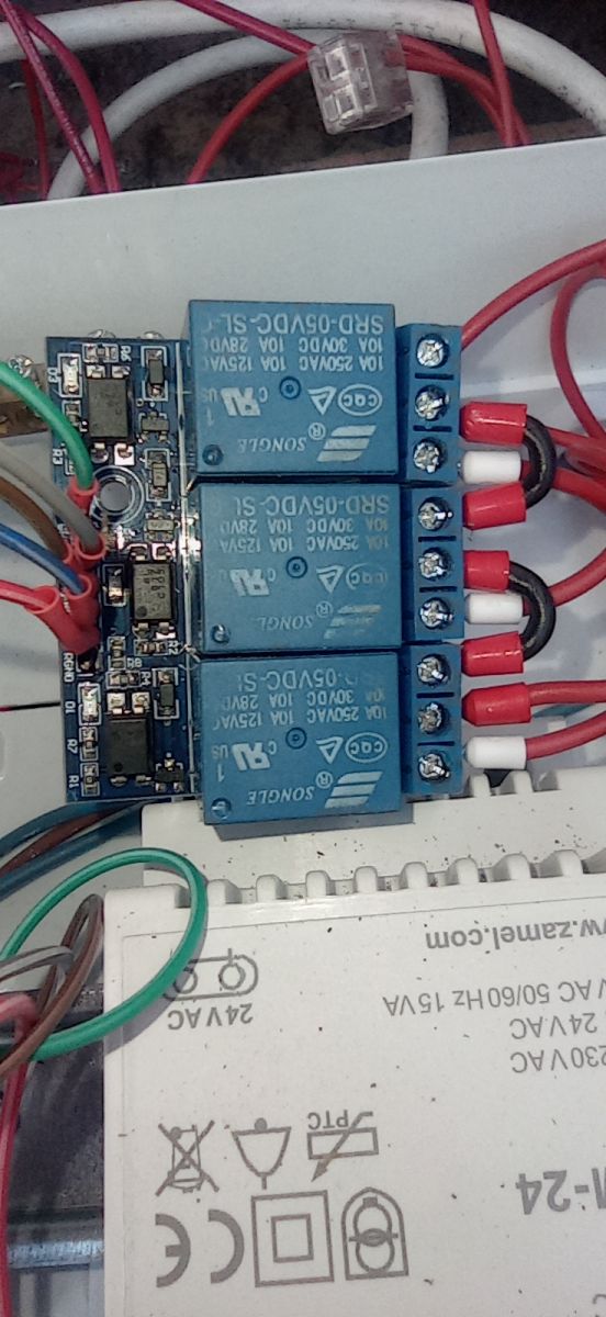

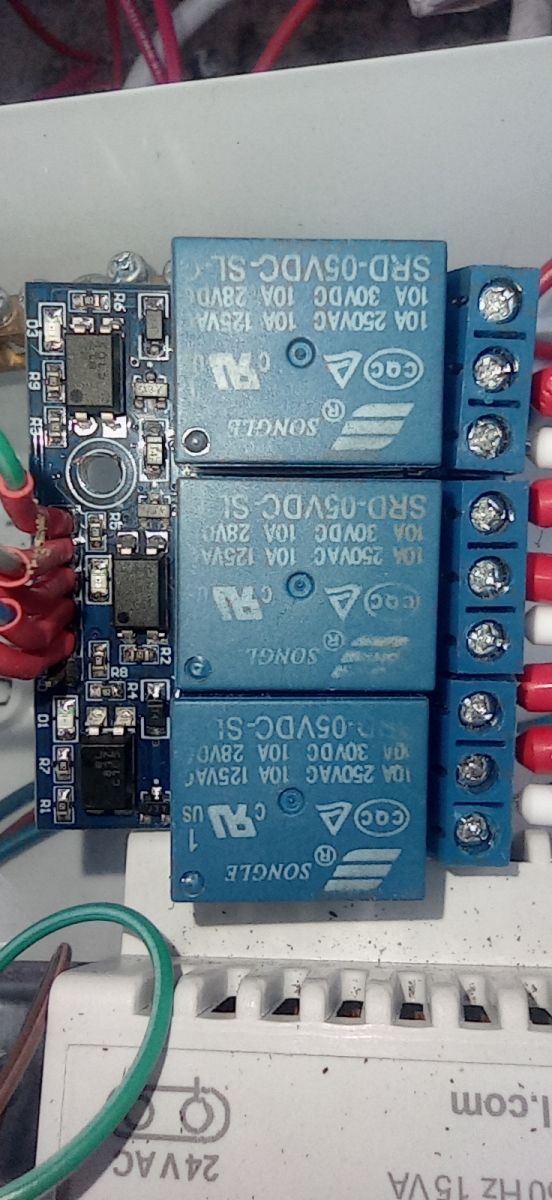

    It's about the control of the solenoid valves, I'm willing to change the concept but I don't know to which one, currently what I have is 230V in the place where the solenoid valves are, relays and 24V power supply and a twisted pair of wires to another place where I have WiFi and it's from there I want to control these valves with ESP
    Added after 1 [hour] 16 [minutes]: .
    I tried it like this
    Controlling relays 30m away with ESP module - how to connect? I tried it like this.

    Controlling relays 30m away with ESP module - how to connect? .
    If he can tolerate that voltage, why not give 24V to the signal transmix?

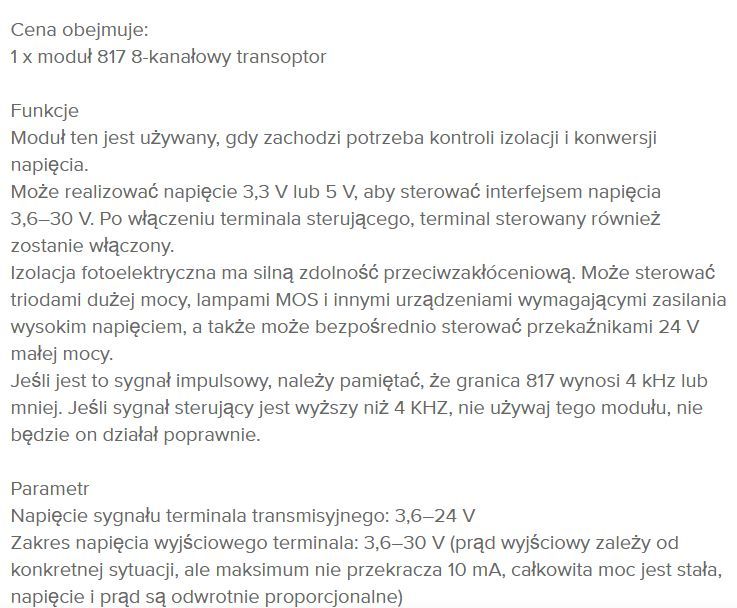

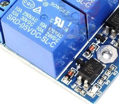

    In the description of the relay module, it says that control is by 5v or 3.3v
  • #11 21147243
    kindlar
    Level 42  
    Posts: 7888
    Help: 919
    Rate: 1622
    There I think is an opto-isolation on the signal transmission side, I guess there can be more voltage that the circuit can tolerate. The relay is another step and another signal.
    Give a link to the description.
  • #12 21147251
    PawelJuszczak
    Posts: 30
    I've just managed to find this great product on the AliExpress platform, check it out!
    PLN13.91 | 3.3V 5V 3 relay module 5mA with optocoupler isolation compatible signal
    https://a.aliexpress.com/_EwjX9kB

    And the idea came to me that this module with relays should be next to the ESP, and the twisted pair should be used to supply 24V to the solenoid valves. The only thing is whether I can apply this voltage to the twisted pair and whether there won't be a voltage drop over 30 metres

    PawelJuszczak wrote:
    will there be no voltage drop over 30 metres
    There will probably be a voltage drop by the resistance of the wires. Valves need some current so a power source is good to give near them and amplify the control signal. Stranded wire is also poorly suited for high current control, you would have to connect the wires in multiples.

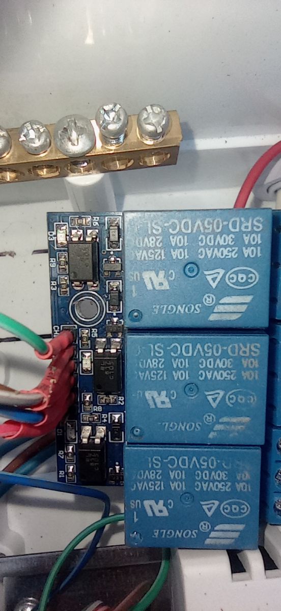

    I am sending a picture of the module Controlling relays 30m away with ESP module - how to connect?
