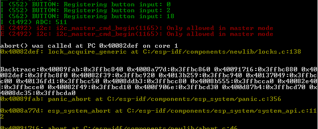

    [RTOS][esp-idf] ESP32 interrupts and shuffles some basic questions .

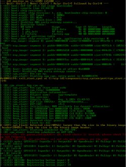

    this is the library
    https://github.com/craftmetrics/esp32-button
    I have repeated the definitions
    #define BUTTON_DOWN (1)
    #define BUTTON_UP (2)
    #define BUTTON_HELD (3)
    in button.c and main.c
    eclipse did not throw a multiple definition error just the underscores disappeared.
    The program uploaded, it restarts again.

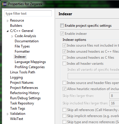

    I had a new eclipse uploaded when I upgraded, and it's the one with these actions on it. I think I will try it with what I had before.
    Project settings. There seems to be something missing here

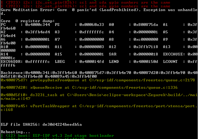

    I went back to esp-idf v4.2
    Eclipse continued to underline but after uploading the program works as before.
    I went back to eclipse 2020-12
    It no longer underlines anything and everything works as it should.

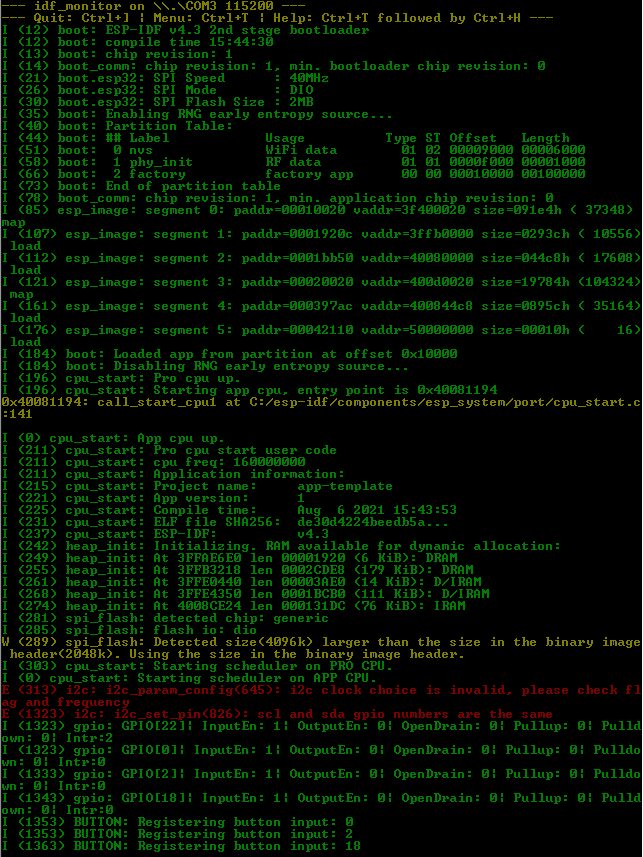

    Just to be sure, I still tried on the old eclipse (2020-12) and idf v4.3
    It does not highlight errors the program loads and does not work. Something messed up in the new idf version

    #38 19552251
    NIXIE_123
    Posts: 2087
    Help: 288
    Rate: 610
    Code: C / C++
    Compiles the same project all the time. 4.2 works 4.3 does not work
    EDIT:
    Problem solved. Need to add
    conf.clk_flags = 0;
    Now I can get on with the actual problem i.e. interrupts. I will let you know when I have sculpted something.
    I am running on esp-idf v4.3 and eclipse 2020-12
  • Initialize i2c_config_t clk_flags to 0

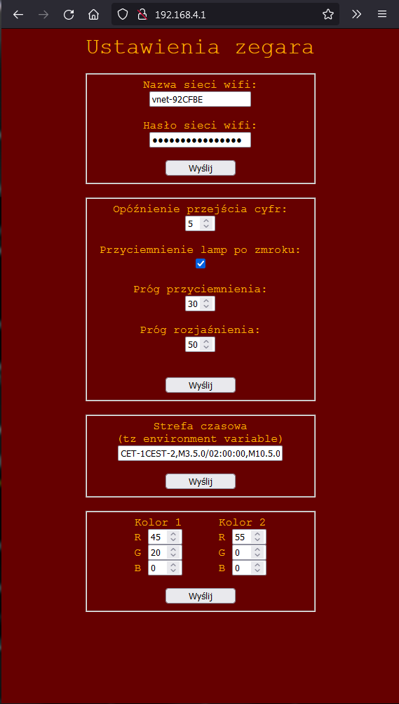

    There is one last thing left to do. Setting a few variables from the browser.
    What I want to achieve:
    I plug in the device without holding the button - in the old way, my code executes
    I power on the device while holding the button - my code does not execute.
    The Esp32 is in AP mode. I connect to its wifi by typing 192.168.4.1 into the browser. I see a simple page where I can enter ssid password and 2 variables. All this is written into non-volatile memory
    There is already a topic about this Link but those libraries are on arduino :| .
    There is also Link but you can only set what network it should connect to and it supervises that connection and I'm not interested in that. I just want a simple entry of 4 variables into memory and that's all
    How do I achieve this? There are some libraries or maybe do the AP mode server and nvs support myself just why break down an open door. Having learnt from experience that esp can be capricious and requires tricks I prefer something ready made rather than sitting on a simple thing for half a year

    I already have everything running even on 35us.
    I am now doing AP + http server and html page with settings.
    I already have the page and by pressing send in the browser I can see the input data in the console.
    Now I just split them up save them to nvs and I have what I want.
