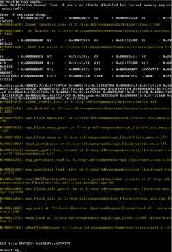

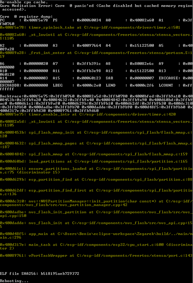

  • Timer interrupt crashes NVS flash reads
    #16 19546466
  • #17 19547626

  • interrupt_from_timer_mux() exceeds ISR time budget
    #18 19547733
  • IRAM interrupt avoids flash-write blocking
    #19 19550055

    ESP_Sprite wrote:
    The thing is flash (write) accesses.
    An interrupt marked as in IRAM will keep functioning when a flash write happens (which in this case is what happens when you initialize NVS), a non-IRAM interrupt will be disabled for as long as the flash write takes.
    However, you must guarantee that the interrupt handler plus all data it accesses are in internal memory for you to be able to mark it as in IRAM, otherwise you'll get crashes like this.
  • IRAM flag needed to avoid flash-write blocking
    #20 19550140
