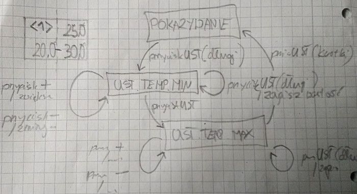

    "Switch-Case" has already been mentioned and it will be simple. To make it easier, I suggest you draw this menu on a piece of paper, e.g. like this:
    ESP8266 + Encoder + TFT ILI9341: How to create a menu to set the parameters of the DS18b20 thermomet .
    The whole drawing is one "switch" and the rectangles are "case". The arrows respond to the buttons, here "plus", "minus" and "ust" (settings).
    Greetings
    I added at 17:18:
    I have inserted a drawing. Two minutes of drawing is the whole creative part. Now it just needs to be rewritten in C. It is a simple state machine, I assume not everyone will like it.
