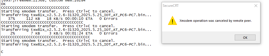

  • Teardown of cheap Wi‑Fi earwax remover otoscopes that use the Taixen TXW816-810 and expose UART, pinout, and firmware details.

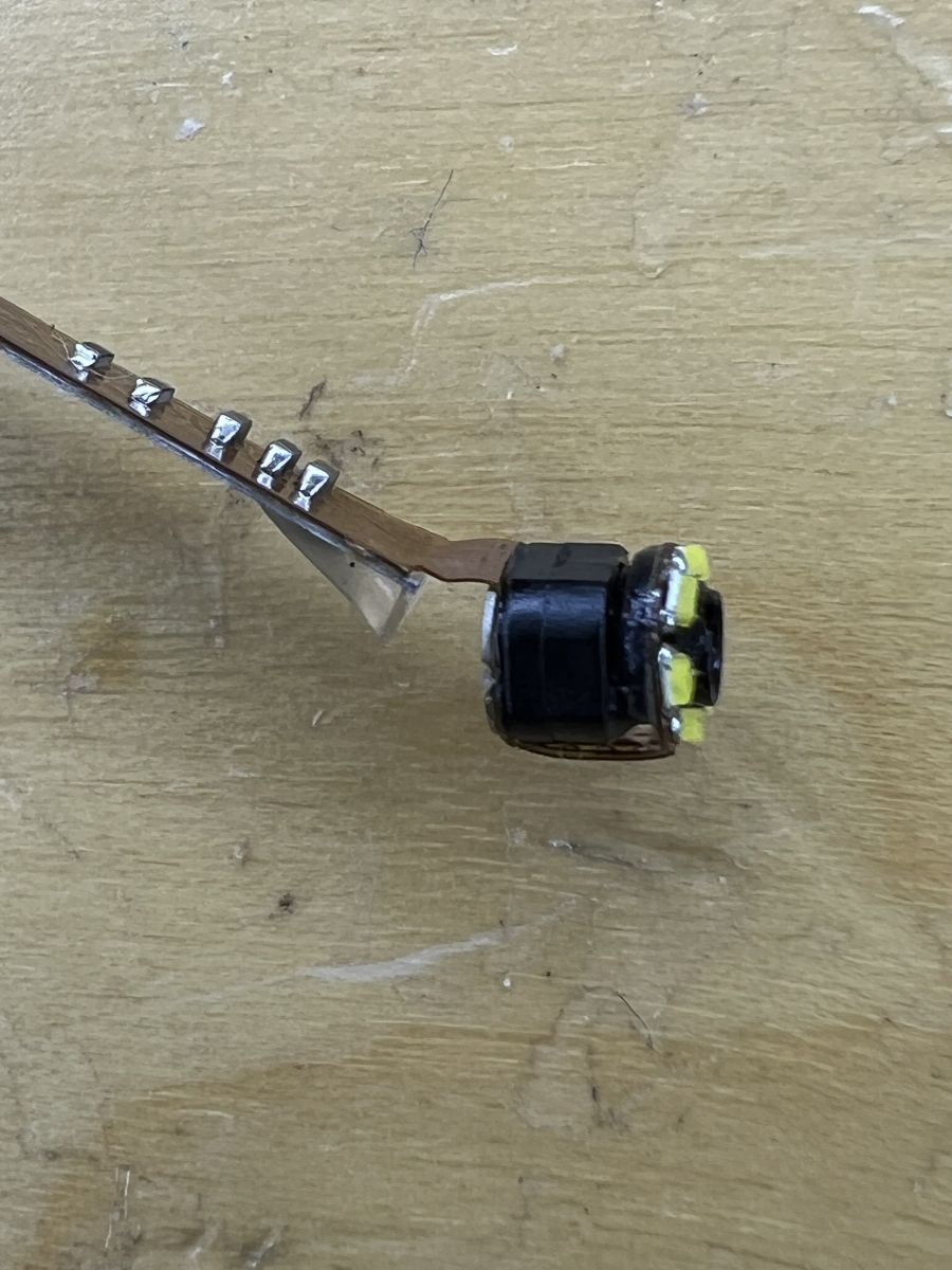

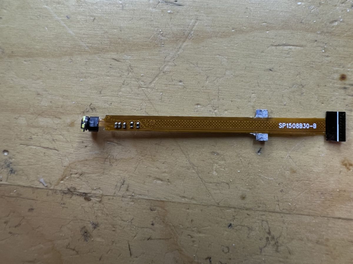

  • Inside, the board has a 21-pin camera/LED connector and exposed pads for 3.3V, 5V, CE, DP (UART TX), CLK, TMS, and PA8.

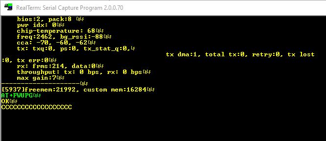

  • UART logs identify hgSDK-v2.5.0.7, BK7231U-XRH-FBPRO, a HI708 sensor at 480×480, and an AP named Soulear-ae45b with DHCP from 192.168.1.10.
  • An STM32 Blue Pill acting as CKLink dumped the 1 MB flash in chunks, and lowering the ICE clock from 12000KHz to 1200KHz made reads reliable.
  • The firmware still needs proper C-Sky V2 analysis support, and a licensing-related component remains unexplained.

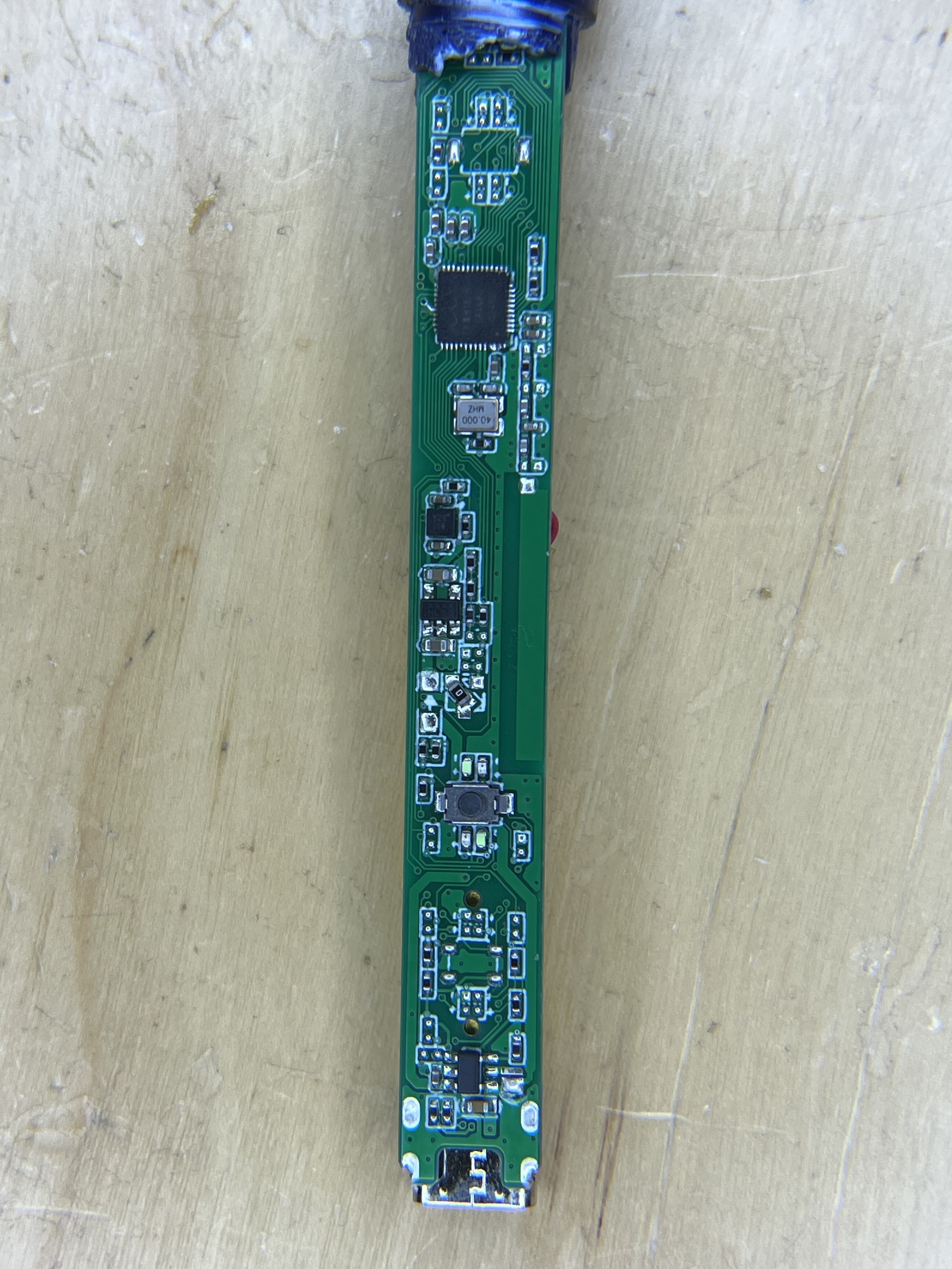

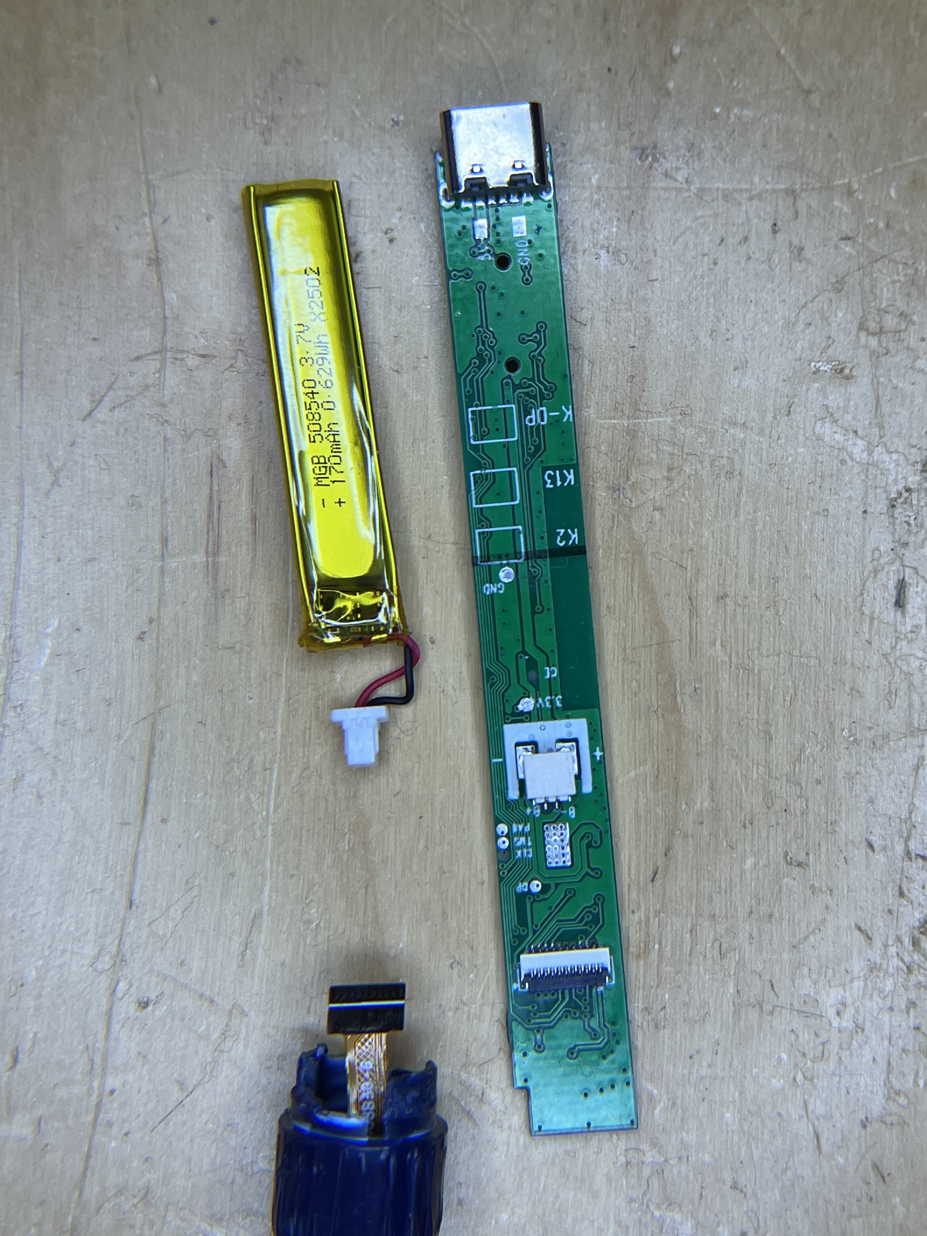

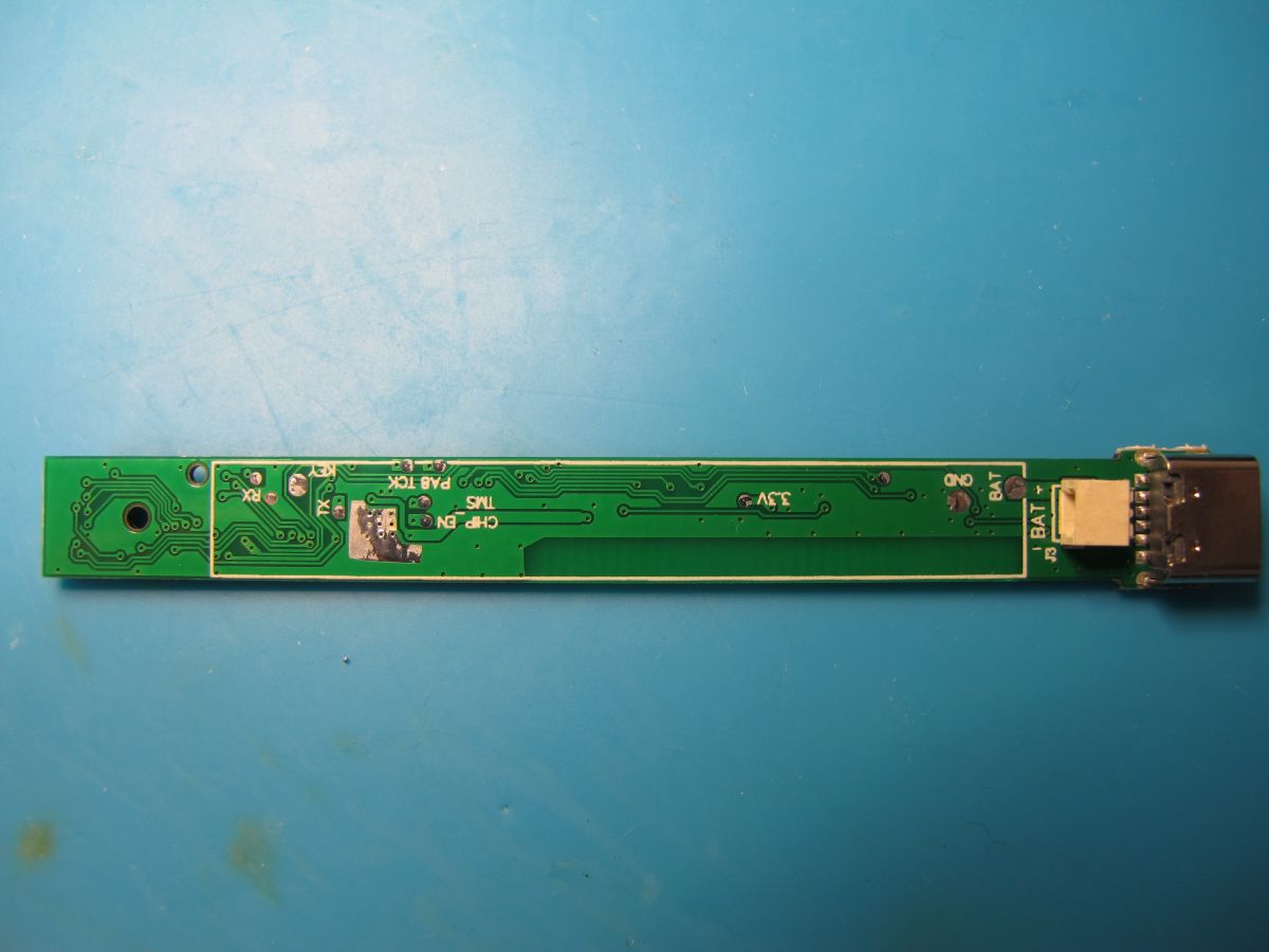

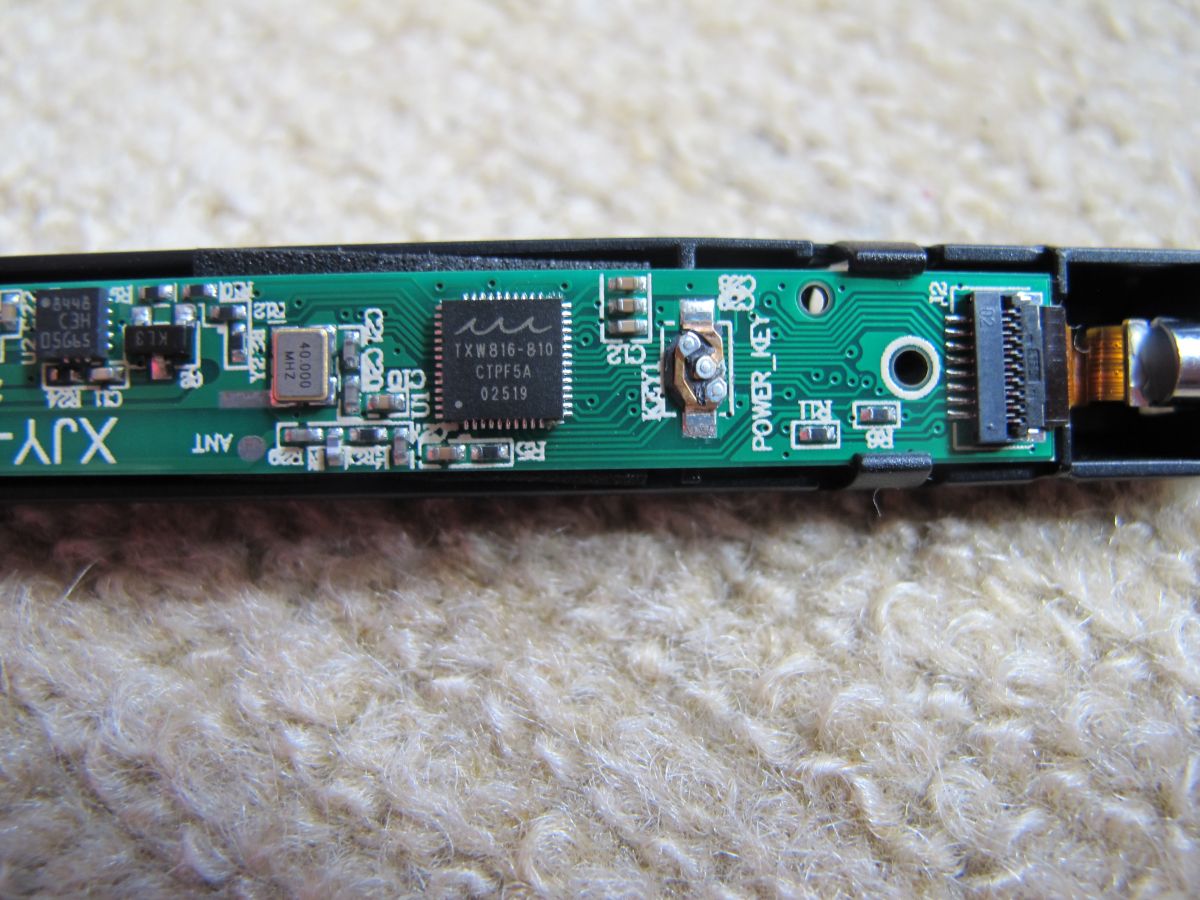

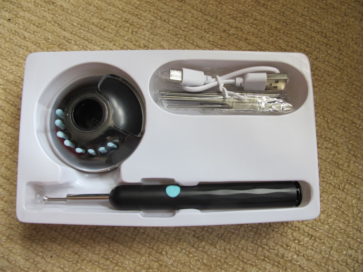

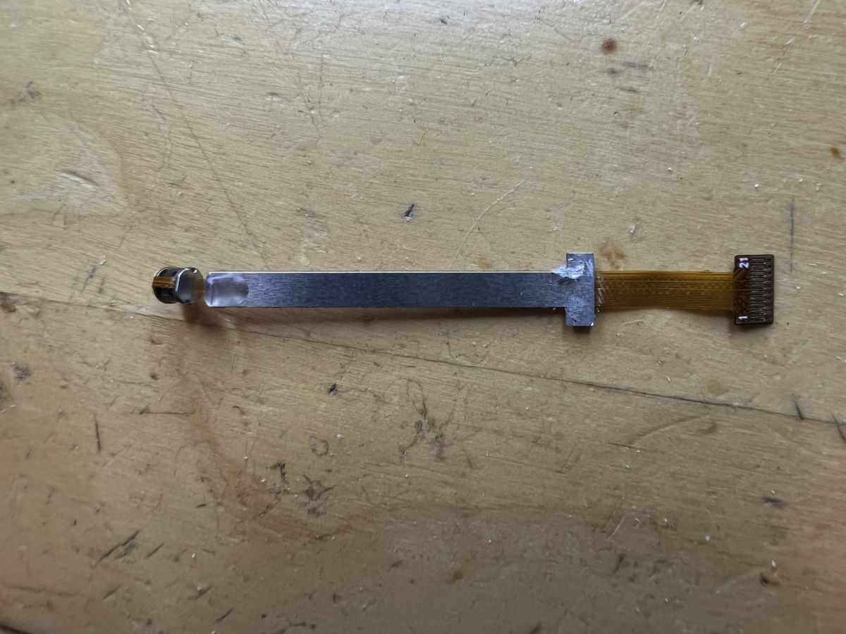

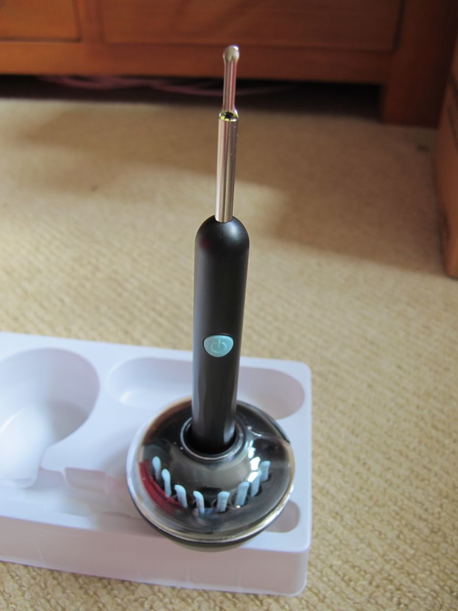

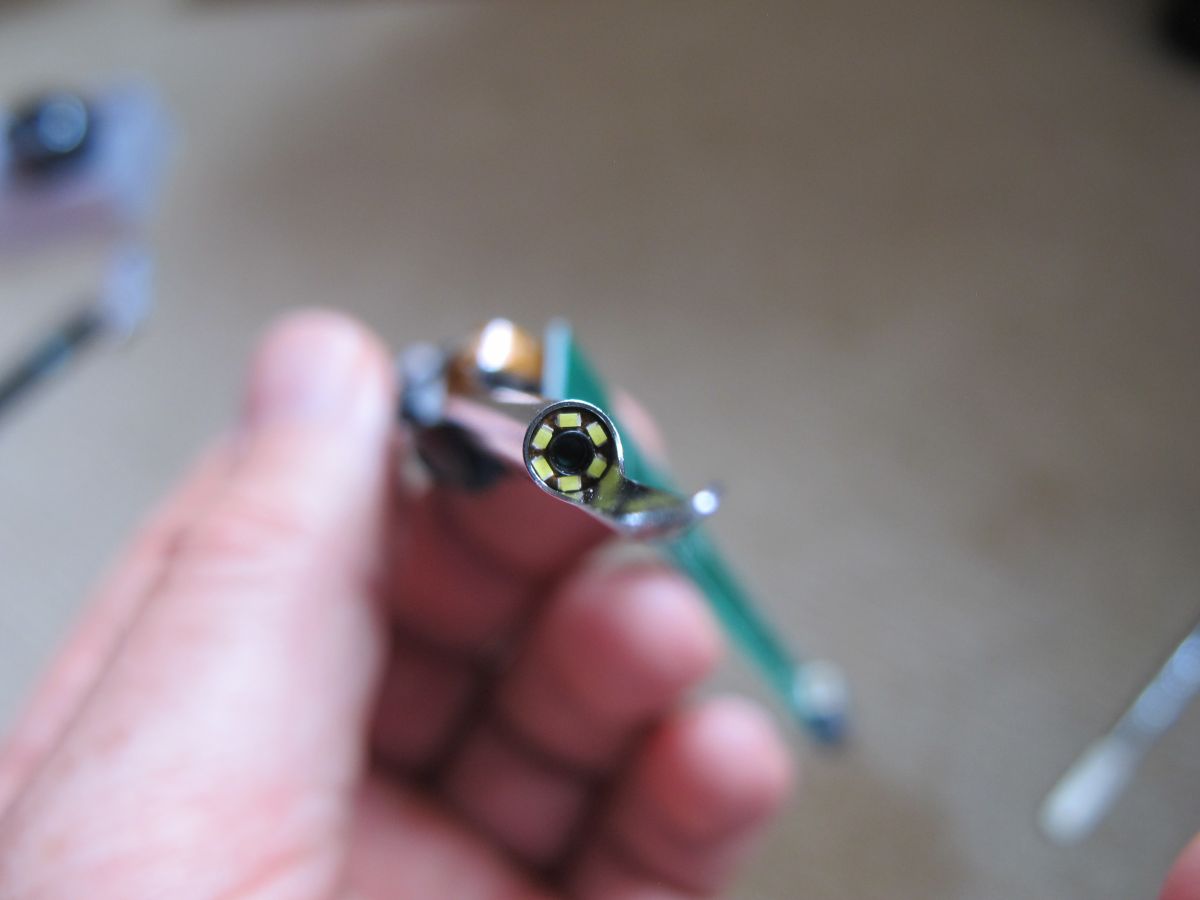

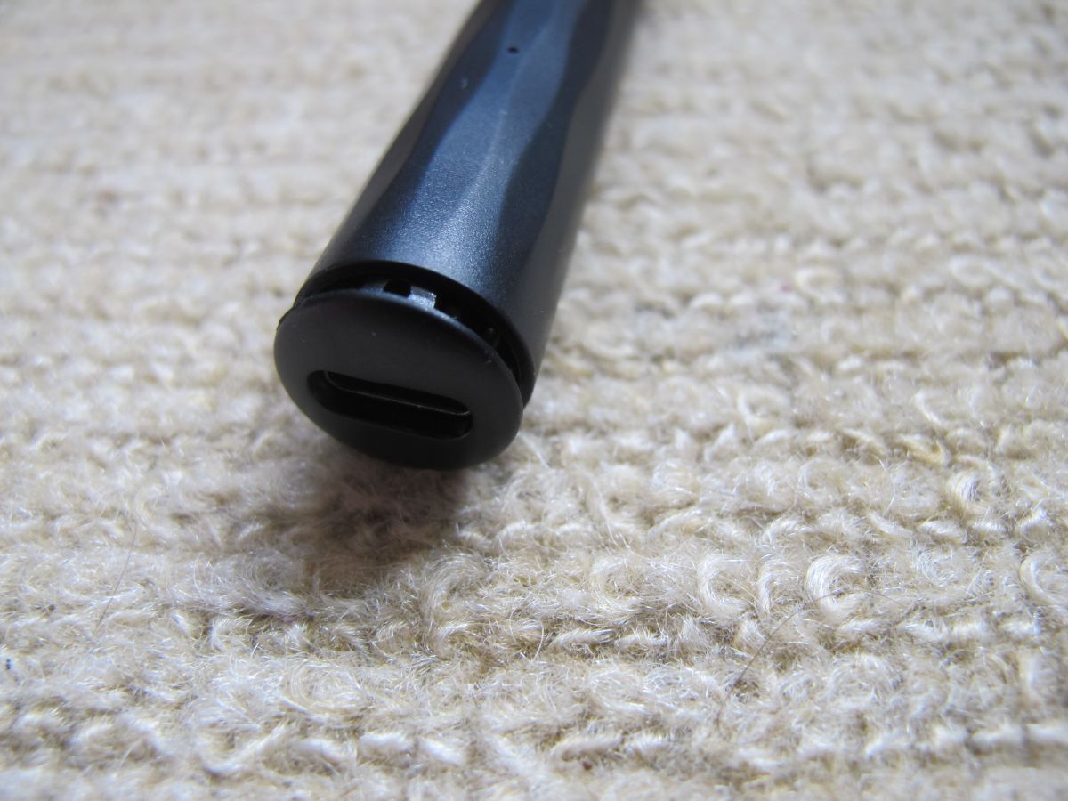

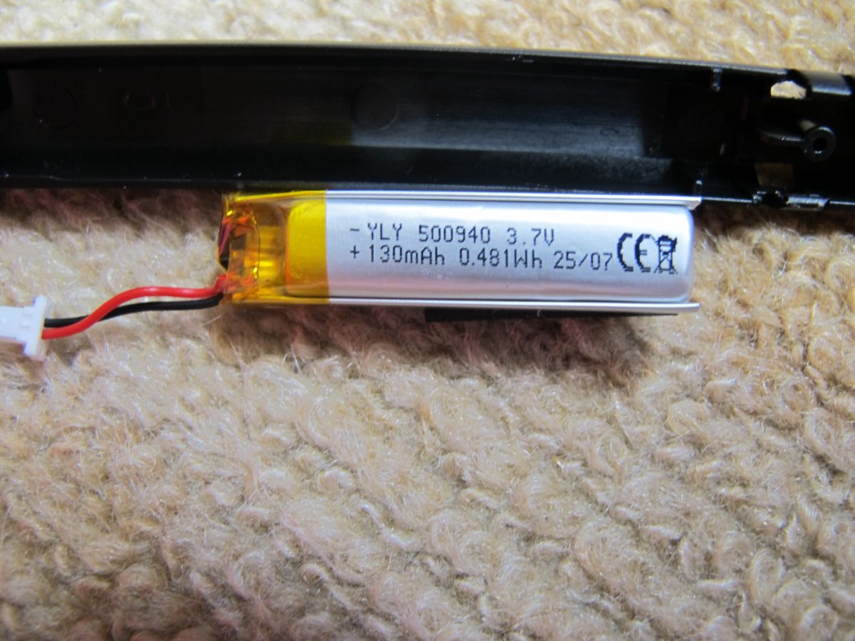

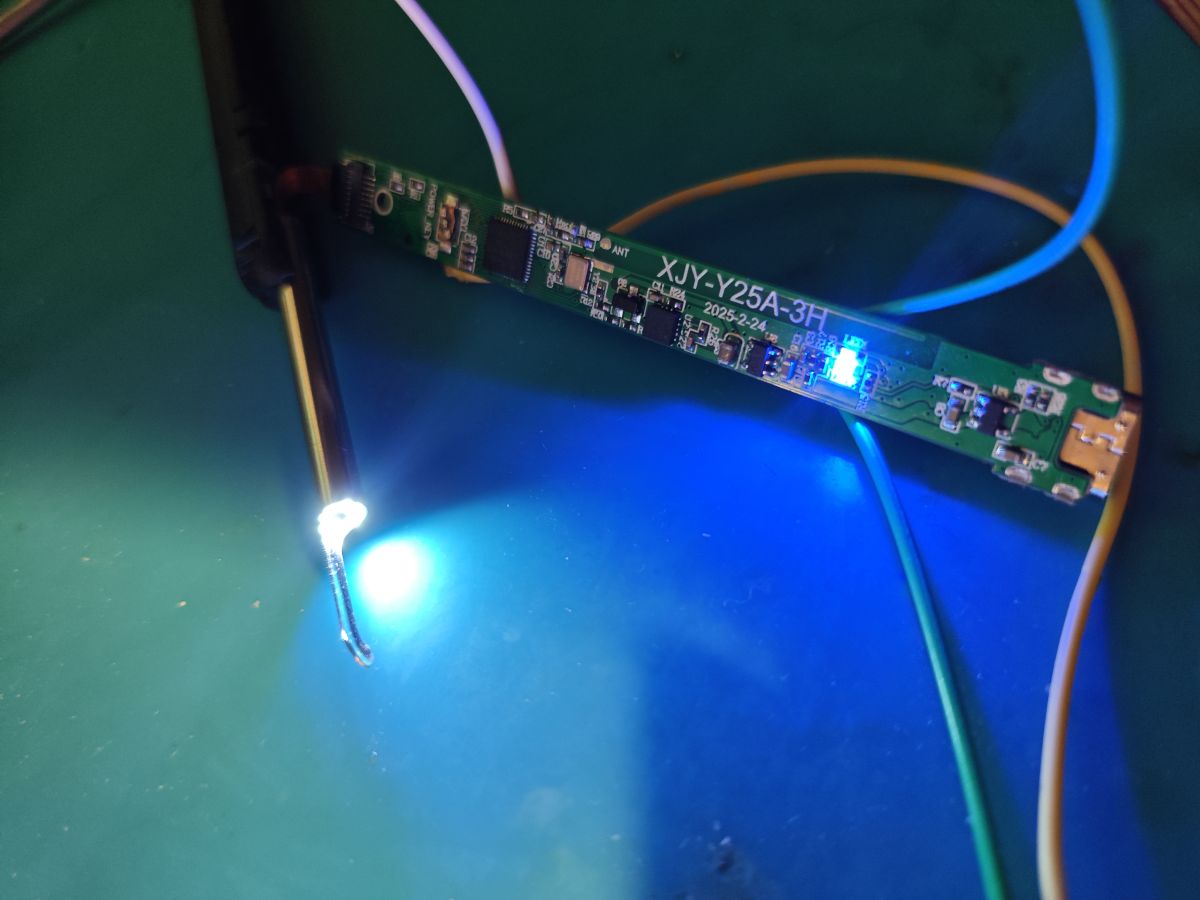

  • Recently it seems there has been a lot of cheap earwax remover otoscope devices popping up on amazon/aliexpress/tiktok shop similar to this:
    Taixen TXW816-810 based Otoscopes: UART Logs, PCB Pinout, Firmware dump

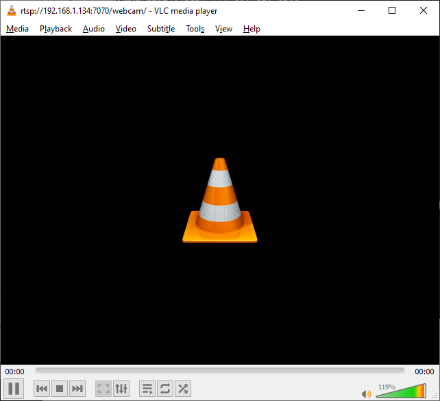

    When powered on, the button will start flashing slowly, as well as the light for the camera will turn on. After a few seconds it will start its wifi network usually with an ssid like "Soulear-ae45b" where it seems to be very generically "Company-uniq" as another device seems to show up as "Suear-4670". My device was broadcasting under the MAC of "88:17:89:0d:0e:b0" and had dhcp assigning IPs starting at 192.168.1.10 with itself at 192.168.1.1.
    Once connected on a phone, its app which seems to vary based on the device you pick up, but all of which are essentially identical, allows you to take video, pictures, switch ears from left/right, enable/disable the led, as well as switch between either wide/focused lenses or switch between "horizontal" and "mirror(?)". Some also seem to have a lock icon which I'm not sure what does.

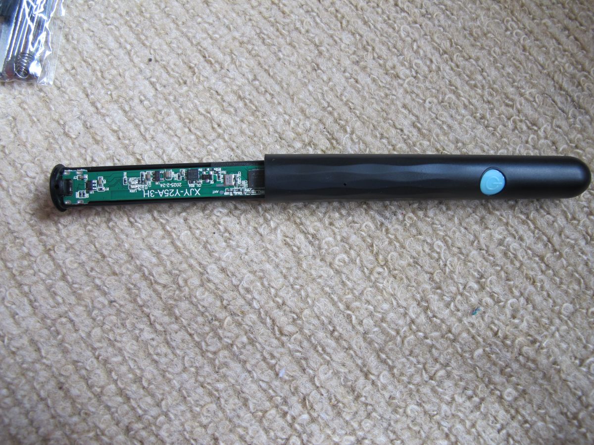

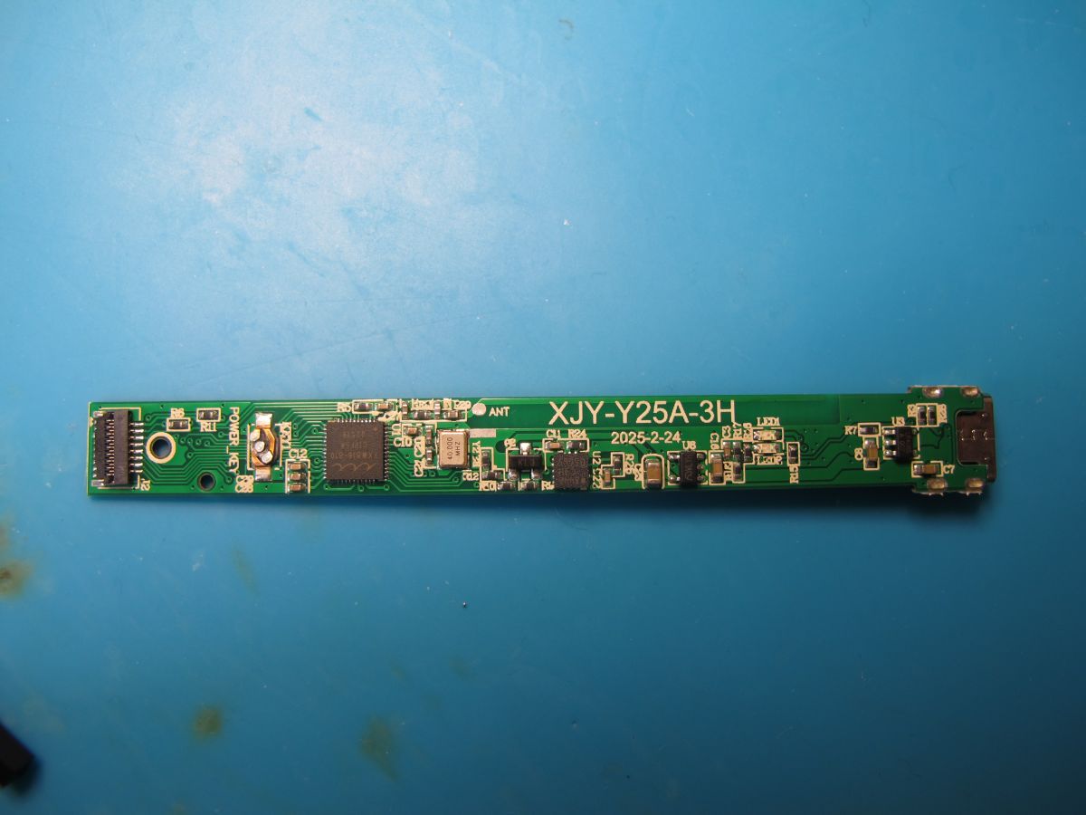

    They're very difficult to get into, and from what I can tell can't be gotten into without breaking the plastic in some way. If you're opting to take it apart and keep it looking nice, I think my approach would be cutting the seam or maybe heat or something to remove the glue holding it in. Once in, you're greeted by a 21(?) pin connector for the leds + camera, 2.7V 170mAh battery, and the main pcb. PCB has a few pads exposed, of which I may have torn off CE and CLK 😬:
    - 3.3V + GND (from mcu)
    - 5V + GND (from usb, although GND is shared)
    - CE (CHIP_EN)
    - DP (PC6, This is UART TX, RX is not exposed)
    - CLK (PA10, TCLK)
    - TMS (PA9)
    - PA8 (USB_DET?)

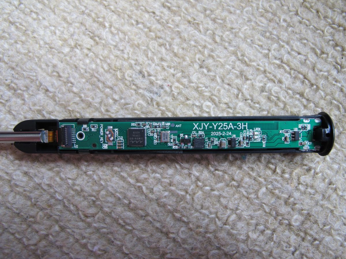

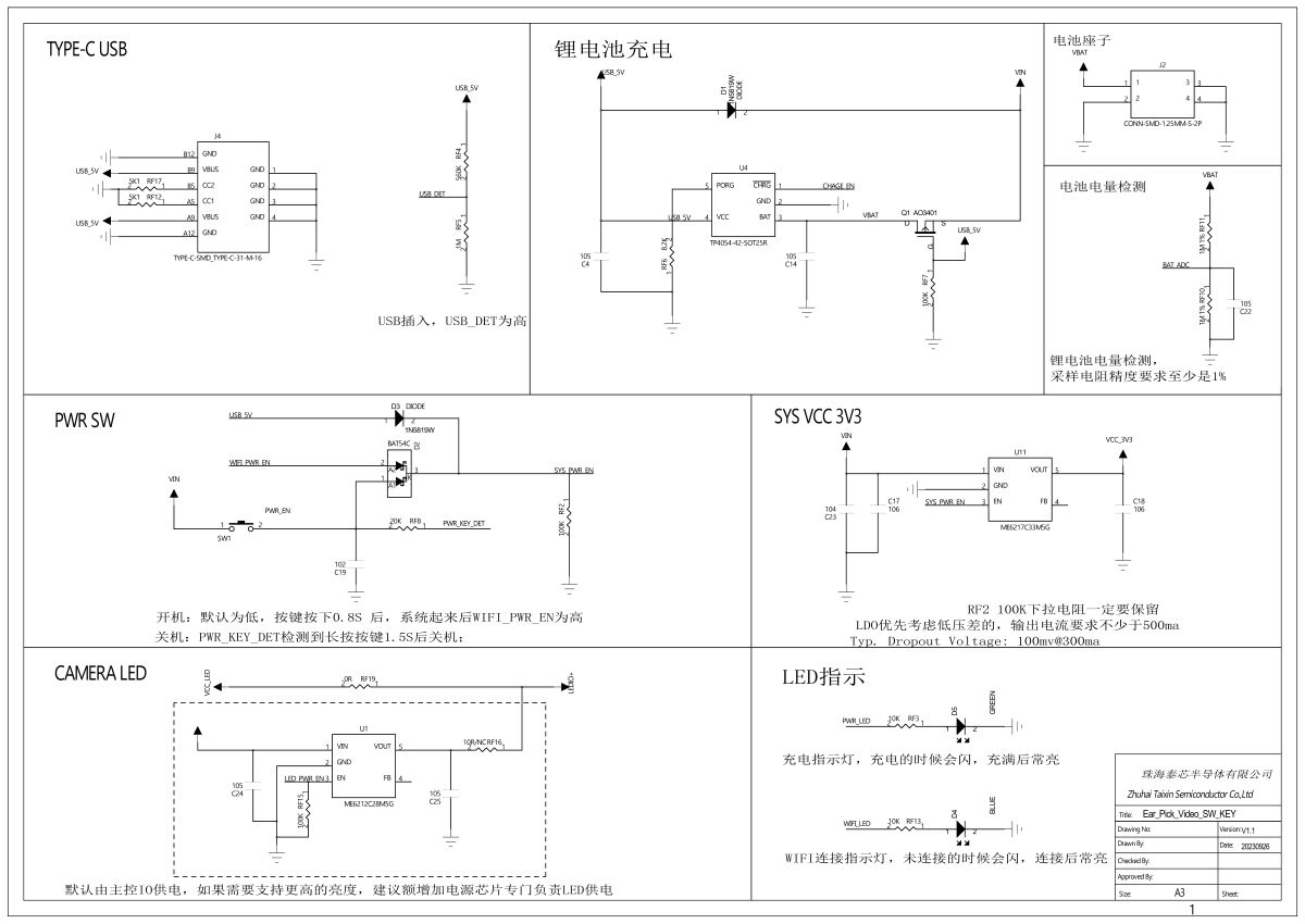

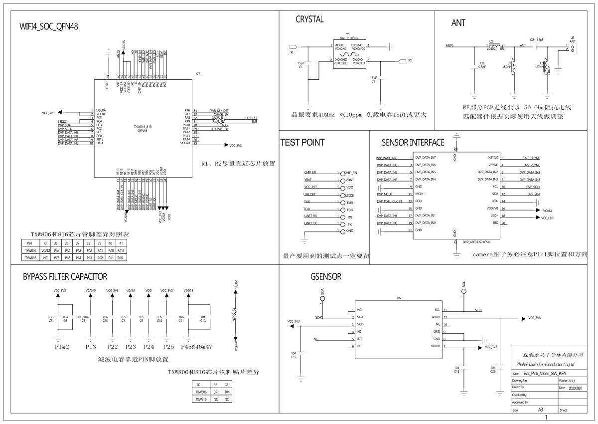

    These (mine at least) seem to be using the Taixen TXW816-810 which has been seen similarly with the A9 minicams seen here.
    UART Logs
    startup:

    14:06:55.075 -> [0]validity: 1579f00d
    14:06:55.076 -> ** hgSDK-v2.5.0.7-25841, app-0, build time:Dec  5 2024 12:06:20 **
    14:06:55.077 -> **   libcore v2.5.0.7-26821, build time:Dec 21 2023 11:25:54
    14:06:55.077 -> **   libnetutils v2.5.0.7-26821, build time:Dec 21 2023 11:26:09
    14:06:55.078 -> **   libcommon v2.5.0.7-26821, build time:Dec 21 2023 11:25:58
    14:06:55.078 -> **   libosal v2.5.0.7-26821, build time:Dec 21 2023 11:25:53
    14:06:55.079 -> **   libatcmd v2.5.0.7-25927, build time:Nov  6 2023 16:23:19
    14:06:55.080 -> **   liblmac v2.5.0.7-26821, build time:Dec 21 2023 11:26:25
    14:06:55.081 -> **   libwifi v2.5.0.7-26821, build time:Dec 21 2023 11:26:38
    14:06:55.081 -> ------------------------------------------------------------------

    • Taixen TXW816-810 based Otoscopes: UART Logs, PCB Pinout, Firmware dump pcb_front.jpg (4.1 MB) You must be logged in to download this attachment.
    • Taixen TXW816-810 based Otoscopes: UART Logs, PCB Pinout, Firmware dump pcb_back.jpg (3.89 MB) You must be logged in to download this attachment.

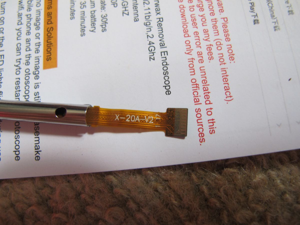

    hey. nice to see another Taixin MCU that isn't in a cam.
    regarding the flash read lengths, this does feel vaguely familiar, but I don't recall what I did, if anything, to make it no longer the case. Lower ICE Clk make any difference?
    Added after 7 [minutes]:
    maybe this means the cam is a Hynix HI708
    how many pins does the ribbon have and what is the full text on it?

  • Camera ribbon identified as SP1508B30-B with 21 pins
    #4 21601301
    eastarctica
    Rate: 8
    >>21600289 Wrote up a response yesterday but it my tab seems to have been slept and deleted so this is generally being rewritten again as well.
    Haha well it may not be one of those mini cams but it's still a camera ofc, definitely has some interesting features though... Hmmm, I can't find much info on the HI-708. All I could really find were some references to their "1.0μm Black Pearl" technology. Firmware only seems to mention "708" once in that same uart log so not a ton of luck there until I get a bit further access to it (mostly getting gdb working on it).
    I pulled apart the camera assembly which it seems that the camera ribbon pulls out of the metal housing without damage which is nice, images attached. Text on the ribbon is SP1508B30-B and it's got pins 1 through 21 labeled (21 pins total).
    >>21600564 Definitely an abstract use for an otoscope, I have to admit that I actually got the idea from someone on reddit and if we could get the firmware to use the vertical axis for the automatic rotation thing seen in that video it could be useful as some type of board imaging thing if you tossed it on a 3d printer gantry 🤔

    oh cool. didn't notice this.
    my one has arrived and I'm just photographing and capturing bits before posting about my findings
    also, would you be willing to share your device firmware?
    Added after 5 [hours] 34 [minutes]:
    Here it is. Same Taixin TXW816-810 1mb MCU.
    Taixen TXW816-810 based Otoscopes: UART Logs, PCB Pinout, Firmware dump Taixen TXW816-810 based Otoscopes: UART Logs, PCB Pinout, Firmware dump Taixen TXW816-810 based Otoscopes: UART Logs, PCB Pinout, Firmware dump Taixen TXW816-810 based Otoscopes: UART Logs, PCB Pinout, Firmware dump Taixen TXW816-810 based Otoscopes: UART Logs, PCB Pinout, Firmware dump Taixen TXW816-810 based Otoscopes: UART Logs, PCB Pinout, Firmware dump Taixen TXW816-810 based Otoscopes: UART Logs, PCB Pinout, Firmware dump Taixen TXW816-810 based Otoscopes: UART Logs, PCB Pinout, Firmware dump Taixen TXW816-810 based Otoscopes: UART Logs, PCB Pinout, Firmware dump Taixen TXW816-810 based Otoscopes: UART Logs, PCB Pinout, Firmware dump Taixen TXW816-810 based Otoscopes: UART Logs, PCB Pinout, Firmware dump Taixen TXW816-810 based Otoscopes: UART Logs, PCB Pinout, Firmware dump Taixen TXW816-810 based Otoscopes: UART Logs, PCB Pinout, Firmware dump Taixen TXW816-810 based Otoscopes: UART Logs, PCB Pinout, Firmware dump Taixen TXW816-810 based Otoscopes: UART Logs, PCB Pinout, Firmware dump
    TCK (PA10) -> STM32 A1
    TMS (PA9) -> STM32 A5
    T-head Debug CPU detection:

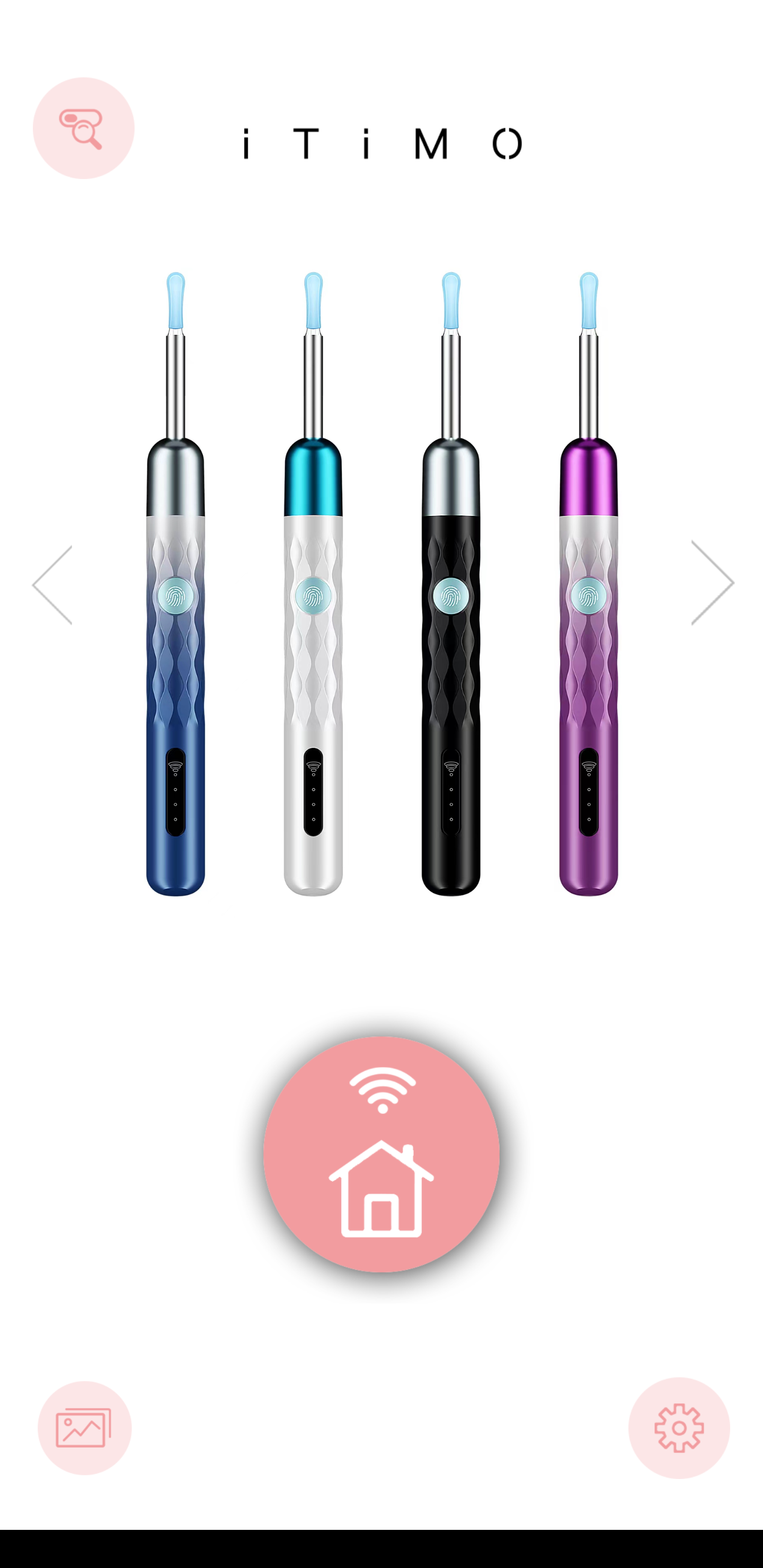

    The QR in the manual is for the iTiMo app from MoLink. We also see Molink referenced in the boot log along with the SSID broadcast to be joined by phone so the app cam stream from the camera
    https://play.google.com/store/apps/details?id=com.molink.john.itimo&hl=en_GB
    Backup was taken with CDK Flash Programmer. I had to hold power button down, same as in first post, which was difficult because I ripped off the button when opening the unit. Thinking about it though, there's a KEY pad on the PCB so that maybe could have been grounded instead.
    I don't see mention of the CMOS sensor in the boot log, though maybe it could be determined from the registers or other i2c stuff printed out.
    1mb dump: https://github.com/openshwprojects/FlashDumps/pull/38/files
    keywords:
    XJY-Y25A-3H
    Y8S-D-4.2mm
    Manufacturer: Dongguanshi Qianyu Electronic Technology Co.,Ltd
    Address: Room 501, Building 1, No. 50 Yantian Changtang Road, Fenggang Town, Dongguan City, Guangdong Province, China.
    • Taixen TXW816-810 based Otoscopes: UART Logs, PCB Pinout, Firmware dump IMG_0119.JPG (2.86 MB) You must be logged in to download this attachment.
    • Taixen TXW816-810 based Otoscopes: UART Logs, PCB Pinout, Firmware dump IMG_0118.JPG (2.98 MB) You must be logged in to download this attachment.
  • Firmware strings reveal TX816 Wi-Fi and BLE AT commands

    interesting strings
  • #8 21612280
    Posts: 14750
    Rate: 12866
    FWUPG update?

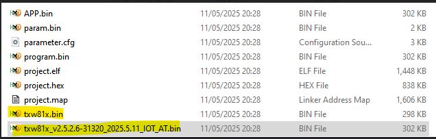

  • APK exports reveal firmware update functions
    #10 21613891
    eastarctica
    Rate: 8
    >>21611793 Nice job getting everything dumped and working! I apologize I had thought I added the firmware to my initial post but it's attached here. Diffing them they're slightly different. Notably, yours appears to be compiled with `hgSDK-v2.5.1.7-31060, app-0, build time:Mar 26 2025 15:41:31` versus mine with `hgSDK-v2.5.0.7-25841, app-0, build time:Dec 5 2024 12:06:20`
    >>21612344 There may be no mention of firmware updating in the app, but if you extract the android apk for mine at least, you'll get `com.i4season.bkCamera/lib/arm64-v8a/libWifiCamera.so` which has many interesting things... There's also `libI4Tool.so`, `libNetFrame.so`, and `libUStorageDeviceFS.so`, all of which I've attached.
    Notably these exports:

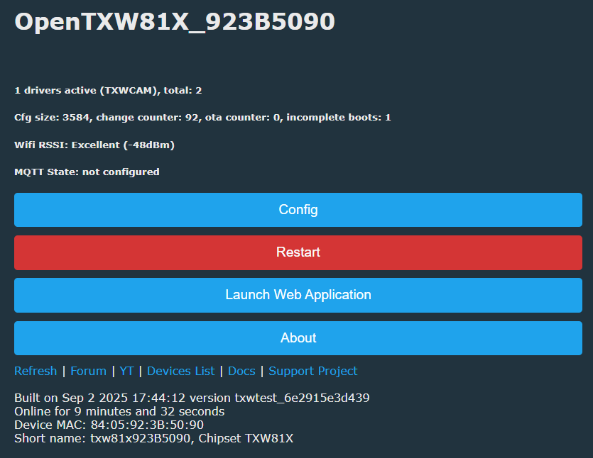

    OpenTXW81X_txwtest_6e2915e3d439.bin
    startdriver txwcam
    no rtsp video but a bit of static audio
    VLC media player window with a blank screen and a traffic cone icon in the center.

    Blue LED on PCB is PA00 and the LED ring around cam is PA11
    Illuminated electronic circuit board with connected wires and glowing LED light
    Device TXW81X configuration panel with TXWCAM driver active and restart button visible.

    txw816-810-ear-pick-video-sw-key-v1-1-20230926.pdf
    • txw816-810-ear-pick-video-sw-key-v1-1-20230926.pdf (82.26 KB) You must be logged in to download this attachment.
  • #15 21740399
    Posts: 5201
    Help: 446
    Rate: 914
    manual edit translation to English
    • EN_txw816-810-ear-pick-video-sw-key-v1-1-20230926.pdf (28.11 KB) You must be logged in to download this attachment.

  • The main PCB exposed pads included 3.3 V, 5 V, GND, CE, DP, CLK, TMS, and PA8; DP mapped to UART TX, while RX was not exposed. [#21600275]
  • The otoscope used a 2.7 V, 170 mAh battery and broadcast a Wi-Fi AP at 192.168.1.1, with DHCP leases starting at 192.168.1.10. [#21600275]
  • The camera flex was labeled SP1508B30-B and had 21 pins, numbered 1 through 21. [#21601301]
  • Two dumped stock firmware branches differed materially: one logged hgSDK-v2.5.0.7-25841 built Dec 5 2024, while another logged hgSDK-v2.5.1.7-31060 built Mar 26 2025. [#21613891]
