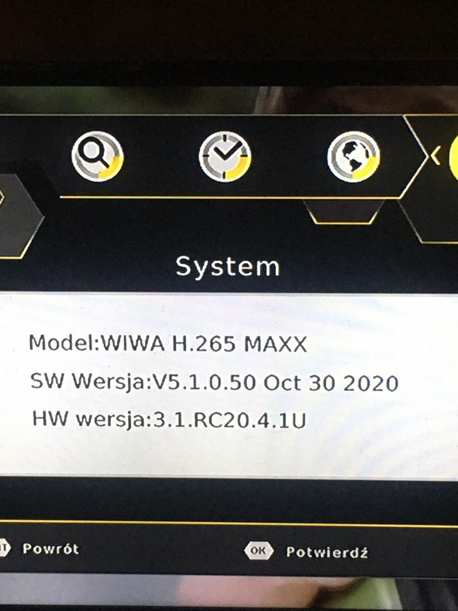

    Is there a new checked firmware for this decoder?
    WIWA MAXX New firmware - I would be grateful for the information
    Regards.

    Unfortunately, WIWA has never made any firmware available on its websites for ever. You have the option to contact wiwa serwis (generally helps) or check OTA update (Internet required)

  • OTA update is the only firmware source
    They used to make it available, but these are prehistoric times.
    This is not a problem, I have this option (LAN and WIWA USB WiFi adapter), but before using this option, I would prefer to find out from my colleagues if there is something new, proven, not necessarily from the manufacturer's side.

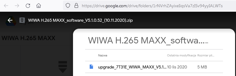

    My observations on these tuners ..
    Wiwy has many bugs in the software, the website is not eager to remove them. The last firmware was from November 2020
    The weather app no longer works on these tuners. Wiwy claims that the distributor turned it off. Youtube works once and fails. Internet applications can crash LITE and PRO tuners when trying to run them. WIWA MAXX has problems with the bars showing the duration of a given program from the beginning, once it shows no, in Pro and LITE it works well. All these tuners have a problem with the TIMESHIFT function (forcing the channel change when this function is active leads to the tuners being suspended) ..
    Various firmware found on the Internet. Files packed in zip format. You have to unpack it before uploading. Of course you upload at your own risk ..
    WIWA H265 lite - https://drive.google.com/drive/folders/10ScGAgbS24laCGUWKg8Wuv9Ib5fcjvHy
    WIWA H265 - https://drive.google.com/drive/folders/1wKFK07tsDC96GAUygScRsCtZYV6UCTvH
    WIWA H265 PRO - https://drive.google.com/drive/folders/1GqVUhLfVCQXC2-MY0ywo_ZiZDxF5llgt
    WIWA H265 MAXX - https://drive.google.com/drive/folders/1rNVrhZAyixeIiqsVa7zISv94yyIALWTs
    Instructions recommended by the WIWY service
    Factory reset must be performed before and after the update.
    So we start with:
    - press the "menu" button on the remote control.
    - select the "System" tab (gear)
    - choose "Restore factory settings"
    - password: 000000
    Next:
    - select "Software update" -> "USB update"
    After the update is complete, the decoder will reset itself. We restore
    reset to factory settings.

    @ 2 Tom How can I download this file ?: WIWA MAXX New firmware - I would be grateful for the information
    Successfully downloaded, I'll check it tomorrow and let you know.
    EDIT:
    Updated to version: ... 0.52 Nov 10 2020.
    The problem still remained (EPG and more).
    Thank you for your help.
    For now, I leave the topic open, maybe something new will appear in the meantime.
