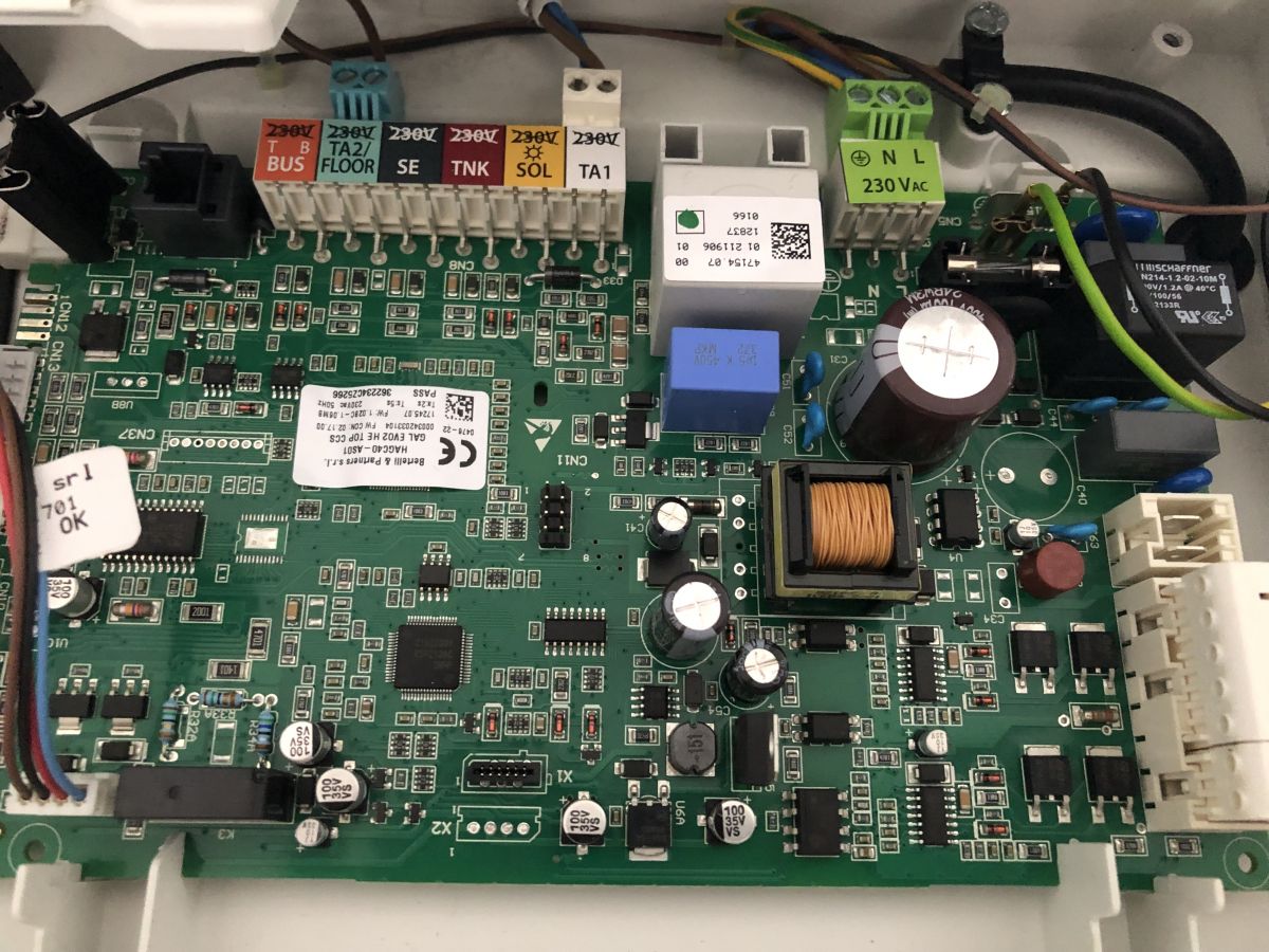

Check the gas-valve control section on the PCB, because the thread’s strongest consensus is that the real fault is usually there, not in the electrodes: cold solder joints and overheated parts around the valve driver cause 5P3/5P6/501/309 errors [#21457047] [#21514914] The most frequently implicated parts are the two BCP53-16 transistors, the nearby 15 Ω and 5.6 Ω resistors, and the Omron/Panasonic relay; several users reported success after resoldering or replacing those parts and then running the automatic calibration again [#21302064] [#20848591] [#21307114] One user also found that replacing only the BCP53-16s with higher-power BD140-16 parts and adding small heatsinks made the boiler run normally [#21354432] A small capacitor in parallel with the gas valve solenoid was also discussed, but results were mixed; it was sometimes changed to 1 nF, 10 nF, or 22 nF, and later posts suggest it is less important than the overheated solder joints and driver parts [#19944123] [#20002037] [#21356948] If the board still misbehaves after rework, some users ended up replacing the whole PCB, but the best repair evidence in the thread points first to resoldering/replacing the valve-driver components and checking for cracked joints under heat [#20457047] [#21514914]

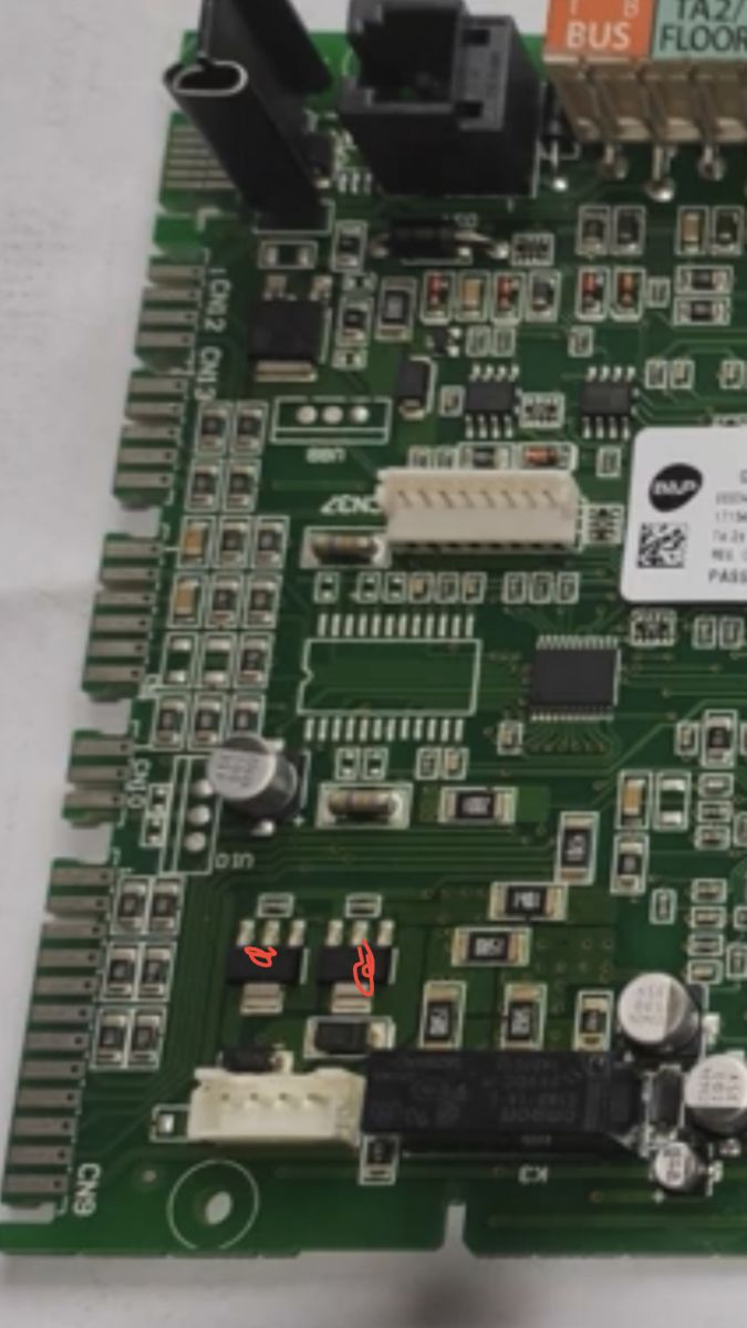

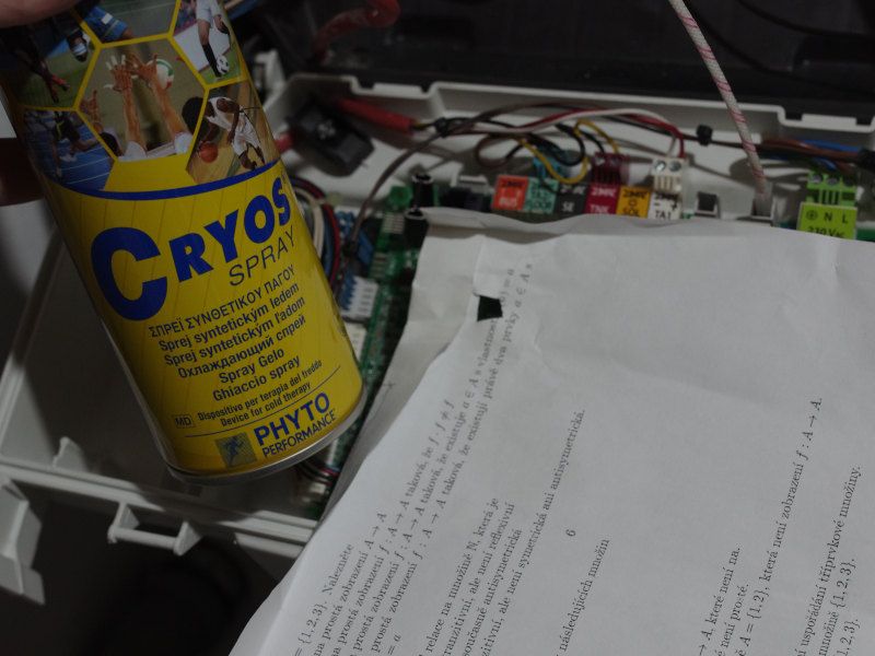

    adamskyyy666 wrote:
    Do you also have the same?
    Definitely. I bought a cooling spray (Propane-Butane-Isobutane). When you spray on the circuit, the fire is gone...
    See the picture. I created a hole in a paper to minimize the impact of the spray. I thought I found the culprit as it was fixed immediately after resoldering one of the resistors (R3 on my circuit posted earlier). It was OK for 3 weeks, but I've got two errors last week again.
    Maybe I'll try to replace the resistor completely later. But it's warm in here, so the boiler doesn't run so often and as you say, it doesn't happen when it's warm.
    In any way I was told that it should be caused by some failing semiconductor. The resistor is unlikely the cause. But who knows...

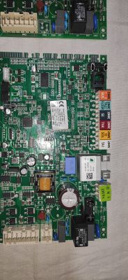

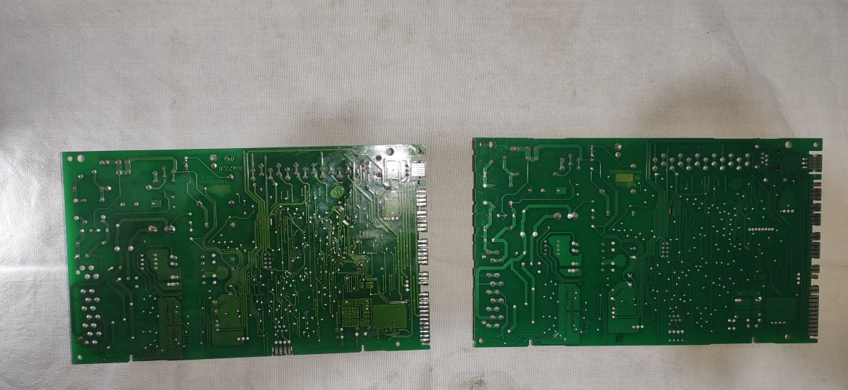

    Hello, I bought a new board, there are some differences from the old PCB, SMD resistors are replaced, new firmware. Board works perfectly, for now. 280€. I decided to no more waste time with this. I wish you good luck to find out the problem on this damn PCB.
    Thanks for this! Do I see correctly that they replaced those 15r by 1r5 (brown green black silver)? That would be more negative voltage to pin 2 (negative voltage for the valve).

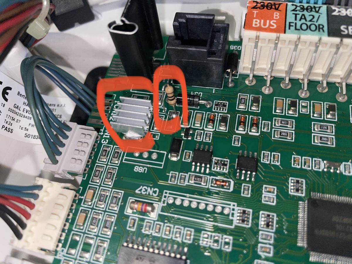

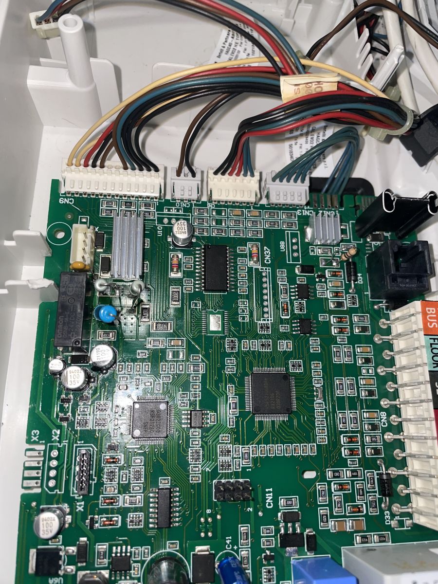

    Hi guys. I have read the entire branch of this problem. I have a problem with the boiler for the second time, 1.5 years ago I replaced the board, but after a year and a half the problem appeared with a new board. I didn't want to buy the board for the second time and decided to find the reason. Ariston Russia also could not solve the problem and could only offer to replace the board with a new one, and the warranty period has already passed. Therefore, I did not want to pay for a new fee a second time.
    After reading all the tips and recommendations, I did the following.
    1) replaced the ceramic SMD capacitor with a disk ceramic capacitor instead of 1nF put 22nF.
    2) replaced 4 SMD resistors with metal resistors with the ability to allocate 1-2 watts of heat, I left the same ratings that were on the board 1 resistor at 10 ohms, 2 resistors at 15 ohms and 1 resistor at 5.6 ohms. These 4 resistors are very hot and they should be replaced in principle, it is also not necessary to solder the SMD options - they heat the board in the places of soldering during the operation of the gas relay.
    3) I glued aluminum radiators on the LM317M and two adjacent bipolar transistors BCP53-16 to the thermally conductive glue. As the gas relay turns on, these parts get very hot more than 60 degrees Celsius, and I think if they work in this mode for several years with a closed case and a boiler lid, they become unusable when heated.
    4) I also soldered 3 chips processor, memory and something else, just to dispel assumptions about cold contact.
    5) I also hung a ferrite filter on the wiring of the gas relay (I don't know if it helped, but it definitely didn't get worse).
    The conclusion of these actions was the following: at first the board did not want to start, but it turned out that it was necessary to clean it from traces of soldering and soldering flux. Errors 5P3/5P6/501 have stopped appearing altogether. It turned out to finish the calibration of the burner by opening 2 or more hot taps at the time of calibration of the burner (in order to remove the generated heat). Previously, I often had these errors of ignition and flame extinguishing. The whole problem is in the board, no mechanical influences will lead to a solution to the problem. Try to do the same as me, I think I have found a solution to the problems with this board by removing the overheating of the chips and parts, as well as replacing the resistors and capacitor with unused and not overheating earlier. By the way, I first put the capacitor on 1nF, but this was not enough and errors still did not appear so often, but still did not completely go away. So put the capacitor on 22nF, the board works with it, and also I don't get an error with it about checking the gas relay.
    After completing all the actions, I went to menu 234, then selected item 280 and reset the boiler settings to factory settings and started the automatic calibration function of the boiler.
    Also, the boiler stopped making pops at the moment of ignition of the flame, previously there were very bad and loud pops.

    So after a year of back and forth, it looks like replacing (only) the valve-controlling transistor (BCP53-16) did the trick. It's marked as Q1 in my earlier drawing. 2 weeks, no more errors.

    I agree with you, the problem is two transistors. My second board broke (the fan started working like crazy and there was an error related to the fan, but it is fully operational). I soldered these two transistors onto my first broken board and the ignition problem went away from the very first start. Transistors are always hot and lose their physical properties over time.

  • #51 20915494
    jirislaby
    Posts: 15
    Rate: 14
    Yes, replacing the left one (smaller red dot/drawing on your photo) should do the trick. It controls the regulation valve.
    The right one (and the relay at the bottom) controls the other -- open/close valve. No need to change them, if that valve works correctly.

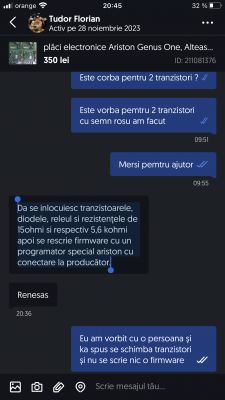

    Can you tell me if after replacing the transistor, is it necessary to firmware the PCB? Some people told me that I need to reprogram the PCB with Renesas and connect it to the company. Is this true or not? Some electronics experts here in Romania told me this, but maybe they are lying. Here is the message from one of them:
    Yes, the transistors, diodes, relay, and 15 ohm and 5.6 kohm resistors are replaced. Then the firmware is rewritten with a special Ariston programmer connected to the manufacturer. Here is a picture of the chat with him: Screenshot of a text conversation about replacing electronic components.
  • #55 20917085
    jirislaby
    Posts: 15
    Rate: 14
    It's bullshit. You only may need to recalibrate. But the heater recalibrates on its own from time to time, IMO.

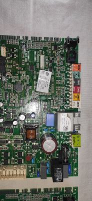

    geri1980
    Posts: 6
    Image of a PCB board with various electronic components. Thank you, my friend. I know this is stupid. I'm an electrician from Romania, and I'm not Romanian, but I'm living here. Maybe he likes me like this because I told him it's only the transistor for that. It's a secret here because he lost a client. :)
    Added after 34 [minutes]:
    >>20917085
    I'm interested in the simple problem with the transistors as you say. I don't have the board with me right now because I'm not at home, so I asked you what the problem would be to repair the board. Thank you for your help, sir. I mean, the problem with this board is those the two transistors is safe.
    Added after 4 [hours] 21 [minutes]:
    >>20917085
    My boiler have new pcg Board here i have new image os this Board have same problem like the old pcb?

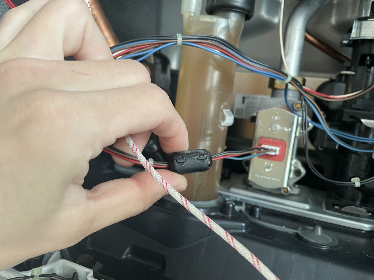

    Guys, I had a slightly different issue ending up in this 5p3 (I hate this stove, I spent so much time with it already). Inside the gas valve, the ferrite kernel was out of the rod. Hence it was shifted by 2-3 mm, so the stove was not working in the middle and low power. And note, there is another guy who had a bumper out of the other rod: https://www.youtube.com/watch?v=VxaRm1dBhKo
    So when dealing with this error: first, I would check the ignition. Then I would smell if there is any gas flowing into the stove at all (having ignition still out of the stove). If that is OK and it is still dying, I would replace the capacitor, and then I would replace the transistors (and add heaters) and resistors. Maybe we should replace the transistors with some to-220-sized ones or something.
