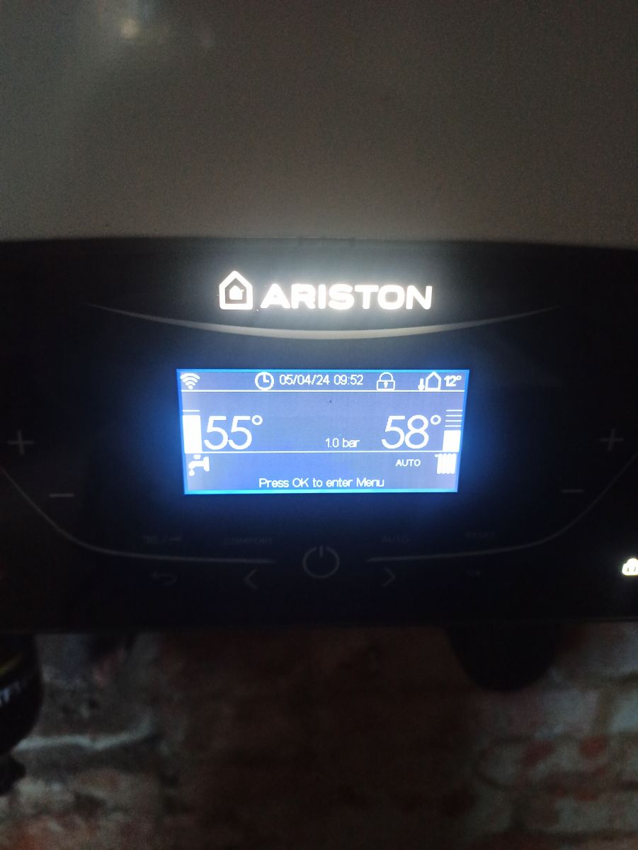

    Please send a photo of your stove screen. Do you have a room controller?
  • #63 21033317
    ajdahabjanic
    Room controller, you mean like screen on the wall that is connected to the appliance? I do have that. Ariston room controller screen displaying temperatures of 55°C and 58°C.
  • #64 21034939
    madyd
    Level 20  
    Posts: 283
    Help: 34
    Rate: 89
    And that sound that bothers you is there all the time? Looking at the photo you sent, the pump in the furnace should not be working. There isn`t really anything else that could make any noise. When the front casing is removed, the LED on the pump does not light up?

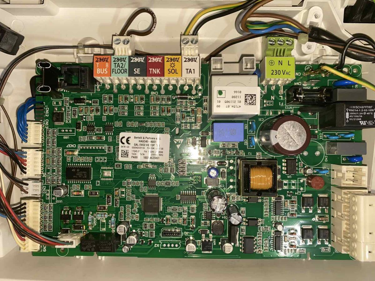

    Greetings! I have this new type of motherboard, the error codes 5p3, 5p6, 504 also appeared, what is the solution for this? Could BCP53-16 be the culprit?
    Close-up of a motherboard with numerous connectors and electronic components.
  • #67 21100687
    jirislaby
    Posts: 15
    Rate: 14
    >>21097725
    Have you read the whole thread? I think it answers the question already.
  • #68 21100743
    professionalhunter1
    Posts: 6
    of course I read it, but this is the new version of the motherboard, so in theory the error has already been fixed

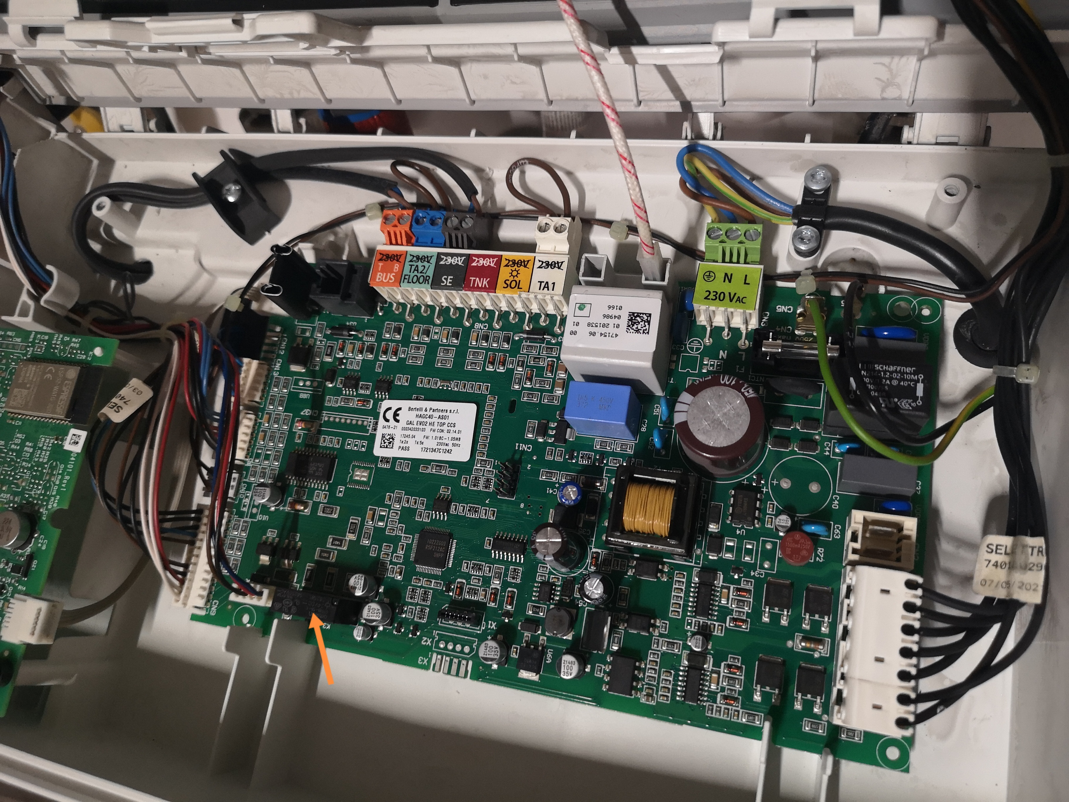

    The boiler is 3 years old, errors 5p3, 5p6, 501 started to appear. Replacing the relay supplying power to the gas valve helped.

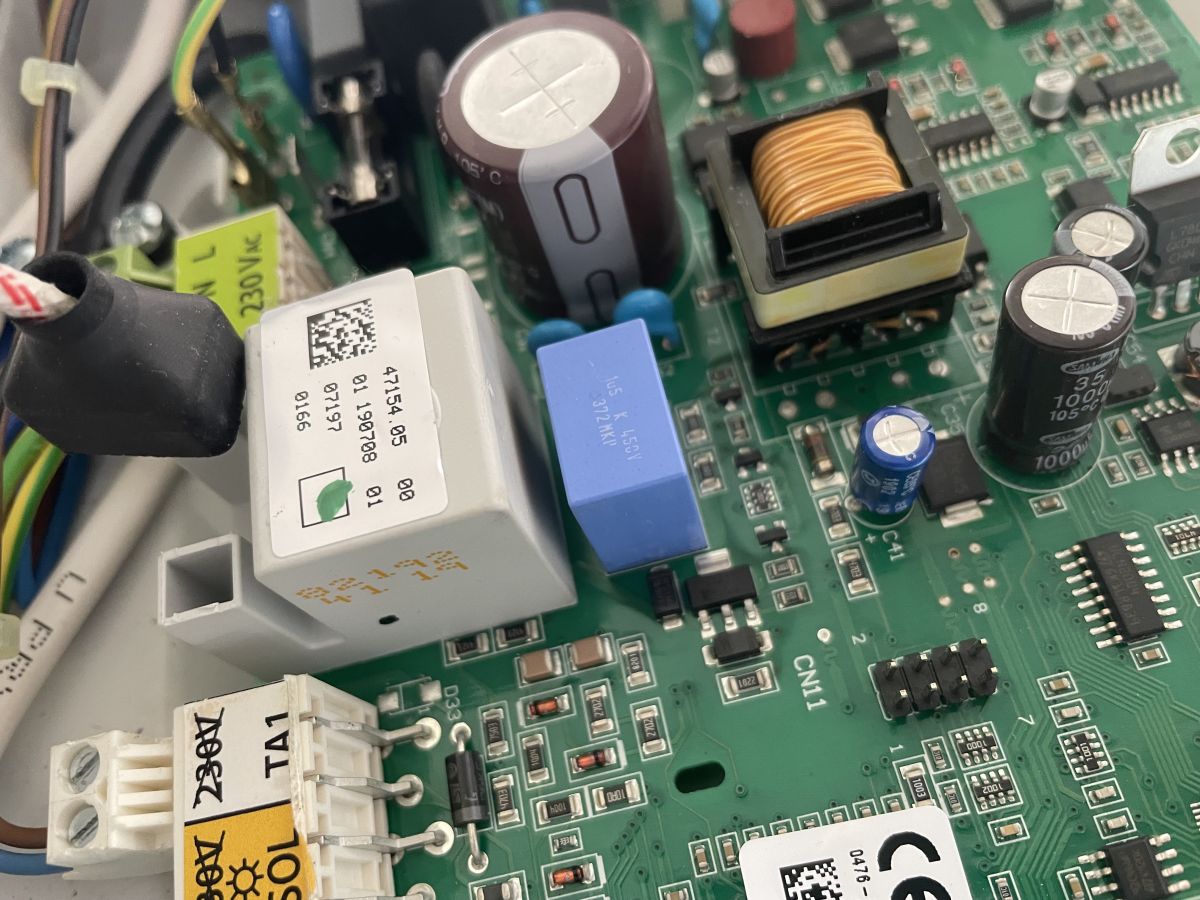

    Today I've checked the ignition circuit from this picture:
    Close-up of a circuit board with various electronic components.
    and I notice that a diode is broken(the one in the shadow of the capacitor) then I read some articles related to the 'spark ignition with Thyristor' and there are mentioning that capacitor(in our case the 1,5 microfarad/450v and the RS1M should be replaced in order to have good ignition.

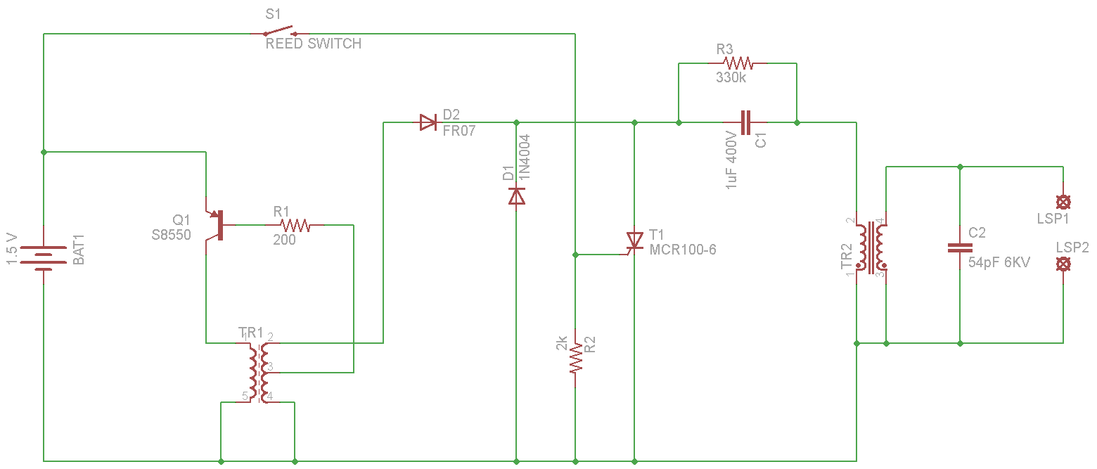

    schematics is similar to this:
    Ignition circuit schematic with electronic components such as diodes, capacitors, and resistors.
    and the C1 and D1 have to be replaced.
    I ordered the 2 components and after I will replace them I will come back with conclusions.

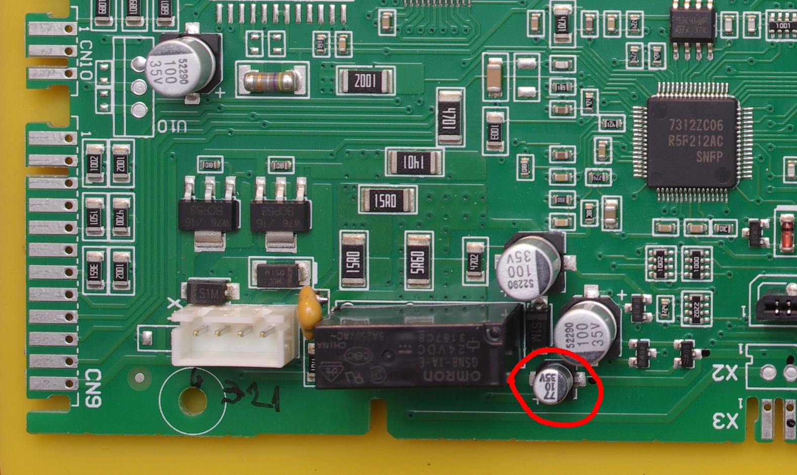

  • #80 21298312

    Hi As I wrote above the ordered parts have arrived. I replaced on the board 2x BCP53-16 and next to it the relay 24VCC/5A (I bought Panasonic with the same parameters), I checked the resistors next to them and the parameters were OK so I only corrected the solders on them because at them from the bottom the board heated up the most. I checked the capacitor values and they were also OK, so I did not replace them. After reconnecting the board and automatic calibration, the furnace has been working since Thursday without a stutter and no more errors, it runs until nice (THE COST IS SOME PLN15). Also, in my opinion, with the errors (fan error, blown flame, no flame), replacing these regulators solved the problem, as you wrote above.
    The only thing that still puzzles me is that 1nF capacitor because it had its parameters and I didn't move it, but somewhere above you wrote to put 22nF but is there a point? will it change anything? MAYBE THE BOARD WILL NOT HEAT UP SO MUCH WITH THESE RESISTORS?

    today I replaced on the board 2x BCP53-16 and next to it the Omron relay 24VCC/5A. Everything is running fine. Re-calibrated the device, and now it's working. Thank you for the tips!

    Hi, the relay is not the problem. In the picture I circled a capacitor. Replace it, it can also be with legs "through hole" and soldered to the surface. The capacity can be a little greater than 10µF, the voltage must be greater than 35V. This smooths the voltage to the gas valve transistors.
