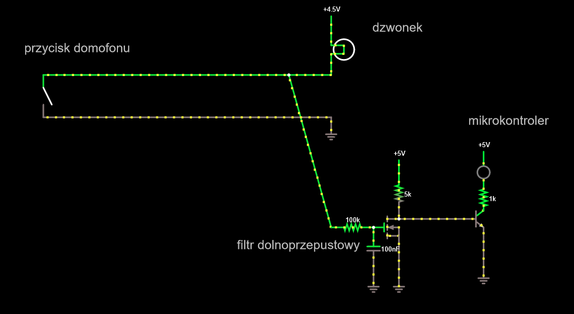

    I have a video intercom where 4 wires go. I wanted to detect pressing the bell and sending data over the mqtt further. I found 2 wires that short together when someone presses the bell only question arises.
    I want to detect this from another chip (ESP8266), on 2 of these wires I have 4.5v with a multimeter I measured that the button simply short circuits the state line to GND.
    What is the best way to detect a low state from an Arduino or similar?
    I have a couple of ideas.
    - transistor on the line esp
    - measuring the voltage on the line analogue
    - a common ground and a resistor to check the high state.
    Please direct me on the right track.

    Optocoupler. There is probably also an audio signal on 4 and shorting it to anything will distort the conversation. Additionally, there will be full galvanic isolation between the devices.

    If the button is short-circuiting to ground and sound is flowing through there during a conversation, it is a good idea to detect the button press with a circuit with a high input impedance and a low-pass filter (which does not pass sound) at the input. You have an example of a mosfet solution here:
    Detecting Pressed Call Button on Video Intercom with ESP8266 .
    simulation .
