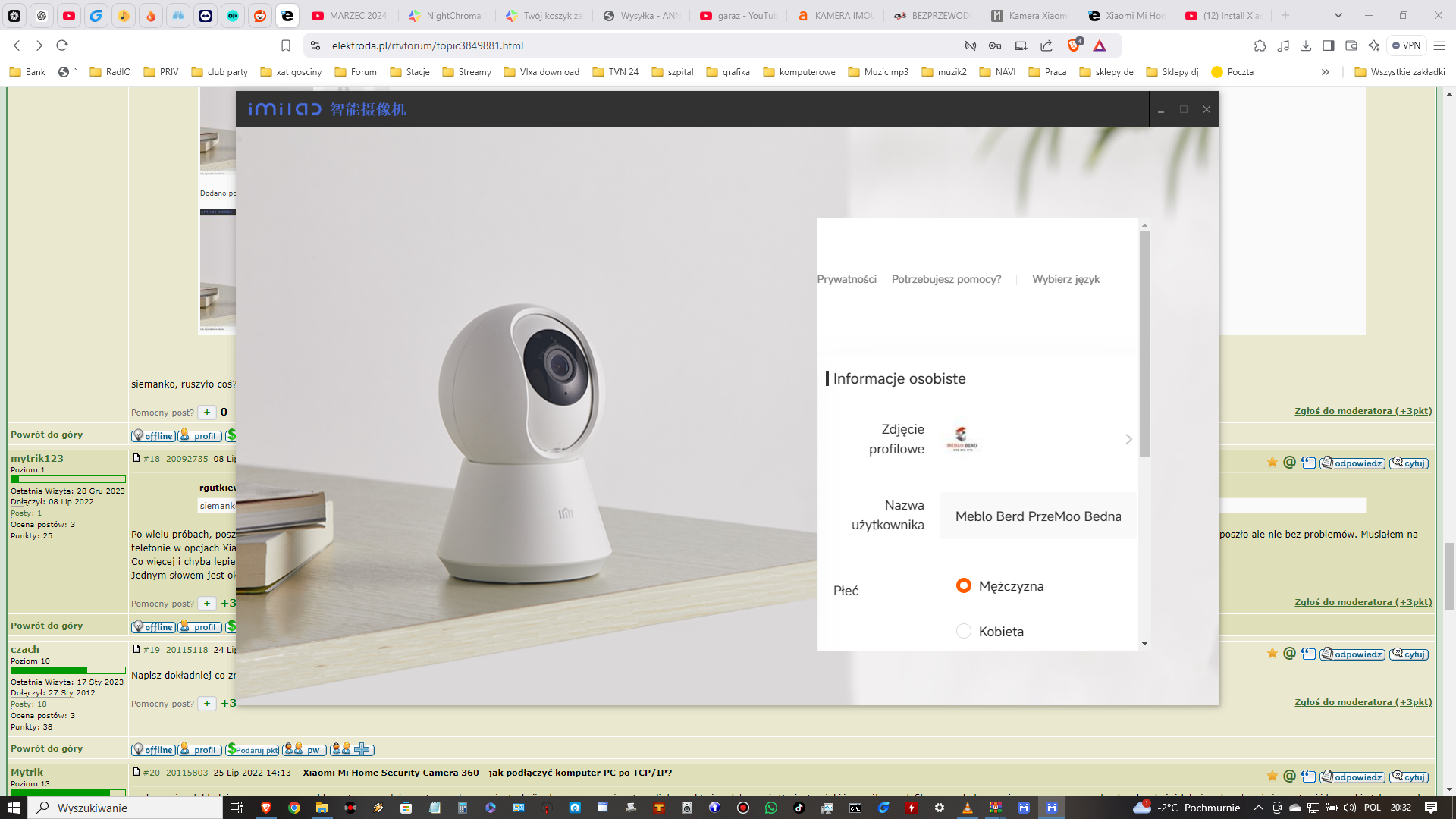

    Hi, I have the same problem at my place, I logged in and nothing happens, the program doesn't start.
    Screenshot showing a forum page discussing issues with a security camera.
    and I do not know where the problem is
