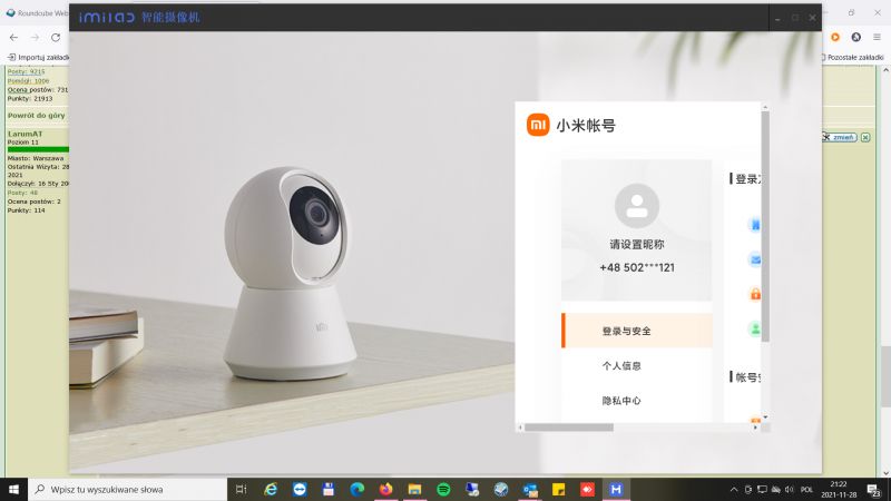

    #10 19734672
    LarumAT
    Posts: 70
    Rate: 7
    I did not expect the installation in Chinese. Maybe you can tell me which hangers I should click on.
    Added after 3 [minutes]:
    Xiaomi Mi Home Security Camera 360 how to connect to a PC via TCP/IP
    As for rtsp, how much do you have to play? I know the IP address of this webcam.
    Added after 7 [minutes]:
    the next window after logging in looks like this.
  • #12 19734763
    gradek83
    Posts: 9107
    Help: 930
    Rate: 2103
    You log in to your Mi account and they send an activation number to your phone.
    Install on your smartphone google translate and select chinese and the camera icon and hover over the text it will translate for you on the fly.

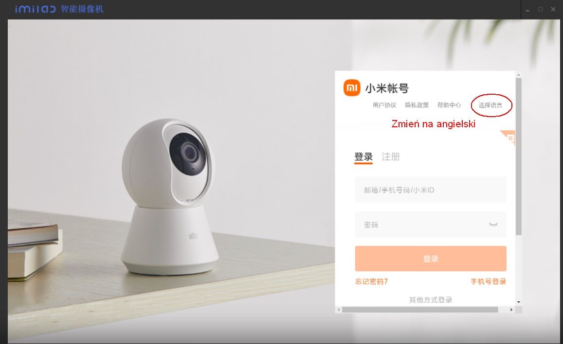

  • #13 19734767
    LarumAT
    Posts: 70
    Rate: 7
    It didn't occur to me.
  • #14 19734770
    gradek83
    Posts: 9107
    Help: 930
    Rate: 2103
    Or change to English. Xiaomi Mi Home Security Camera 360 how to connect to a PC via TCP/IP
  • #15 19734818
    LarumAT
    Posts: 70
    Rate: 7
    Here I managed, but the next window rather concerns the account itself and not the installation of the program.
    Added after 57 [seconds]:
  • #16 19734876
    gradek83
    Posts: 9107
    Help: 930
    Rate: 2103
    If you speak English, use the English to Polish translator. Complete the account settings, set security, etc. and the program should start.
