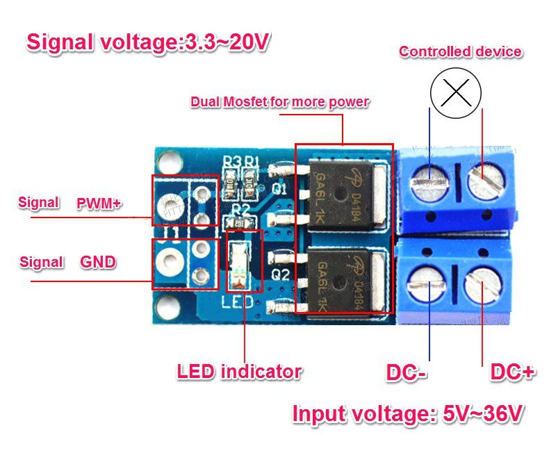

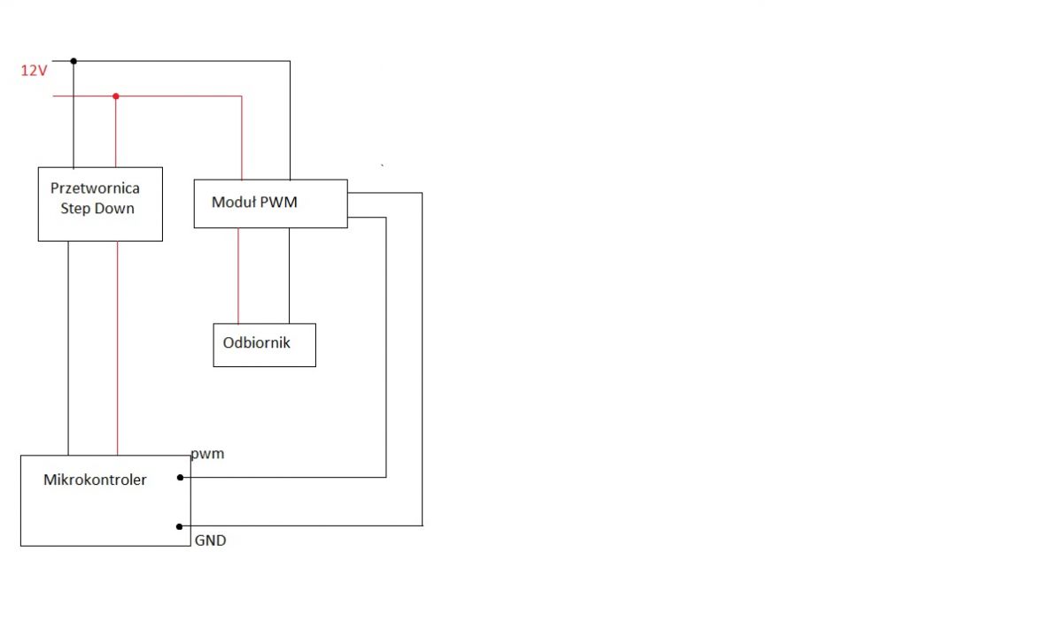

    Has anyone perhaps encountered the case that when I feed a PWM signal to a module (or MOSFET), I always get the full voltage at the output regardless of the PWM fill given? The PWM signal is applied correctly - I checked with a multimeter. The voltage and frequencies agree. This happens regardless of the amplitude of 0 - 3.3V or 0 - 5V. To make it funnier, when I constructed my father an aquarium lamp controlled by PWM via current drivers it all worked correctly. I am attaching an overview diagram and would appreciate any hints. Why is it that when a PWM signal is applied to the module, full voltage appears at the output? .

    To the author, it would be good to show a wiring diagram including the type of transistor, if you don't have an oscilloscope then instead of a MOSFET connect a bipolar one without a lamp with some resistor in the hundreds of ohms to the base and a similar one in the load and then check with a multimeter if it responds to PWM.
    You can also reduce the frequency in the ESP for testing.
    Added after 4 [minutes]: .
    Aaa, one more thing: see the schematic of your ESP board, if there is no filter on the PWM output in the form of a capacitor with a resistor.

    In my case it is a frequency of 1kHz. I use a ready-made module consisting of 2 MOSFETs designed for just such things: Why is it that when a PWM signal is applied to the module, full voltage appears at the output? .

    Ok. Now it's still a matter of finding the schmat of your NodeMcu. There are several versions of this module, so only you know what you have. If there is a filter built into the PWM output, then that is the cause of your problem.
    1kHz is a very baaarry low frequency for the effect mentioned in the second post to have an effect.
    Still, do a trivial test that the two mosfets are working. Just give any pin from the controller a signal with f<1Hz, the lamp should blink at that frequency. Check, we'll rule it out at least.

    Ok thanks gentlemen for your answers. Everything was generally fine only not knowing why without load the multimeter shows such miracles. When a load is connected to the output everything is fine.
