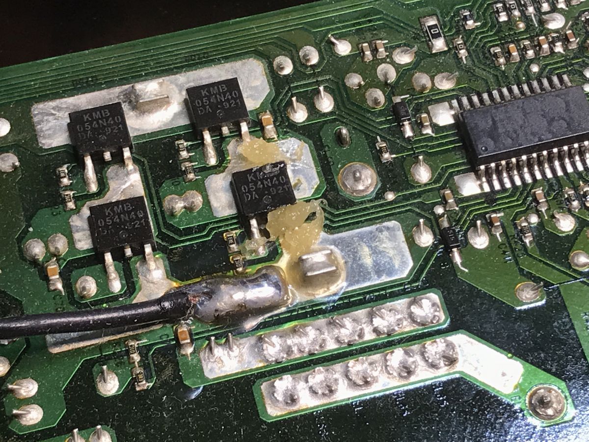

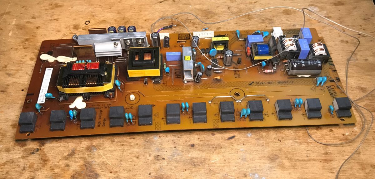

    This time I found an old flat screen TV, still with fluorescent backlighting. Time for a quick visual inspection of the backlight module, which had already arrived to me damaged anyway:
    Old printed circuit board with electronic components .
    Bottom of a motherboard with recovered MOSFET transistors .

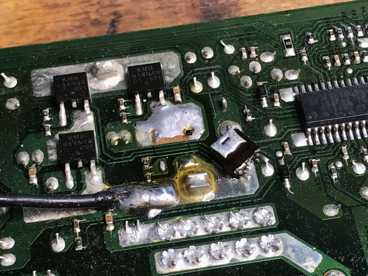

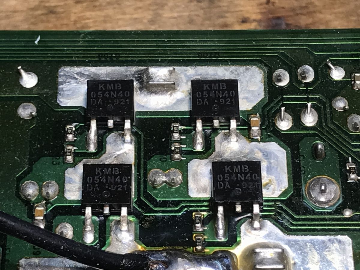

    Four promising transistors can be seen at the bottom:
    Close-up of four MOSFET transistors KMB054N40 mounted on a circuit board.

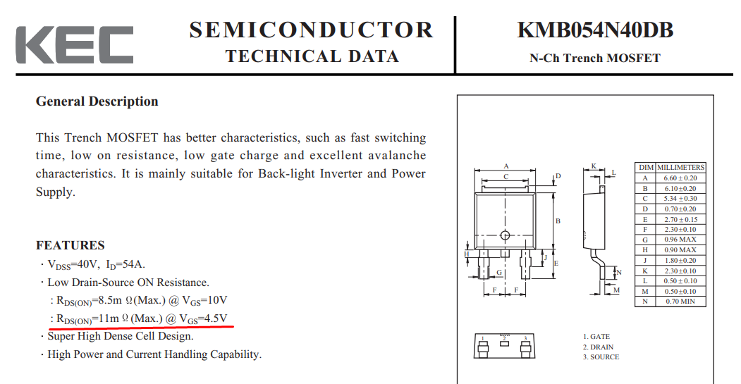

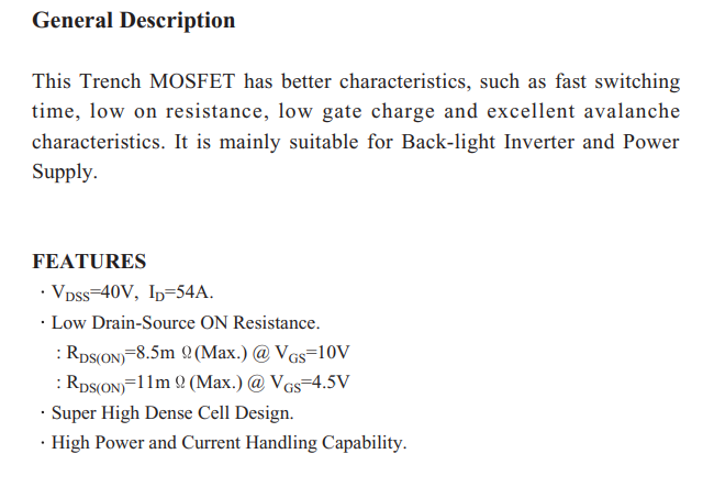

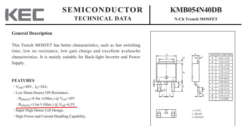

    KMB054N40, N-type channel MOSFET, Vds=40V (drain-source voltage), Id = 54A
    KMB054N40 MOSFET datasheet
    Resistance in the open state at Vgs=4.5V (gate voltage) not bad either, only up to 11mΩ.
    They just need to be soldered out. This can be done without hot air. My method is first flux, then lead binder on the solder to soften it, then alternate heating of the ground pours. The transistor can be removed with tweezers.
    Close-up of a circuit board with mounted KMB054N40 MOSFET transistors and surrounding components. .
    Close-up of a circuit board with KMB054N40 MOSFET transistors. .
    Electronic board with MOSFET transistors KMB054N40 .

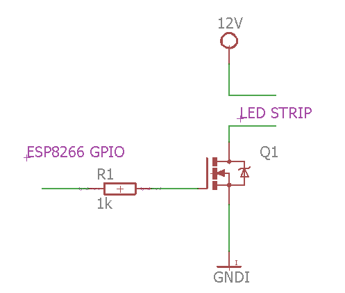

    The first schematic that comes to mind is probably to connect the output of the ESP to the gate of the transistor, preferably through some sort of resistor. I've decided to start with that, although I can't say it's the correct approach. We'll see.
    Schematic diagram with MOSFET for controlling an LED strip. .

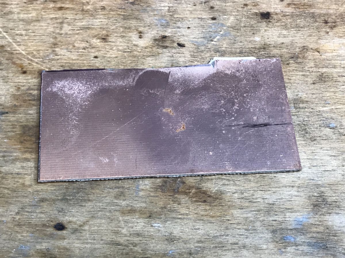

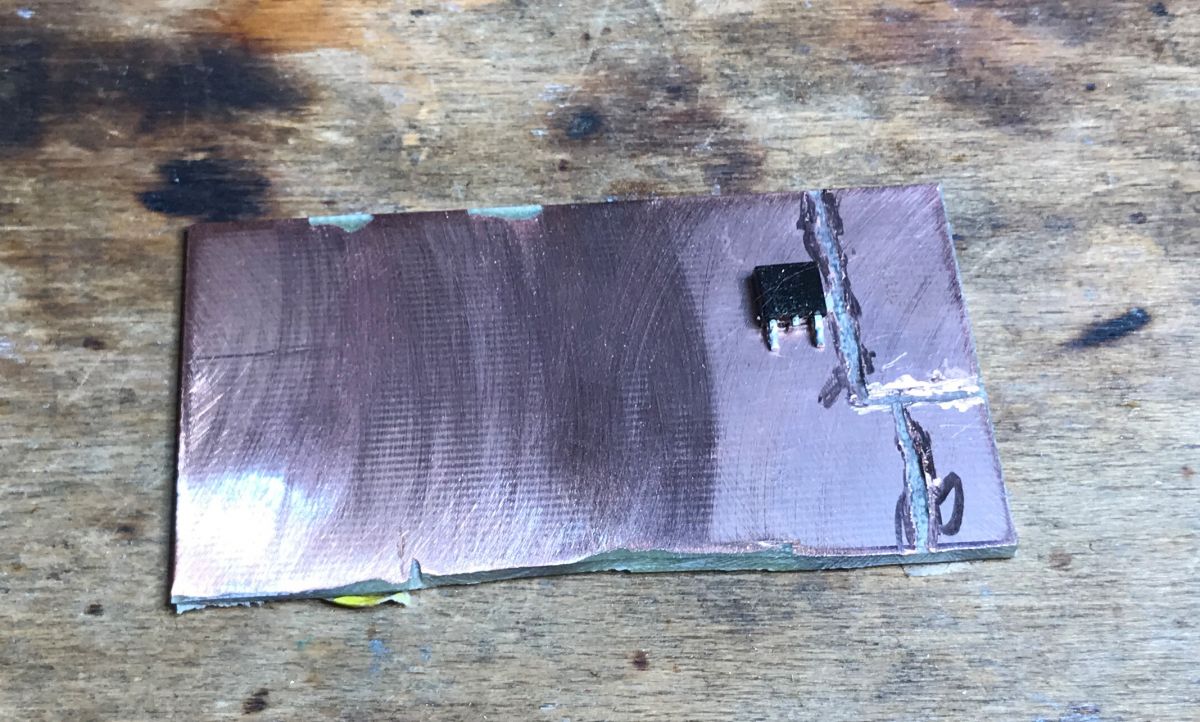

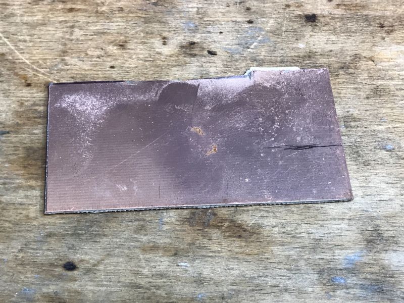

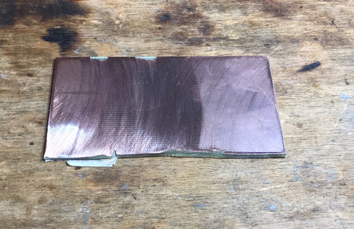

    The recovered MOSFET is surface mounted, so we won't use a contact board. Anyway, I would advise against a "contact board" for higher currents. Instead, we will make a so-called 'sculpture', as some people colloquially say, on a piece of laminate. I start the process of creating such a board by cleaning the surface of the laminate so that it is easier to solder:
    Copper plate on a wooden background. .
    Cleaned piece of laminate on a wooden surface. .

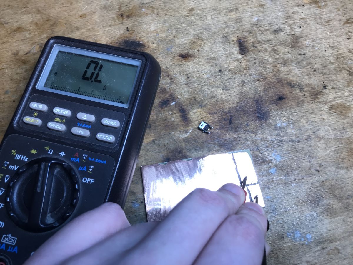

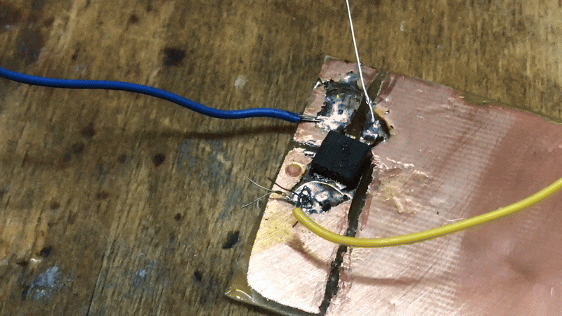

    I make the breaks with a grinder, then test if there is a short circuit with a multimeter:
    Fragment of a PCB with a mounted transistor. .
    Multimeter on a wooden table next to a copper laminate and a transistor. .
    When assembling, it is worth remembering that the entire circuit must share a common ground. In addition, respect the maximum input voltage of our module from the ESP, 12V can damage it. This is the case with the NodeMCU. To power it from 12V, you will need a step-down converter, but that's off topic....

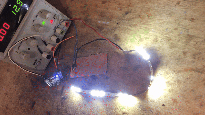

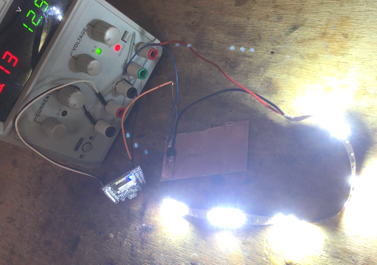

    Getting started:
    LED dimmer controlled by ESP8266 powered by a laboratory power supply. .

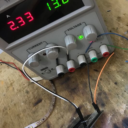

    It looks like everything is working. The MOSFET does not heat up excessively....

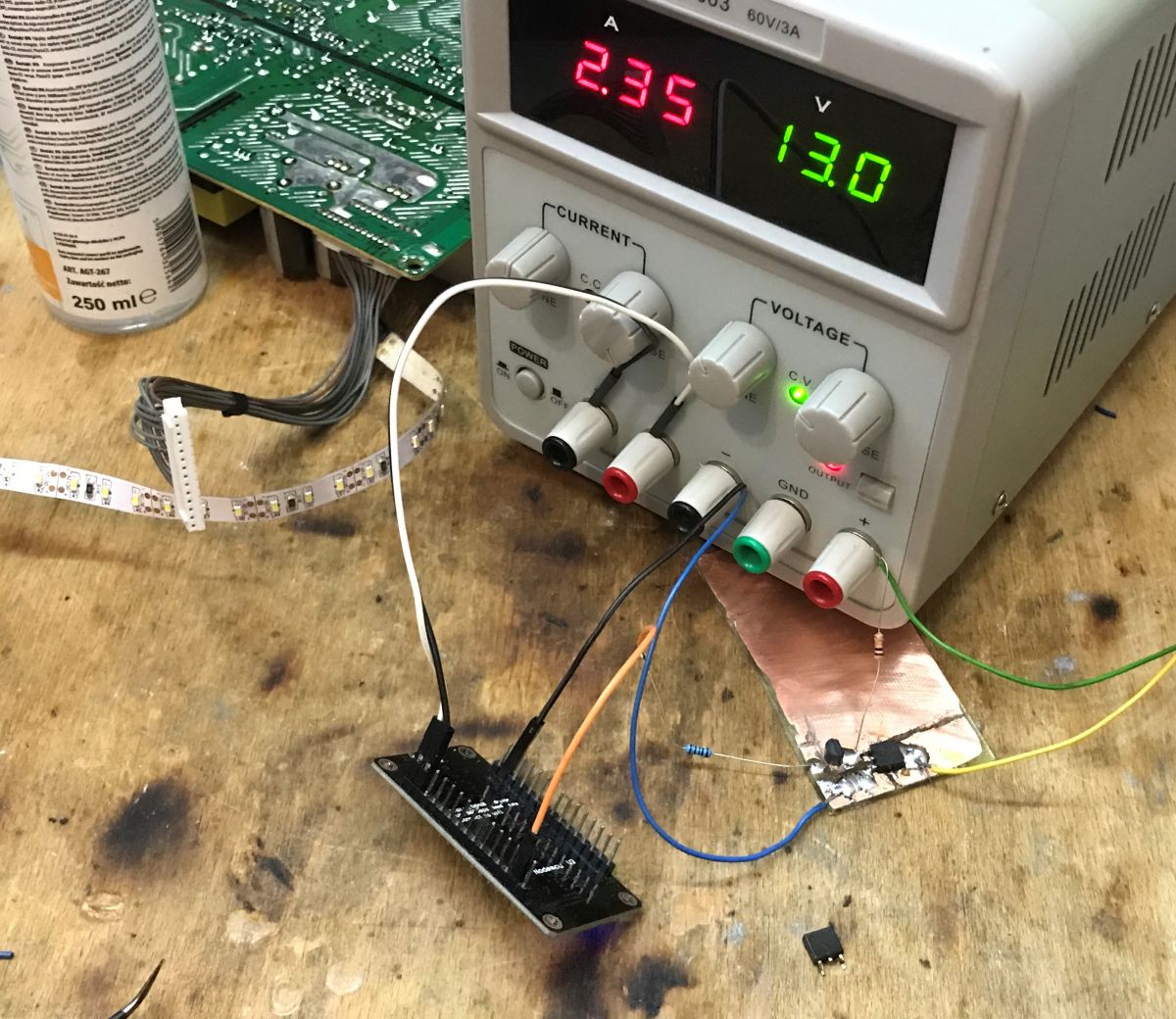

    I also connected a resistor from the gate to 3.3V instead of the PWM output, it flows 2.3A, still without excessive heating:
    Laboratory power supply connected to an electronic circuit. .

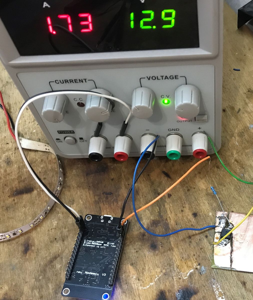

    Something has reduced the current, it's already strange. It was 2.3A and it's 1.73A, the LEDs are not so bright anymore, but that's not the only problem.
    The transistor heats up and after a while it is already very warm:

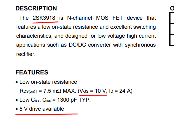

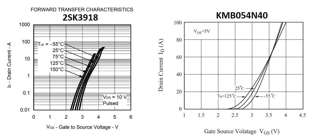

    Why did the KMB054N40 manage and the 2SK3918 no longer does? .
    It all comes down to the control of the transistor. This is a MOSFET transistor, it is controlled by voltage. The voltage at the gate (relative to the source) is determined by the parameter Vgs. How much current will be passed through the drain (resistance in the open state) depends precisely on Vgs. This is detailed on the first page of the datasheet note, but we should actually check the diagrams as well:
    Section of the datasheet for the 2SK3918 transistor. .
    Technical specification of KMB054N40DB MOSFET. .
    The graphs show the drain current as a function of gate voltage, in addition with separate curves for different temperatures:
    Graphs of characteristics for two MOSFET transistors 2SK3918 and KMB054N40. .
    As you can see, the 2SK3918 will fail in our circuit, i.e. at Vgs = 3.3V and at the current we expect. No wonder, it does not open fully and the resistance is too high, as a result of which it heats up. With the KMB054N40 it is slightly better, although still Vgs could be higher there.
    Of course, in practice there are more dependencies here, although even on the posted graphs you can see that the junction temperature itself also has an influence (and worse, the higher the temperature, the worse the conduction), but this was supposed to be a simplified presentation so we won't go that deep.
    Now this needs to be fixed somehow. We need to give the gate of the MOSFET a higher voltage. The easiest way will be to add another control stage, this time a current-controlled transistor, I will find some small signal-controlled NPN. This will short the gate of the MOSFET to ground, which I will additionally pull up to 12V.

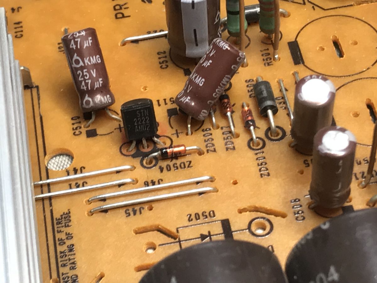

    Need to search the boards again to see what is available. On the board from the inverter I saw the TL431 itself in a case in TO-92, but it's not even a transistor, but a "programmable Zener diode"... so I looked on another board, this time the power supply module, well bingo:
    Electronic components on a printed circuit board, including a STN2222 transistor. .

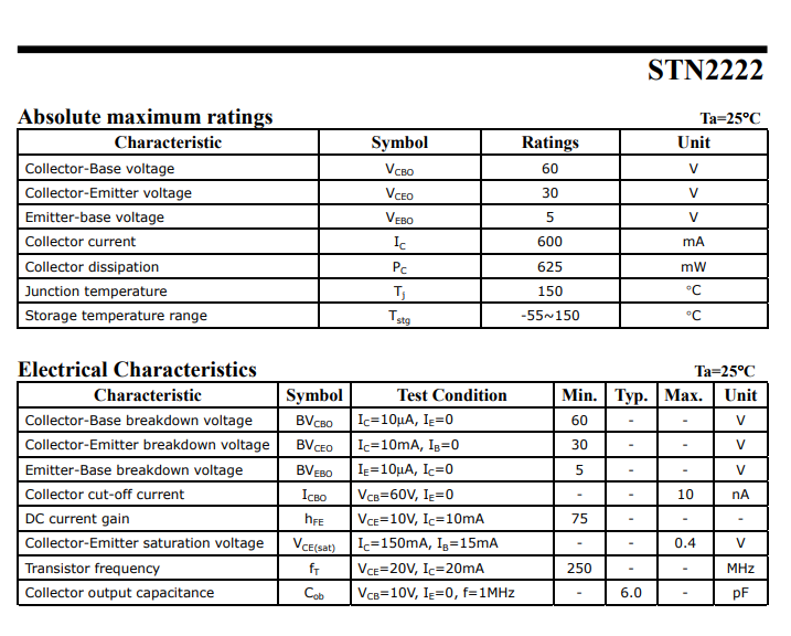

    STN2222 is a small NPN bipolar transistor, the parameters look promising:
    Table of maximum and electrical characteristics of the STN2222 transistor. .

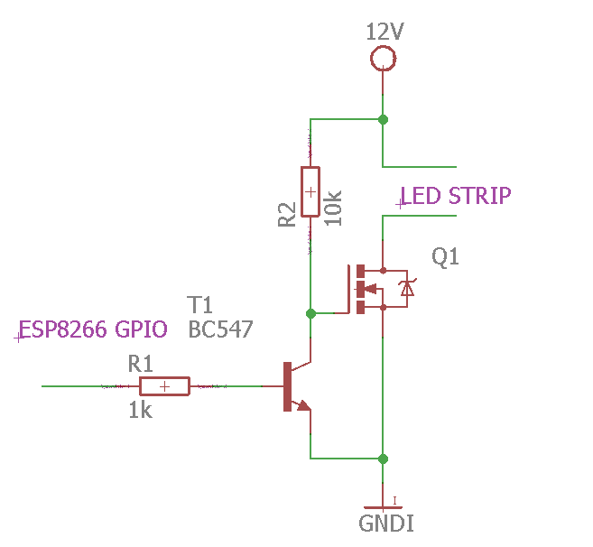

    Planned circuit:
    LED dimmer circuit diagram with ESP8266 and MOSFET transistor .
    Just a note - now when the ESP output is 3.3V (logic 1), current flows through R1 to the base of the auxiliary transistor, causing it to open. The open auxiliary transistor then short-circuits the gate of the MOSFET to ground, simultaneously closing it. So here we have the logic reversed, but since we are writing the software for the ESP ourselves this is not a problem.

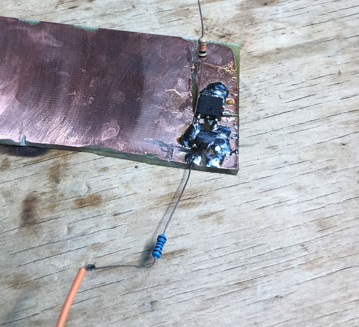

    Implementation:
    Copper laminate with a mounted transistor and resistors. .
    Time to check our work. This time the logic is reversed, so I connected the resistor to ground. You can immediately see that more current is flowing - almost the same as with the previous transistor, 2.3A:
    Electronics lab with power supply, ESP8266 board, and prototype circuit. .
    We wait, we wait and ... The MOSFET continues to be cool. Success.
    I also checked the control from NodeMCu and it continues to work, we can continue to control the brightness of the LED bar.
    Looks like problem solved. Maybe we can even do without a heatsink - the copper plate also dissipates some heat.

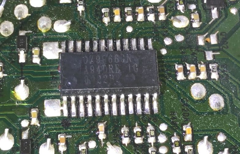

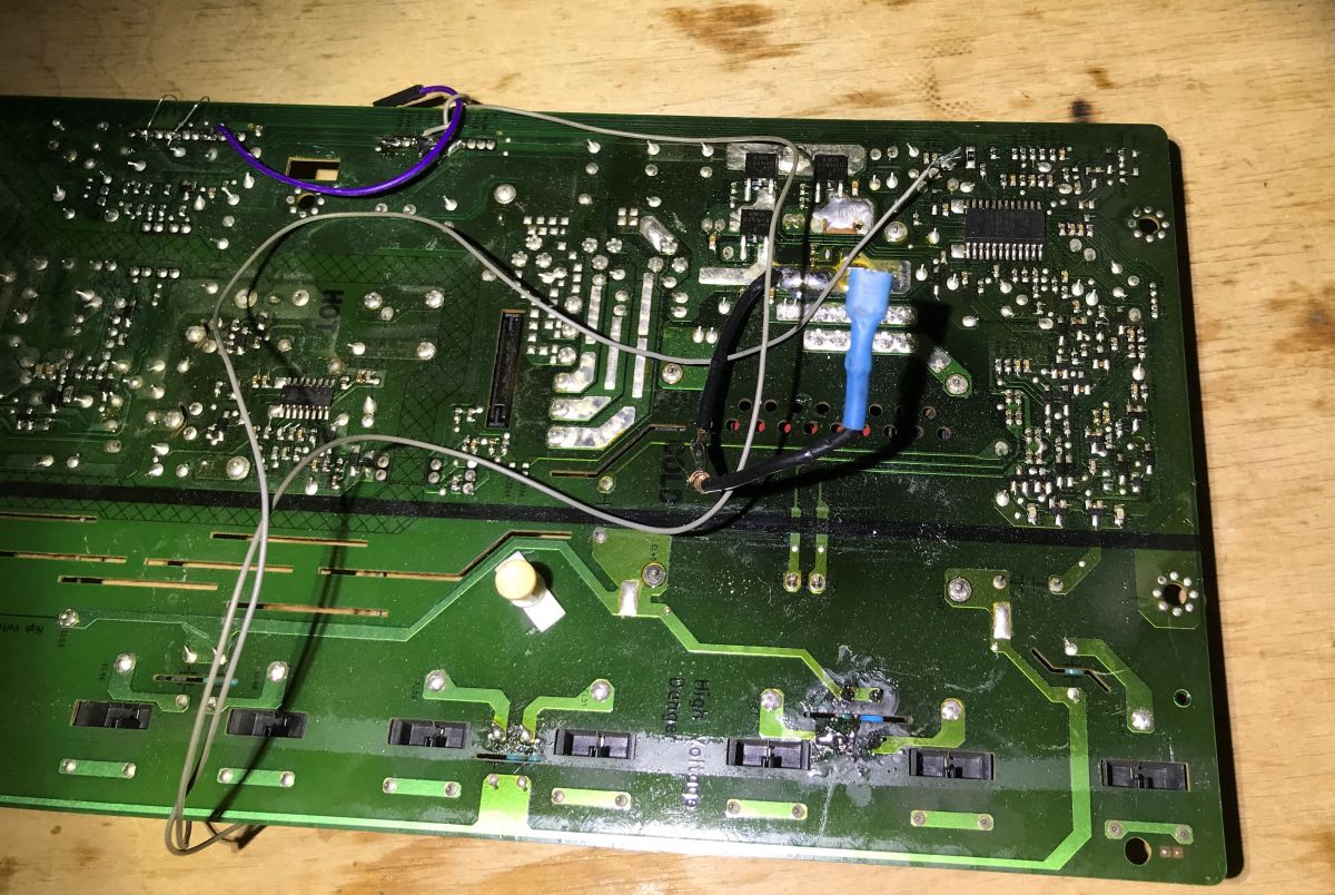

    There was probably a controller to the right of the transistors with such drivers, why not use it?

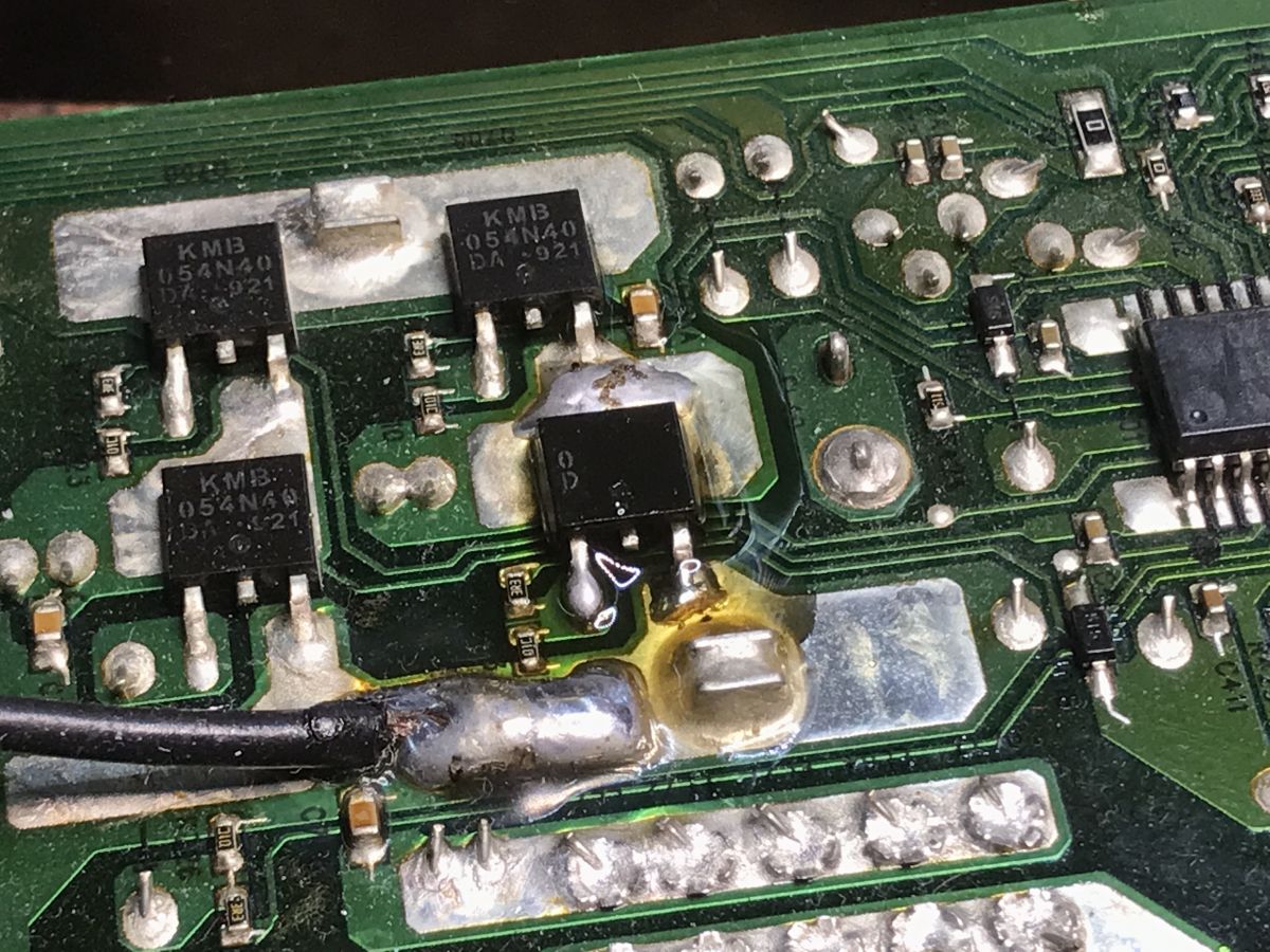

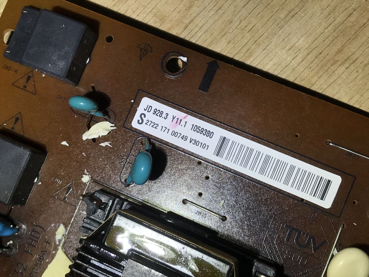

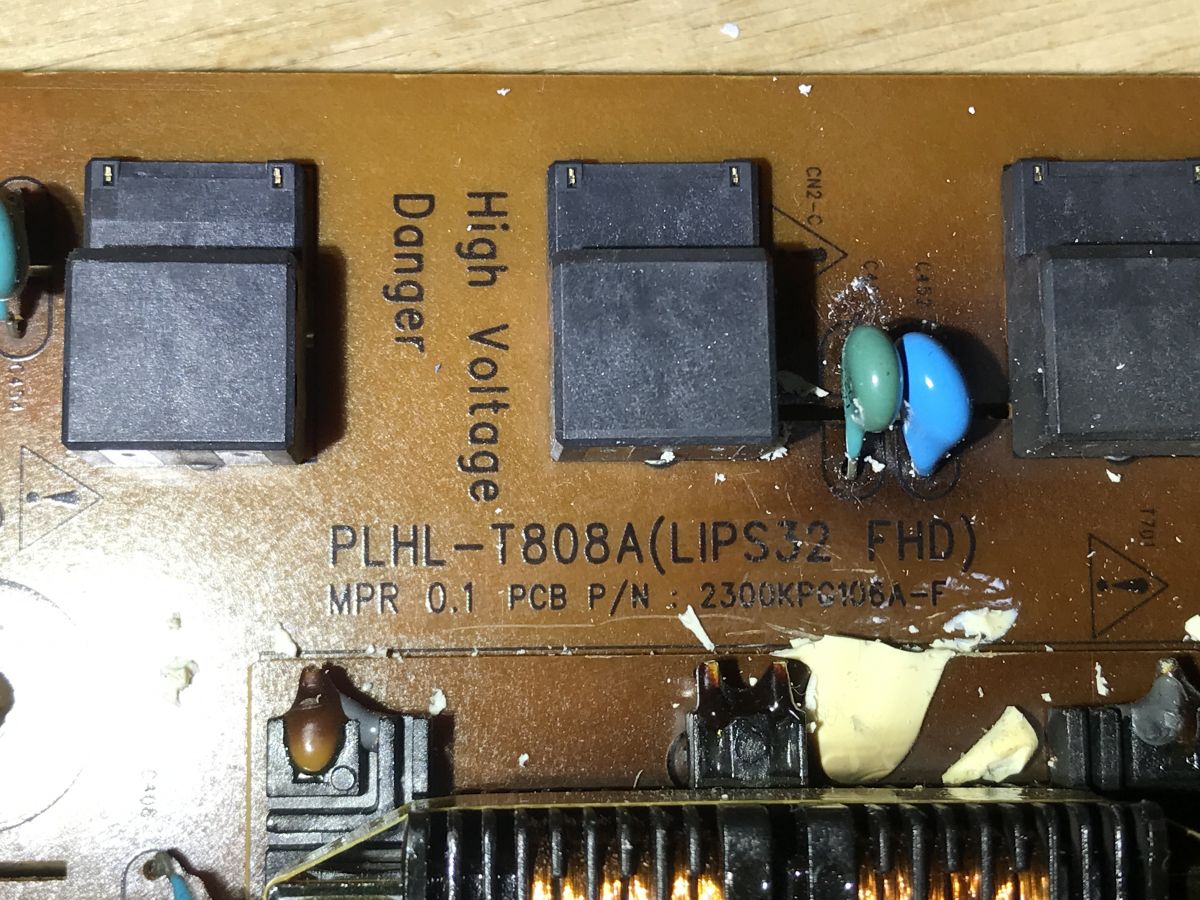

    What kind of TV was it? are there any markings on the PCB?
  • Bipolar transistor drive suggested for MOSFET dimmer
    #3 21383698
    Posts: 14763
    Rate: 12892

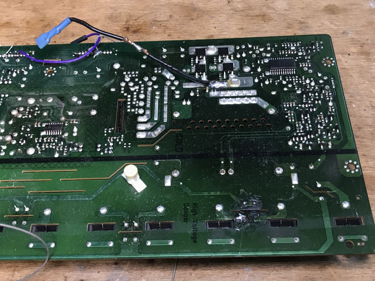

    The reason for not trying to use a PCB controller is very simple - it's just been on my mind for a while to show (in my opinion) the simplest way, which is the method with a bipolar transistor, which, although inverted, does the job.
    And besides, as it is well worth trying, here is a bit more info:
    Circuit board with soldered wires and a transistor. .
    Image of a circuit board with an integrated circuit and electronic components.
    Markings:
    Close-up of a circuit board labeled PLHL-T808A with electronic components. .
    Part of a PCB with markings and electronic components. .
    I haven't checked them yet, if anything I'll edit the post

    This is an example of an anti-guide. I get it, you wrote about some simplifications, but this guide is misleading.
    Firstly:
    The statement that mosfets are voltage controlled. This is what happens in a static state. When switching quickly, gate current flows. Why are drivers for mosfets or IGBTs capable of putting out several A of current? Precisely to overcharge the gate capacitance. Your circuit masks the problem, because the PWM frequency is probably a few hundred Hz. I use several kHz to control the LEDs in my flat, because otherwise you can hear the LED strips squealing. Then these transistors would desolder themselves.
    Secondly:
    Focusing only on the channel resistance. There is also such a patrameter as the charge needed to overcharge the gate and the associated capacitance. Losses during the switching state are one thing, but when switching is another. See the point above.
    Thirdly:
    This circuit with an NPN transistor and 10 kΩ in its collector.... I suggest you count how long this 1 nF capacitance will charge (and, as a rule, the lower the channel resistance, the higher the gate capacitance, so it could be several nF as well). If you don't want to count, you can take an oscilloscope and see what is there instead of the expected rectangle.... An analagic circuit is made of the digital.
    Fourthly:
    There are transistors that have switching voltages even below 1V and we can control them straight from the ESP leads, using the full capabilities of the GPIOs, more specifically their current capacity of the push-pull outputs.
    In the mentioned circuit (point 3), we have a high pull current, and a push current of about 1 mA thanks to the unfortunate 10 kΩ resistor....
    I would see the tutorial as discussing the problem rather than masking it.

    I am aware of the issues you have written about, but in my opinion for a simple dimmer not operating at a higher frequency (which you yourself have given as being unusual), this is in my opinion negligible. Anyway, there is a sentence in the text that I don't know if you have paid attention to?
    Of course, this is not the only way to control a MOSFET transistor, a lot depends on the switching frequency, gate charge, there are also dedicated drivers, but for a simple dimmer the circuit shown here fully copes.
    Even more so, if I wanted to control some IGBTs at higher frequencies in some inverter, I wouldn't use the simple solution shown here, and I also have dedicated MOSFET drivers after various projects, for example, the first of the bunch at the time of writing the posts:

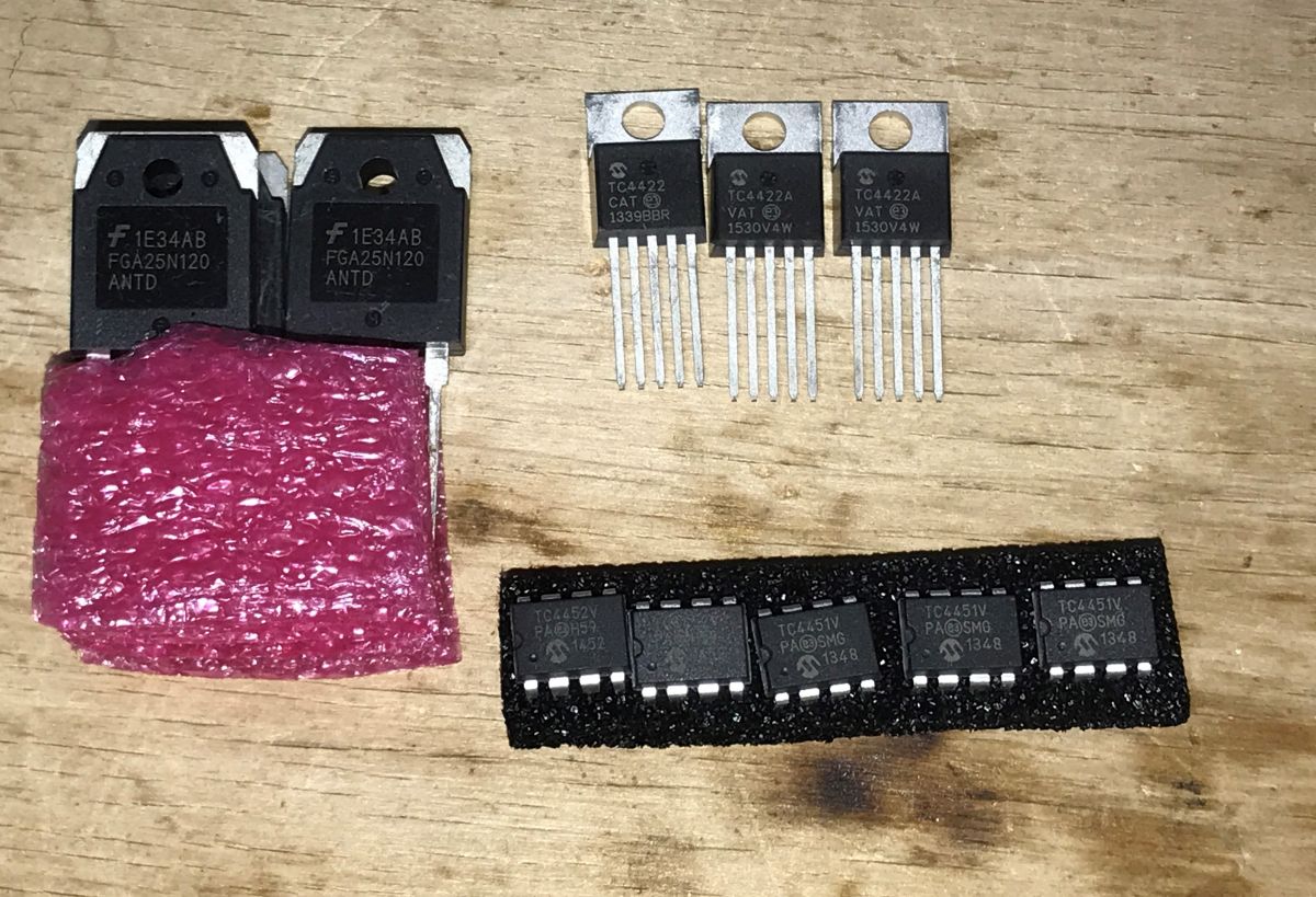

    Various electronic components, including transistors and drivers, on a wooden background. .
    Now, one would still have to wonder what exactly is the object of your criticism, i.e. do you even think that such a solution as I have shown for beginners has no right to exist, and anyone to control an LED strip with an ESP8266 needs that much theory? Or are you more concerned that it's not emphasised enough in the topic that it won't work in other situations? If it's the former I'd debate that such LED control under these conditions will work, in the latter I can still agree.

    And if one does not have a dedicated driver? It will not know that this 10 kΩ resistor, can be reduced, accepting losses in it, but many times lower than in a mosfet. At 1 kΩ we have losses in the range 0...144 mW (PWM 100...0 %), but lower in the mosfet.
    Then suppose someone takes a dedicated driver and gives a gate resistor of e.g. 1 kΩ instead of a few Ω, "because mosfets are voltage controlled".
    And what if you don't have both a driver and a 12V voltage available? The bootstrap circuit can also be used in the example above.

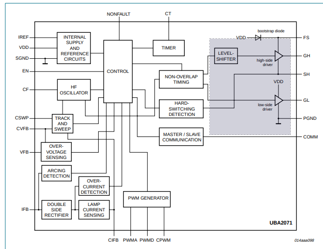

  • Charge-pump IC suggested for high-side PWM control
    #8 21383815
    acctr
    Posts: 4554
    Help: 389
    Rate: 2025
    This looks like a UBA2071-like IC. He is intended for CFL control, but you could try generating a simple PWM.
    The argument in favour is the drivers and charge pump inside, allowing high-side control.

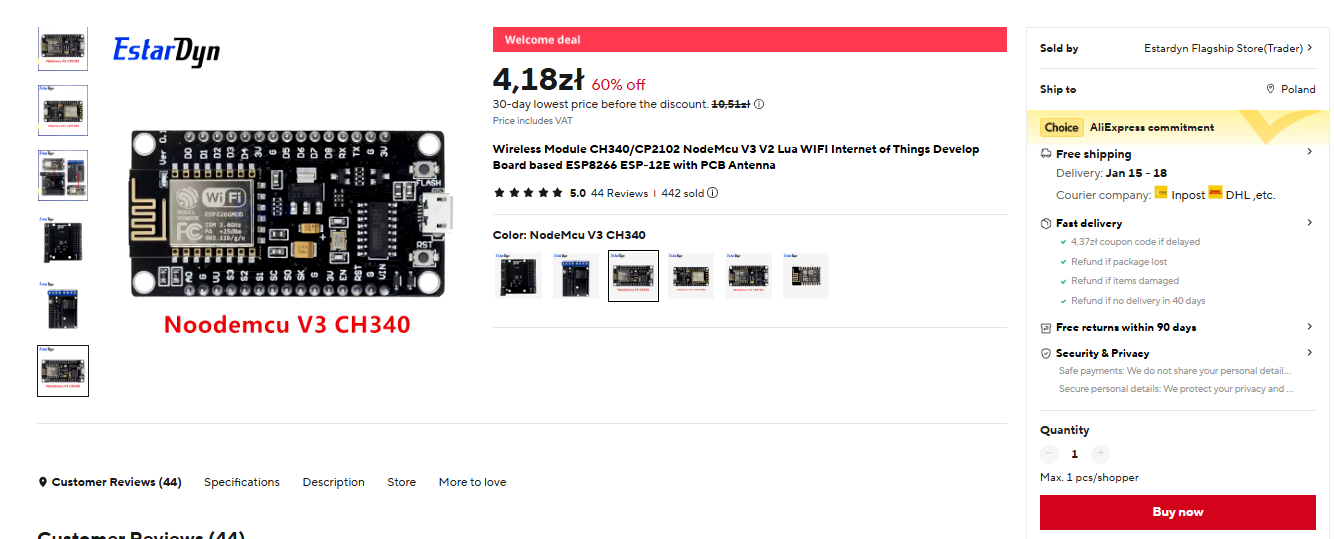

  • Cheap NodeMCU modules as a beginner-friendly simplification
    #9 21383926
    Posts: 14763
    Rate: 12892
    On the topic of simplification in the presentation, I would like to point out one more thing - as far as I can see, in our time, programmable modules (and ones with WiFi) are cheaper and simpler to use than ever. For example, depending on promotions and whether or not you create a new account on the site, you can import such a NodeMCU with ESP8266 from China for just 4PLN and 18 cents:
    Image of an online store listing for the NodeMCU V3 CH340 module, priced at 4.18 PLN. .
    Practically everyone can start the adventure with NodeMCU, because the expense of 4 PLN is as nothing (rather everyone has a USB cable), for this reason I wanted to present such a simplification of the whole process, of course noting in the text that it is a simplification. All with the hope that maybe someone will get motivated to tinker and then, once the LED bar lights up, he or she will catch the interest and, if necessary, read deeper into the book and gradually add to the knowledge. I work a lot with younger people and I know that to start with, one small practical presentation is hundreds of times more interesting than theory, so this can be used as a kind of 'lure' to get them away from FB, for example....
    Of course, here you have to be careful not to over-simplify, but this has already been mentioned, rightly so too.
