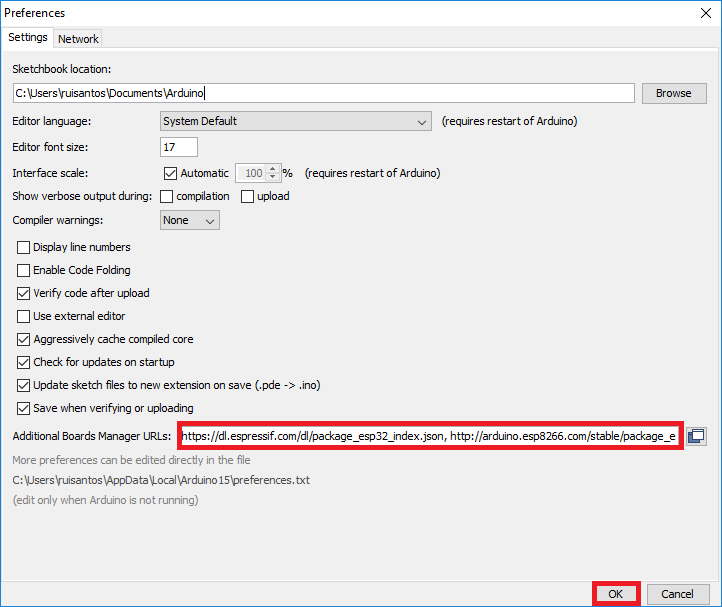

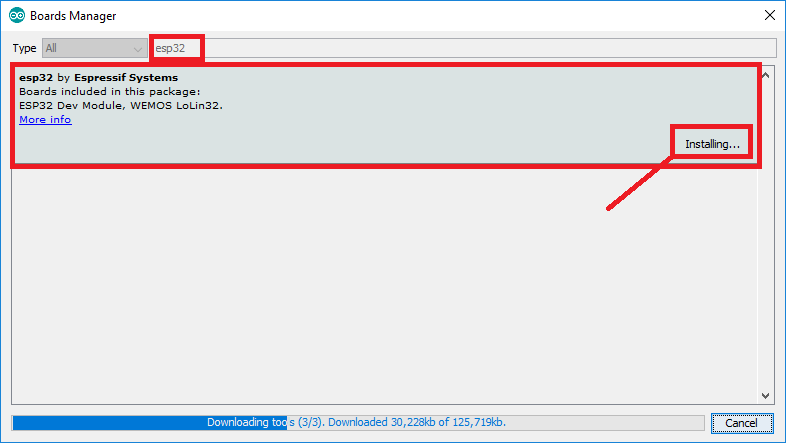

Install the Espressif ESP32 boards package by adding `https://dl.espressif.com/dl/package_esp32_index.json` in Arduino IDE Preferences → Additional Board Manager URLs, then select `DOIT ESP32 DEVKIT V1` with the default board settings [#19863735] Select the correct COMx port and try uploading the Blink example from File → Examples → Basics → Blink [#19863757] If Windows shows the USB device as unrecognized or nothing appears in Device Manager, the PC is not seeing the board/USB-TTL interface properly, so check the USB driver and the board connection [#19861169] The compile errors about missing `crt1-sim.o`, `_vectors.o`, and the duplicated `WiFi.h` library suggest the ESP32 package/libraries were installed incorrectly or conflict with another WiFi library, so reinstall the ESP32 package and keep only the ESP32-provided libraries [#19863744][#19865251]

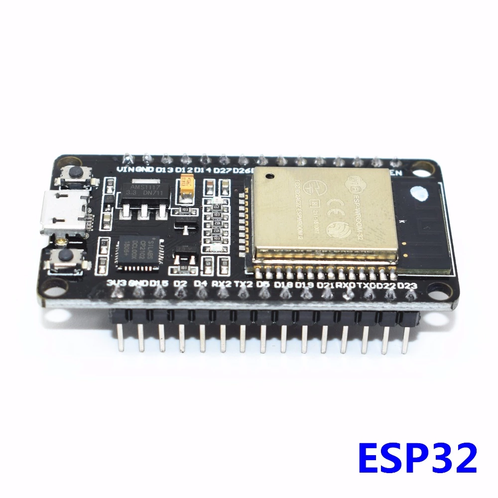

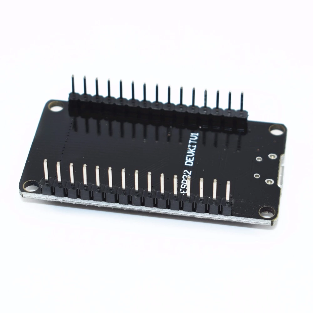

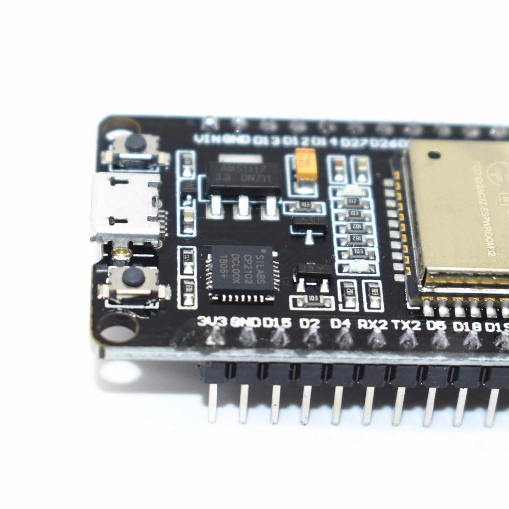

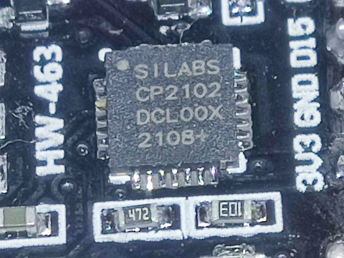

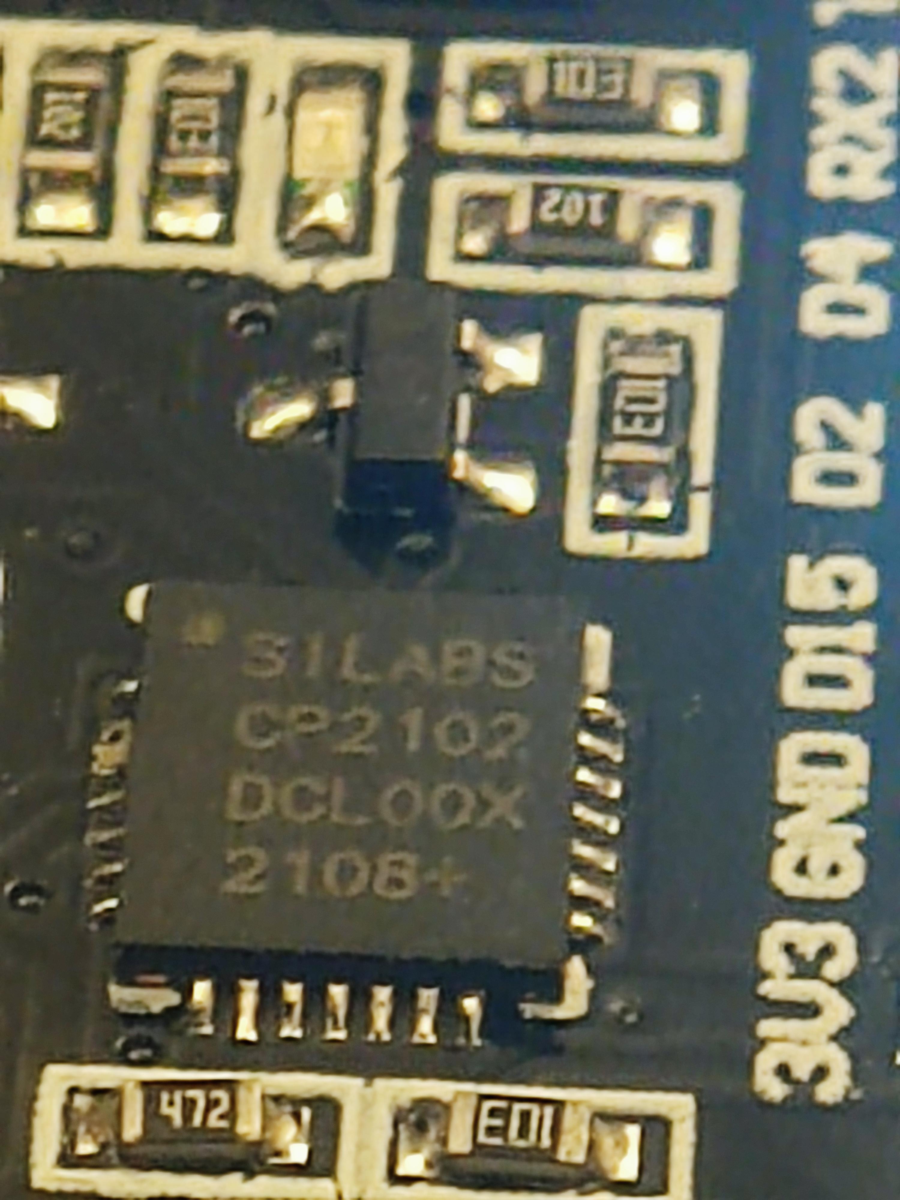

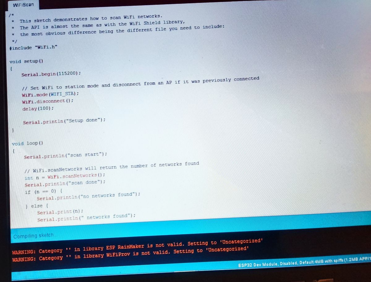

    Good day, I bought an ESP 32 from a Chinese and for china I cannot upload a project there, I have already downloaded various boards from different sites and nothing :/ I am not sure anymore if I am sure the board works properly. Maybe someone has info where to get a board for Arduino for this board ?
    • Where do I get a board for the Arduino under the ESP 32? Problem with uploading a project. IMG_20220131_235724.jpg (742.62 KB) You must be logged in to download this attachment.
    • -1099814991-862273608.jpg (92.92 KB) You must be logged in to download this attachment.
    • -1099754634-747787884.jpg (90.65 KB) You must be logged in to download this attachment.
    • -1099780540540569803.jpg (49.65 KB) You must be logged in to download this attachment.

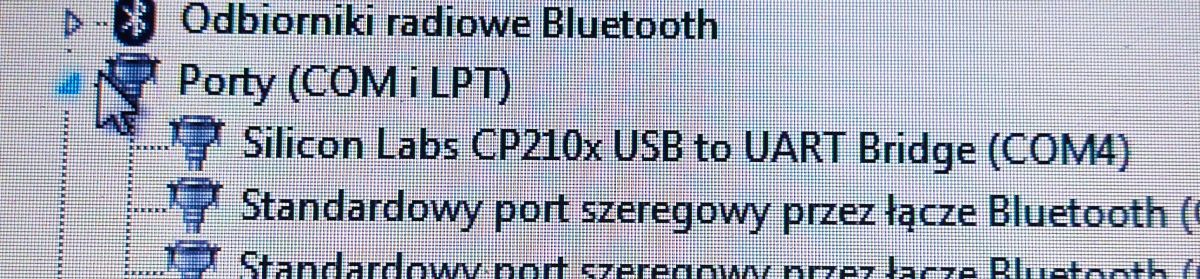

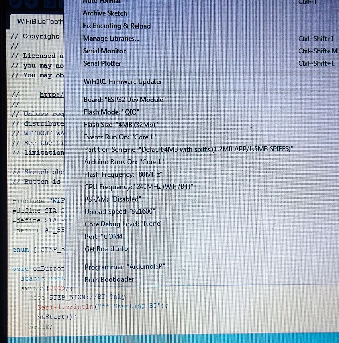

    Show your configuration in the Arduino IDE
    I assume you have Windows, do you see the USB-TTL converter in the manager?
  • USB device not recognized on COM4

    In USB it shows me nothing, only com and lpt, and USB as not recognised. So even the computer doesn't see it as on the USB port and the Arduino doesn't see it either ??? In Arduino I have com4 set as here on the port this device.
    As for the Board Manager I don't know if I have downloaded good.

    You own this board:
    Link .
    You will find enough information there.

    I did it, and it doesn't even pass this verification

    I think there is something wrong with the libraries, it gives me this error:
    Arduino: 1.8.19 (Windows 7), Board: "DOIT ESP32 DEVKIT V1, 80MHz, 115200, None".
    c:/users/jan iii and hussars/appdata/local/arduino15/packages/esp32/tools/xtensa-esp32-elf-gcc/1.22.0-97-gc752ad5-5.2.0/bin/../lib/gcc/xtensa-esp32-elf/5.2.0/../../../../xtensa-esp32-elf/bin/ld.exe: cannot find crt1-sim.o: No such file or directory
    c:/users/jan iii i hussaria/appdata/local/arduino15/packages/esp32/tools/xtensa-esp32-elf-gcc/1.22.0-97-gc752ad5-5.2.0/bin/../lib/gcc/xtensa-esp32-elf/5.2.0/../../../../xtensa-esp32-elf/bin/ld.exe: cannot find _vectors.o: No such file or directory
    collect2.exe: error: ld returned 1 exit status
    Multiple libraries were found for "WiFi.h"
    Used: C:C:Husserland and HusserlandAppDataLocalArduino15.h.h.h.h.h.h.h.h.h.h.h.h.h.h.h.h.h.h.h.h.h.h.h.h.h.h.
    Not used: C:Program FilesArduinolibrariesWiFi.
    exit status 1
    Error compiling for board DOIT ESP32 DEVKIT V1.
    This report would have more information with
    "Show verbose output during compilation"
    option enabled in File -> Preferences.

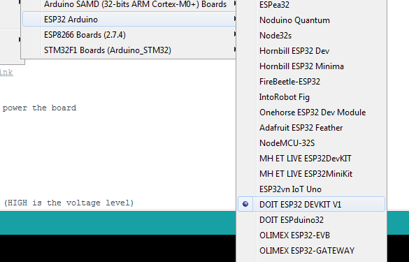

    I have the same board, so set up as shown above. Select your COMx port. Upload an example program: file -> examples -> basics -> blink
    My Arduino is 1.8.16, windows 7
    PS
    I just updated my Arduino IDE to 1.8.19 and everything is OK

    I have uploaded everything again, the settings are the same and still the same error, something is wrong with the libraries :/
    Added after 11 [minutes]:
    Maybe some settings after the old program,
    Added after 12 [minutes]:
    Strangely enough after installing the new Arduino it detected me after connecting the USB esp32 and now look and the device is not detected, on the com port it is but on the USB port there is an error
