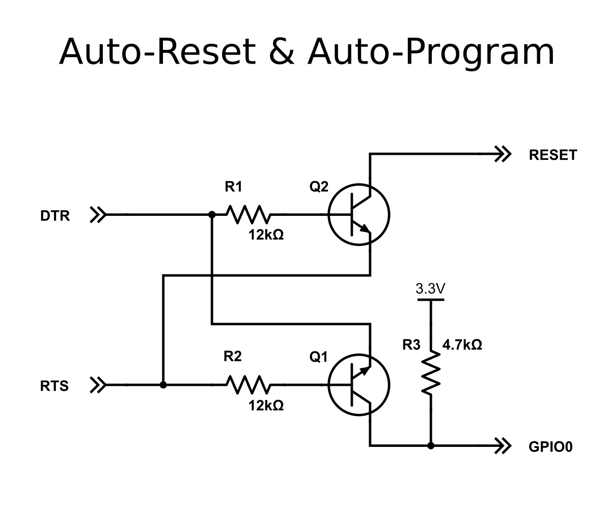

    Uploading code to the ESP32 always involves pressing a button at the right time.

    In my case nothing had to be clicked, everything happened automatically. I thought about using a USB-UART converter and connecting the rx and tx to the ESP, but I don't know if that has the right to work.

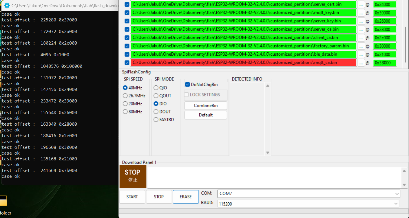

    @Atypowy256 I suggest you first clean the ESP32 flash. You can use Flash Download Tools for this: link
    If I did it right, it didn't do anything. Further the program does not want to upload.

    If the flash cleanup was successful, the problem is not likely to be with the ESP32 board, but with the settings in the Arduino IDE.
    An error pops up (pic).
    ESP32 Upload Fails After Multiple Attempts, No Output in Arduino IDE Monitor .
