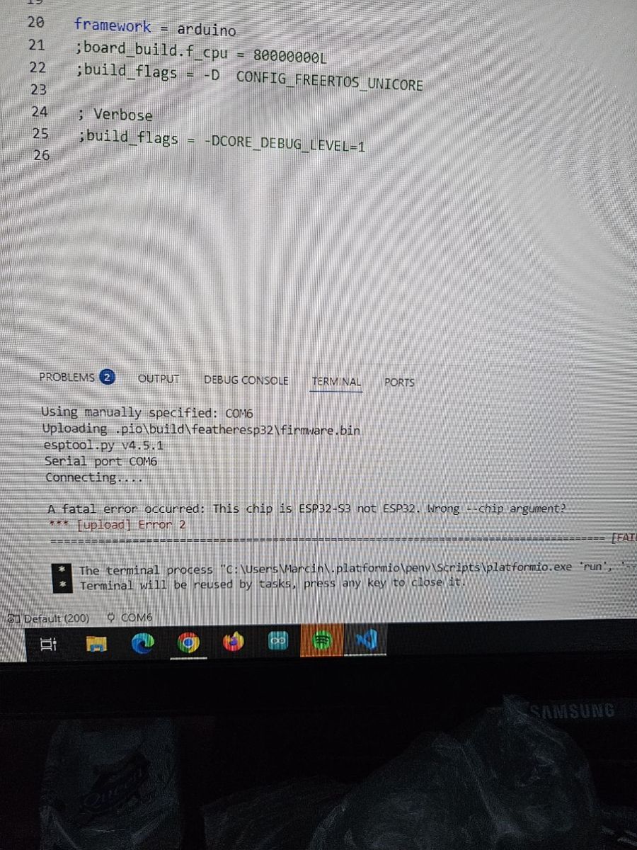

    I have a finished project on an Arduino ESP32, I have uploaded it via Visual Studio Code and would like to install it on a newer ESP32-S3. How to flip it as it throws me a board error.
    Photo attached
    Please help ;) .
    Screenshot showing Arduino project compilation in Visual Studio Code; a fatal error indicates the wrong chip selected for ESP32-S3.

  • Platformio board setting must match esp32-s3
    #6 21531122
    #7 21531303
    DJ_KLIMA
    Level 25  
    Posts: 665
    Help: 67
    Rate: 222

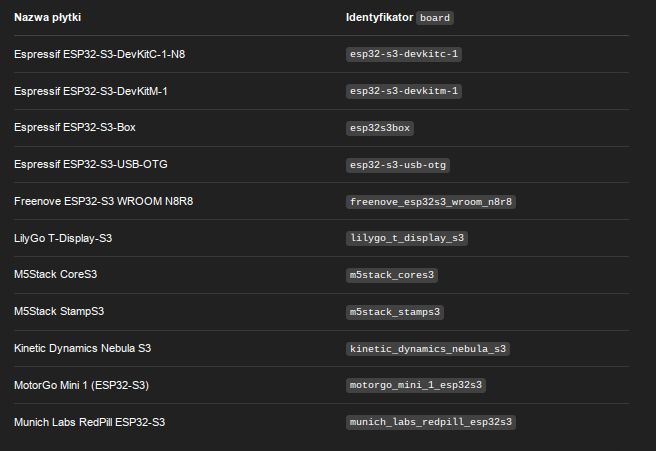

    This should import itself, Platformio/quick access / import Arduino project (you select the board / module), then add the libraries to the Platformio mechanism, or drop them traditionally into the include / lib directory, set the extra option for the project in platformio.ini.

  • #10 21539242
    denis789
    Posts: 16
    All according to DJKlima instructions ;)
    I added the entry
    [env:esp32-s3-devkitc-1]
    platform = espressif32
    board = esp32-s3-devkitc-1
    It downloaded the rest by itself.
    Thanks again ;) .
