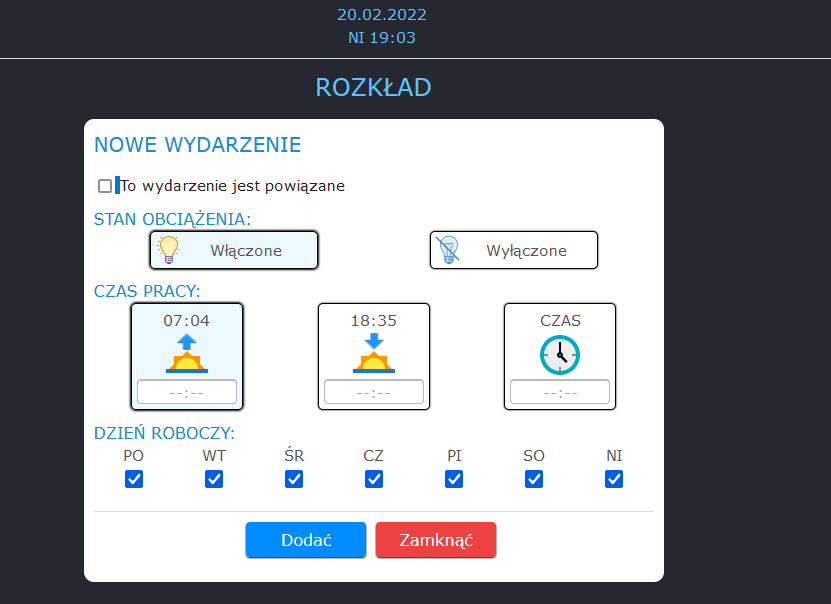

    I have connected the EM-130 controller to the wifi network.
    I would like to set it to switch on the relay after sunset and switch off such a basic action as twilight after sunrise.
    So I messed around with the schedule -> new event options and :
    How do I set up the EM-130 controller? I don't know what values to enter. .
    I don't know what to enter in the fields under the east and west icons and in the time fields since I want to include east to west.
    In the instructions added poorly with descriptions only that you need to enter values but what ?

    Topic figured out :) .
    In the fields, you enter the time, e.g. +00:10 minutes or +01:10 hour and ten minutes, the plus sign means that it will be switched on that much later, while the minus sign delays switching on/off by the entered time under the sunrise or sunset sign.
    The third icon with the clock mark is used to enter the time - the time of switch on/off and it does not matter whether it is sunrise or sunset.
