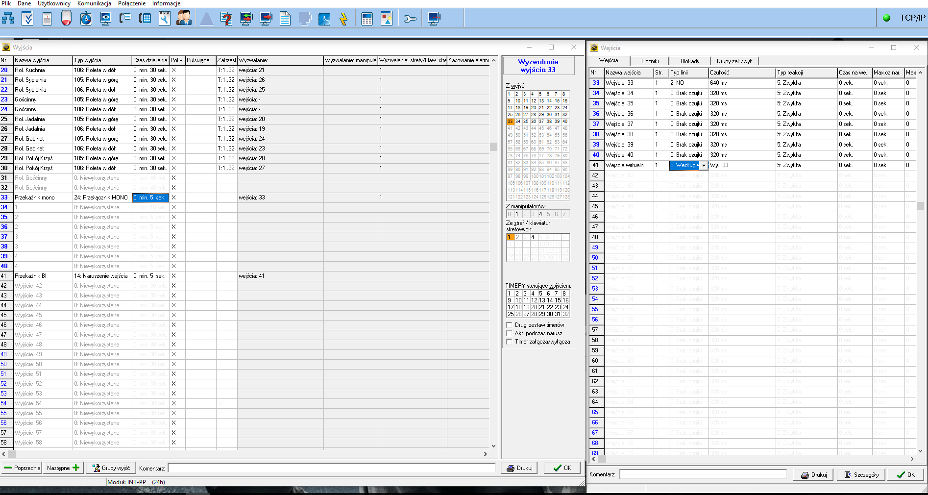

    Well, because the output "BI relay" does not work on time. Create a virtual output "BI relay". Use it to drive the virtual input "by output" and with this the physical output "MONO relay" with a time of 60 min.

    Hello again. I've been combining and something is missing.
    The inputs and outputs seem fine but I don't know how to drive them. Can you take a peek at what is wrong?

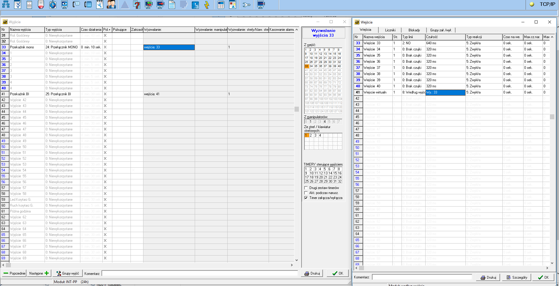

    lolodn wrote:
    Hello again.
    I don't quite understand what Virtual Outputs / Inputs are about
    These are "elements" that are not physically present.
    Elements that are not physically there can control elements that physically are - e.g. outputs.
    They can perform logical functions.
    The output controlling the relay must be a physical output - not a virtual one.
    The same applies to the input.
    There are not 128 physical outputs and inputs on the control panel board.
    If the available physical outputs are used an expander must be added. .
    The expander is bus controlled.
    Simply use the output with the response type "input violation".
    You set a time of -0-99 minutes.
    You control the output from an input = the input is your switch(12V).
    By switching on you violate the input.

    Yes. In my case, it's the virtual Inputs / Outputs that start at location 41 and go from there.
    Could you take a peek at Screen what I'm missing there so I can drive the mono relay for a specific time?

    Change the response type of input 33 from 5 to 47.

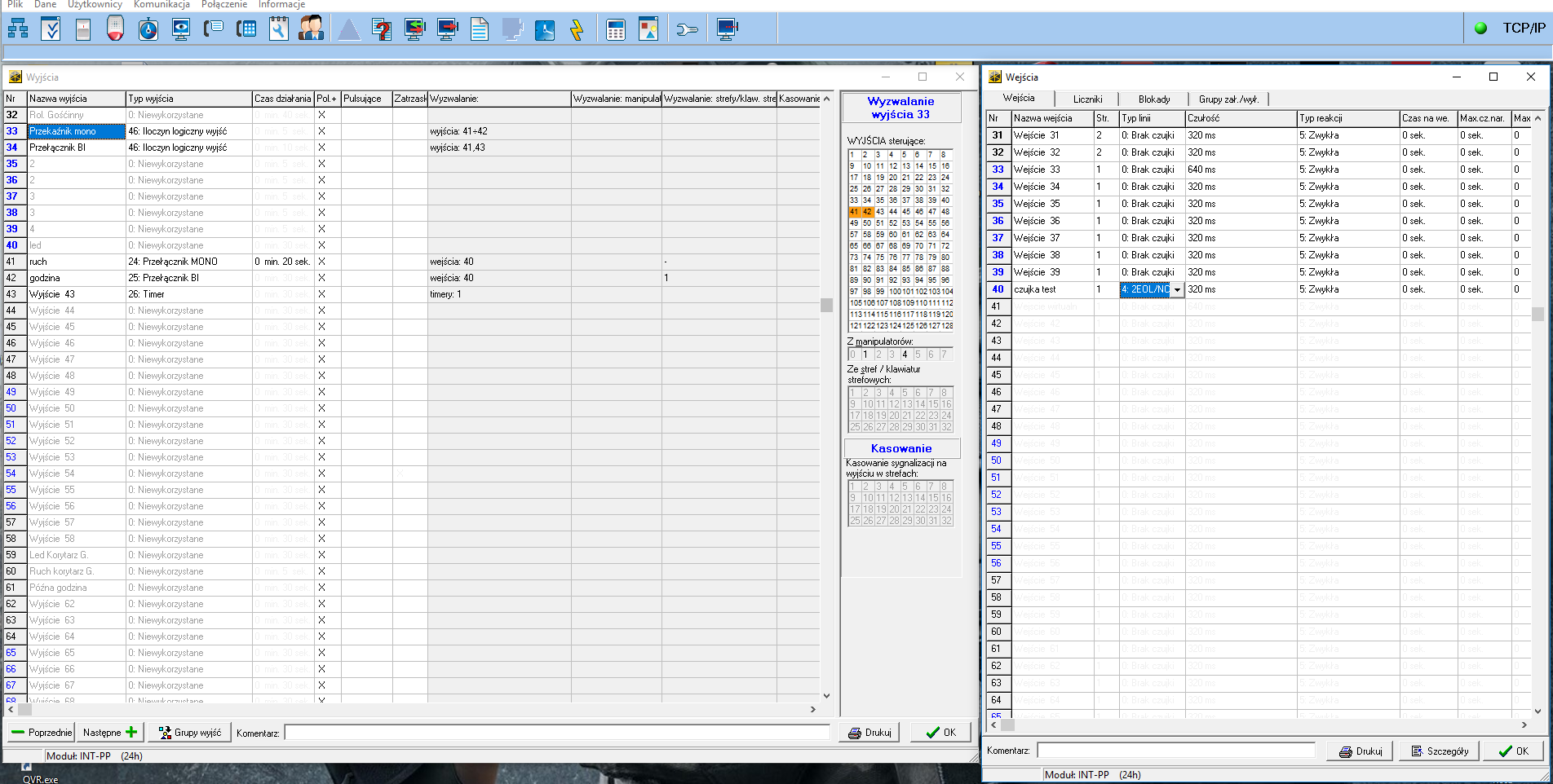

    I was making a Czech error ...
    instead of the product of the outputs I did it on the product of the inputs.
    Now I have it so that one detector (or later a button) closes two relays for me.
    The Bi relay works fine.
    The mono relay which is supposed to work so that when it is pressed it is supposed to switch off after a period of time or when it is pressed a second time it switches off - "works" But when it switches off after a period of time it has to be pressed twice for it to switch on again. Is there a remedy for this?
