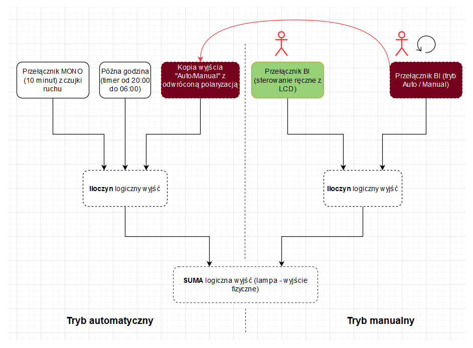

    Something along the lines of:
    Satel Integra 64: Flexible Lighting Control Beyond TIMER Hours with Remote/App .
    This is a very similar concept to the one described above. Step-by-step configuration details available in the article:
    https://www.montersi.pl/wsparcie/porada/patent-na-sterowanie-oswietleniem-z-integry/
    however, it is only available to the company's customers. Nevertheless, with a skilful analysis of the picture you can learn quite a lot. I suggest paying attention to the maroon rectangles, where these are the outputs that work alternately.
    Added after 1 [minute]:
    And disabling a given BI output at any time is already a Timer and an input (by output) with response type: "Disable output group". Also described in detail in the article.

    Lights wired to the BI switch output, control from the app and remote control as it is now, additionally let the timer at 7pm switch on these BI switches via the "switch on output group" input, timer switch off at midnight via the "switch off output group" input.
    And embraced without using logic functions.

    kood wrote:
    I embraced without using logical functions.
    You are right. For the scenario the author described, your solution is spot on.
    Revelation... Thanks for the hint. It works exactly as I wanted it to. I'll be honest and say I hadn't seen this "on or off group" before :) .... maybe something would have dawned on your head :) .
