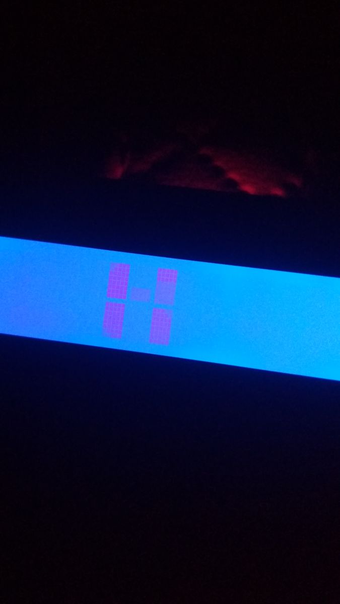

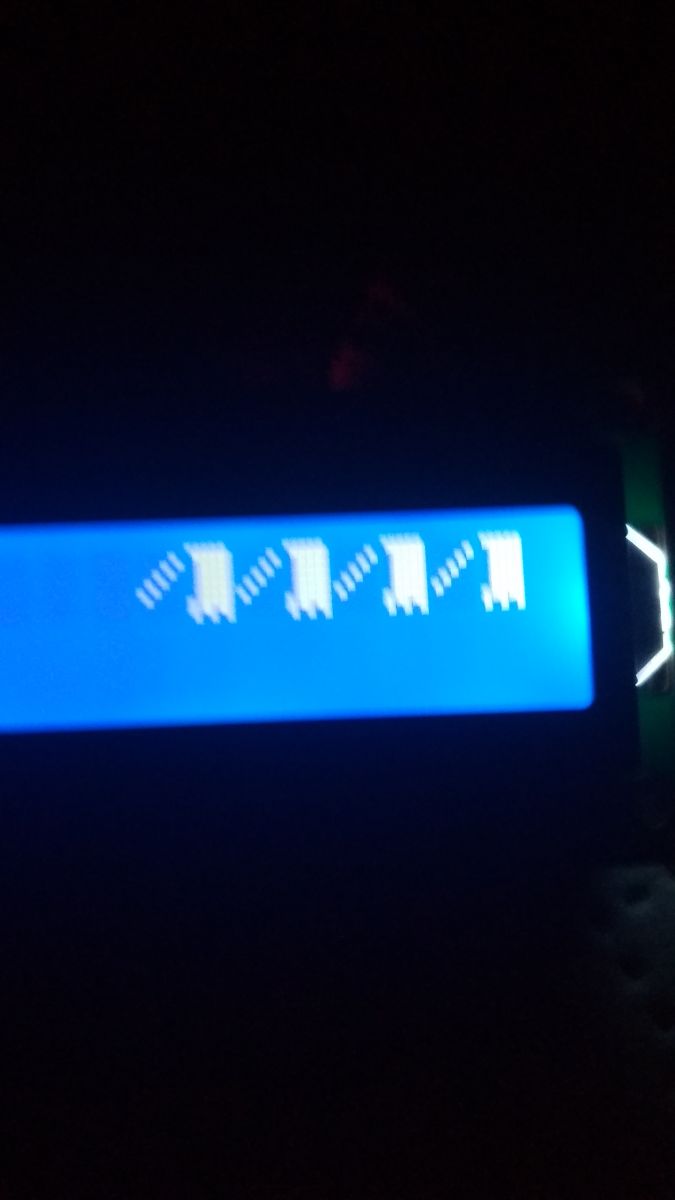

    przemo996
    Posts: 12
    I have connected a blue display to the NodeMCU with an I2C converter. The text is displayed, but not in the typical light color, but it is like a dark shadow. When the power supply is interrupted for a moment during operation, it starts to display bushes, which is obvious because it is not configured correctly, but they already have the correct color, when in this situation the begin() or init() method is called (depending on the library) the dark text returns. Dark text on HD44780 blue LCD display with I2C converter connected to NodeMCU Dark text on HD44780 blue LCD display with I2C converter connected to NodeMCU .
    What is the problem, does it mean the display or converter is faulty? Does anyone have a similar experience, an idea how to fix it?

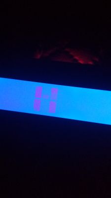

    przemo996
    Posts: 12
    Yes, this incorrect color is displayed at maximum contrast, when reduced, absolutely nothing is visible. When the painted bushes are displayed correctly the contrast adjustment works correctly.

    przemo996
    Posts: 12
    Converter factory connected to the display, I corrected all the solders, apparently there was a high resistance somewhere.
