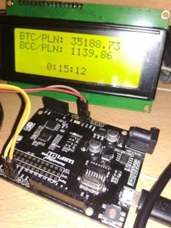

    Hello, I would like to make a cryptocurrency course display based on WeMos D1 R2 ESP8266 and LCD 2004 4*20 I2C. I am a beginner about arduino and need help to adapt the code from oled to lcd. The display would display 2 currencies BTC/PLN(first line) and BCH /PLN(second line). The api would download from bitbay.net Here is the code:

    @khoam Huge thanks for your help. The course display is working :D The final hurdle is the home network which I don't want to work with. I should add that I have eset antivirus which supposedly blocks something there but after unblocking it still the same.

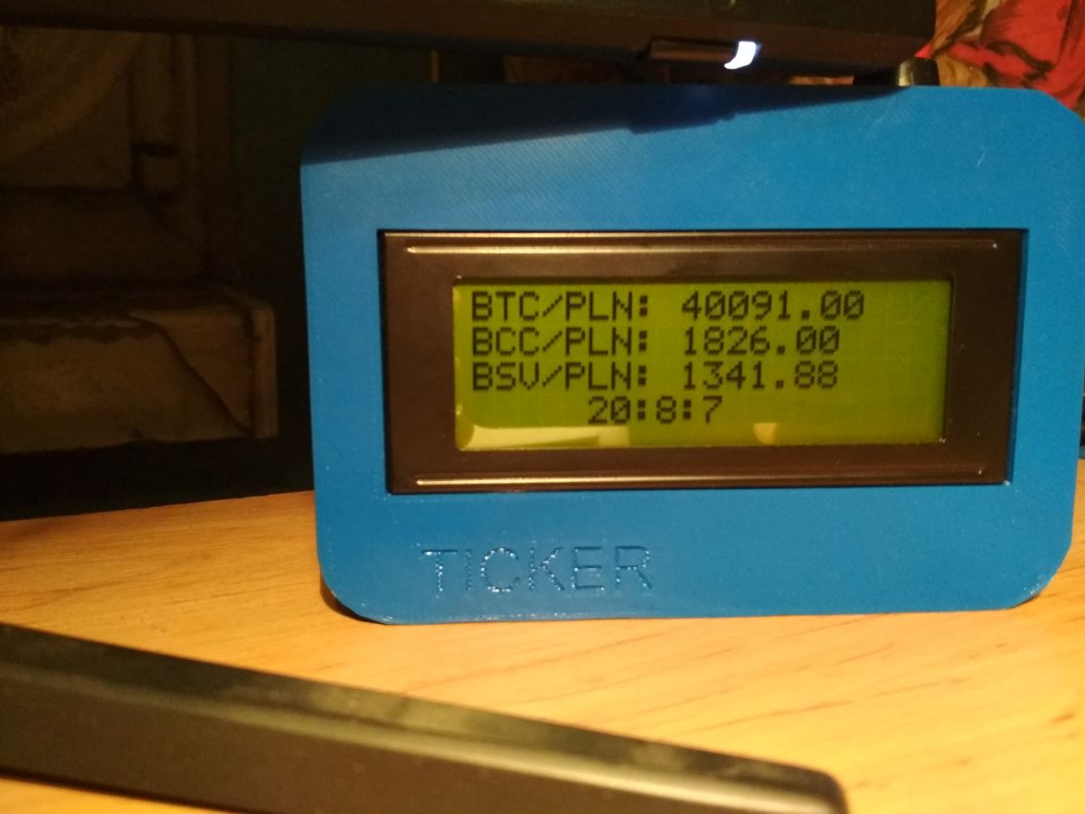

    The project is complete, so I am closing the topic. The project wouldn't really have happened if it wasn't for the help of khoam once again huge thanks. The certificate that khoam writes about can be found on the Firefox browser according to the instructions in the attachment under the name Certificate. I have also designed an enclosure for this project, of course it can be used for another project that uses a wemos r1 d2 and a 4x20 LCD display (note before printing please measure the distances of the slots in the wemos, I modelled the dimensions on ready-made enclosures for wemos and the dimensions did not match reality). The code may appear to be "pooled" (these are my inserts not khoam's) but it works and does the job. The whole project can be downloaded at this link: https://drive.google.com/open?id=1qeVcJkwW3P7SMQERinYGUtUpMU9ug-X7

    There are two things to be improved/revised. One as the khoam himself pointed out that it would be useful for authentication from bitbay to be via a CA certificate rather than a fingerprint. I've tried to implement this but it's not my level, I've only just started with arduino. Where do I get something like the picture from? How do you do it? The other thing is that I would like the display backlight to turn on when I "wave" my hand, and it works, but the problem is that there are delays and other functions that delay. Do you have to use esp32 or is it enough to improve the code somehow? I tried to solve this problem with the millis() function but was unsuccessful.

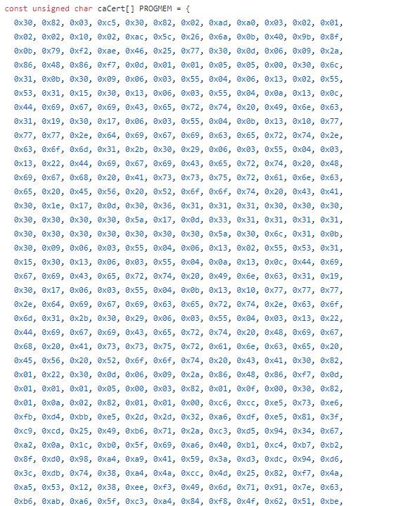

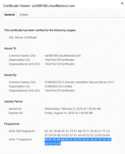

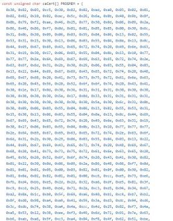

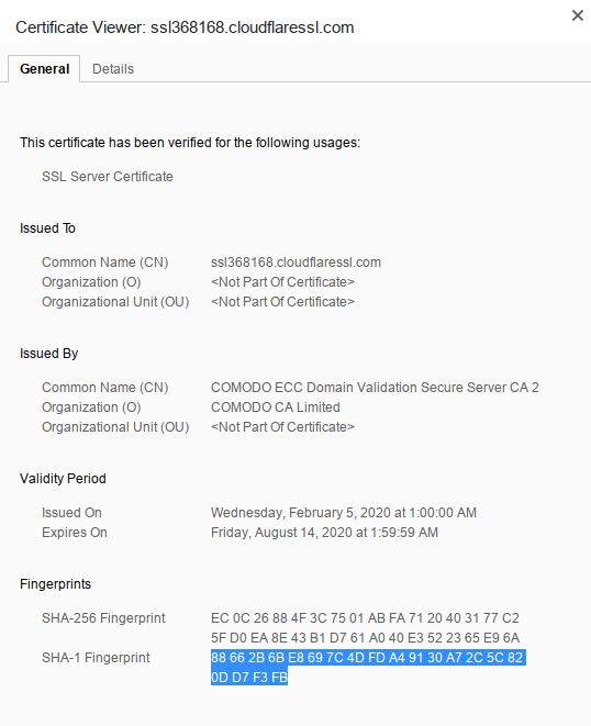

    Maybe a better solution to start with would be to retrieve this data without validating the site certificate or fingerprint. The main change is to replace the following line of code:
    Code: c Expand Select all
    client.setFingerprint(fingerprint);
    By the following:
    Code: c Expand Select All
    client.setInsecure();
    Check if this will work with the "api.bitbay.net" website.
    The change works with api.bitbay.net.
