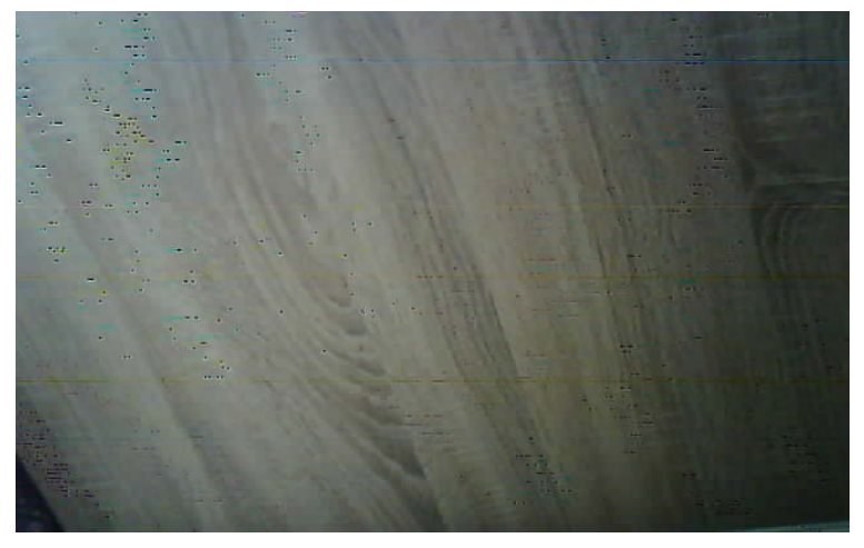

    I have a problem with the image from an ArduCam OV2640 camera (exactly this one: https://botland.com.pl/kamery-do-arduino-i-raspberry-pi/6837-modul-kamery-arducam-ov2640-2mpx-1600x1200px-60fps-z-obiektywem-ls-4011-m12x05-5904422349790.html ).
    I use a ready-made example in the Arduino IDE on the ESP32 (https://github.com/espressif/arduino-esp32/tree/master/libraries/ESP32/examples/Camera/CameraWebServer ).
    The image is transmitted over Wi-Fi, with no jams or delays. The problem is the image where there is interference (black, blinking spots and horizontal lines).
    Esp32-DevKitC-VE + ArduCam OV2640: Image Interference and Resolution Issues .
    The ESP32 I am using is ESP32-DevKitC-VE (WROVER-E). The only thing that helps a little to reduce the interference is lowering the XCLK clock with a consequent drop in FPS, but it doesn't completely solve the problem.
    The other issue is the resolution of the camera. It should work up to 1600 x 1200 and its max is 800×600 with a higher one the image does not display. Connecting the camera according to camera_pins.h (CAMERA_MODEL_WROVER_KIT) in the example program.
    I'm looking for some suggestions, suggestions to solve the problems. I'm just starting to play with cameras and don't really grasp too much about certain issues yet. Thank you in advance for your reply.

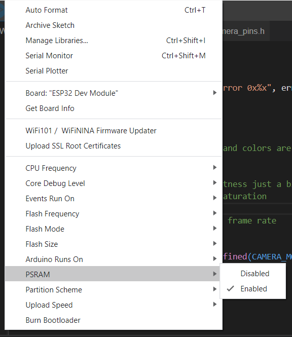

    I got the ESP version wrong I have an ESP32-DEVKITC-VIE with a built in I-PEX connector, I will solder a resistor from the built in antenna to the I-PEX and check although I doubt it is a range issue, I have the router 1m from the board but it is worth checking.
    I have modified the code and it throws errors like this:
    After which there is a reboot always above SVGA. The board has 8 MB PSRAM it should embrace UXGA. An ESP32 CAM having 4 MB PSRAM on the same program can handle it at nobody FPS.
    PSRAM I seem to have enabled in the Arduino IDE:
    If I disable it and the rami buffer uses DRAM is the max resolution then the VGA continues to pop up.
    I also tested on ESP32-DevKitC-32E V4 (ESP-WROOM-32E) with DRAM and it is the same.
    I found a similar project https://www.youtube.com/watch?v=qsBIUTUxpEM&ab_channel=anErik .
    The resolution will somehow survive, as overall VGA/SVGA is enough for me. The camera will be used for a Wi-Fi controlled robot with a smartphone. What I care most about is to cancel out image noise.
