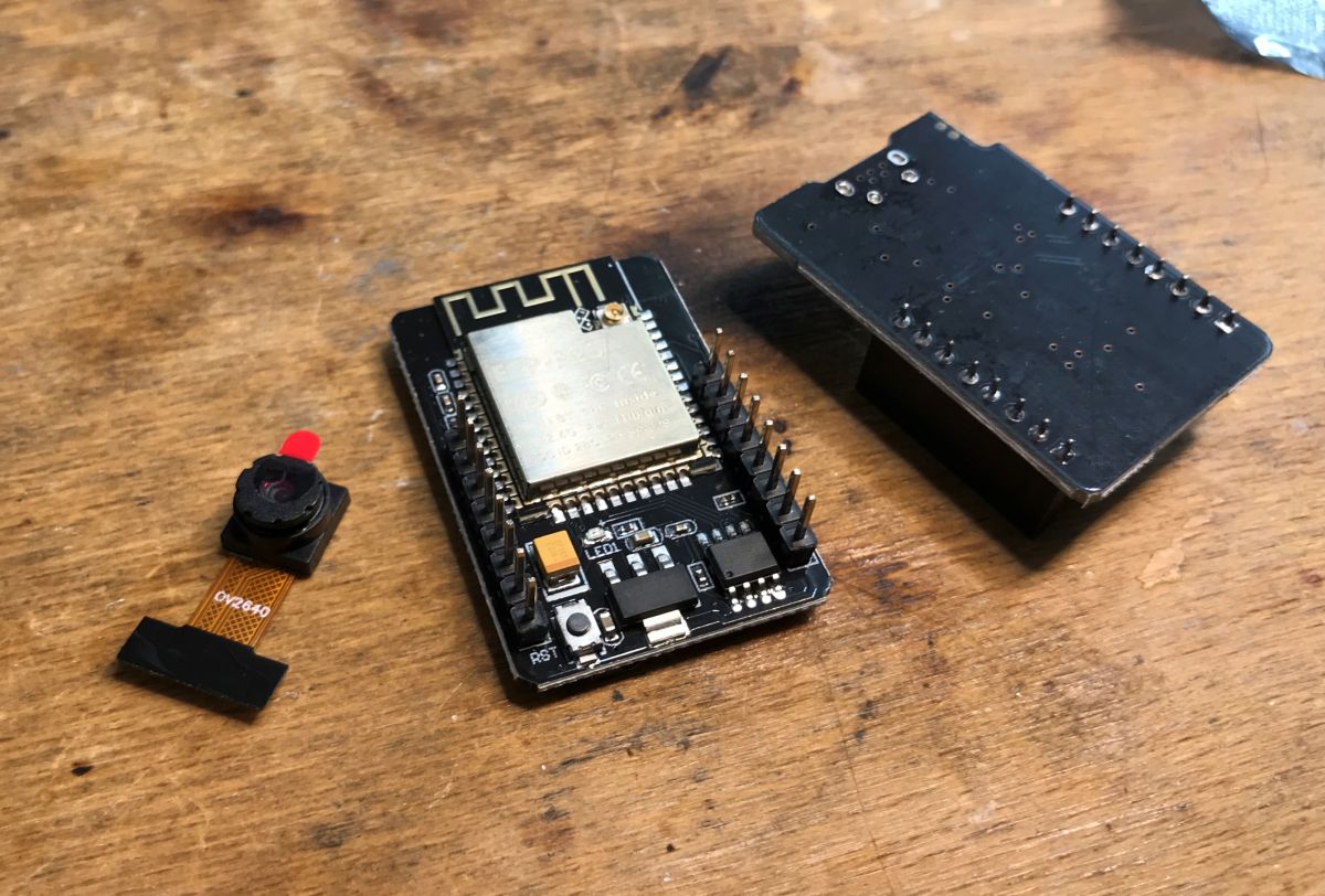

    Here I'll cover running the ESP32-Cam in PlatformIO, analyse how streaming video (?) from this board works, and show how to access the pixels of the image taken from the camera (e.g. to draw rectangles).
    The ESP32-Cam is a small and handy board offering an ESP-32S module (4MB Flash, 520KB RAM) along with an additional 4MB of external SRAM, and the eponymous camera (OV2640) with up to 1600×1200px resolution. Next to the camera there is also an LED which can be used as a backlight, and on the other side of the board we have a slot for a microSD card to, for example, save photos taken on it.
    The ESP32-Cam is normally programmed via UART, like other ESP modules, but it is worth buying an ESP32-Cam-MB adapter for it, which is basically a CH340G-based USB to UART converter.
    You can get a whole kit like this for a few tens of zlotys, depending on whether you buy in our country or import from China.

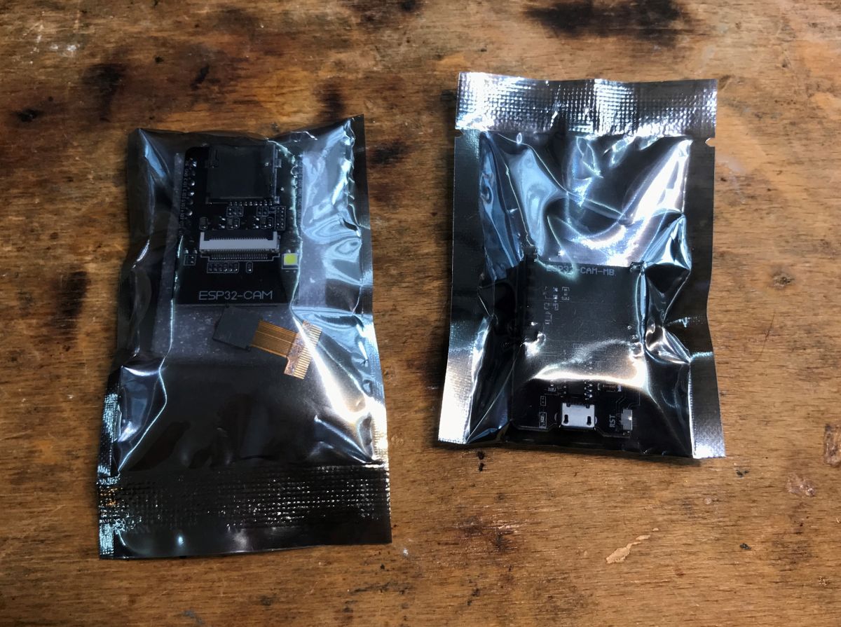

    Here I will present just such a kit:
    ESP32-Cam packaged in a plastic bag Two packaged ESP32-Cam kits on a wooden background. ESP32-Cam with OV2640 camera and ESP32-Cam-MB adapter on a wooden table ESP32-Cam board with OV2640 camera and MB adapter on a wooden surface. ESP32-Cam with ESP-32S module and additional hardware ESP-32S module with visible chip and antenna connector. ESP-32S module with visible chip and antenna connector.

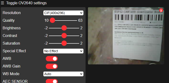

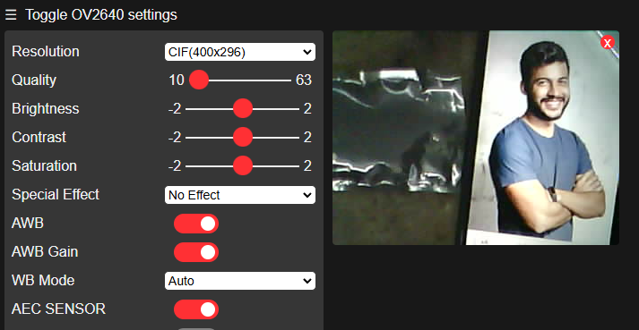

    A control page is available at IP address 192.168.4.1, along with a live view of the camera:
    ESP32-Cam camera settings interface User interface with ESP32-Cam camera settings. OV2640 camera configuration interface on ESP32-Cam with quality and resolution settings. ESP32-Cam settings interface with image preview User interface for adjusting ESP32-Cam OV2640 camera settings. .

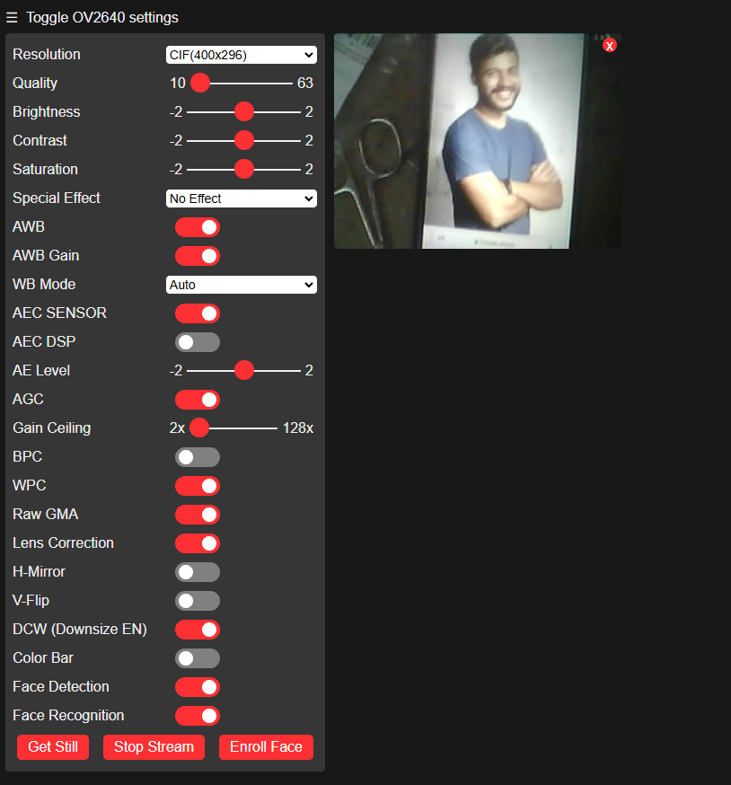

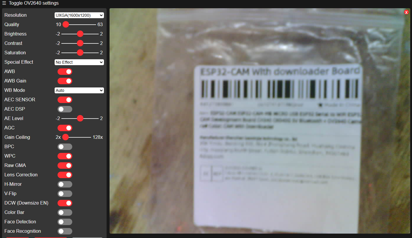

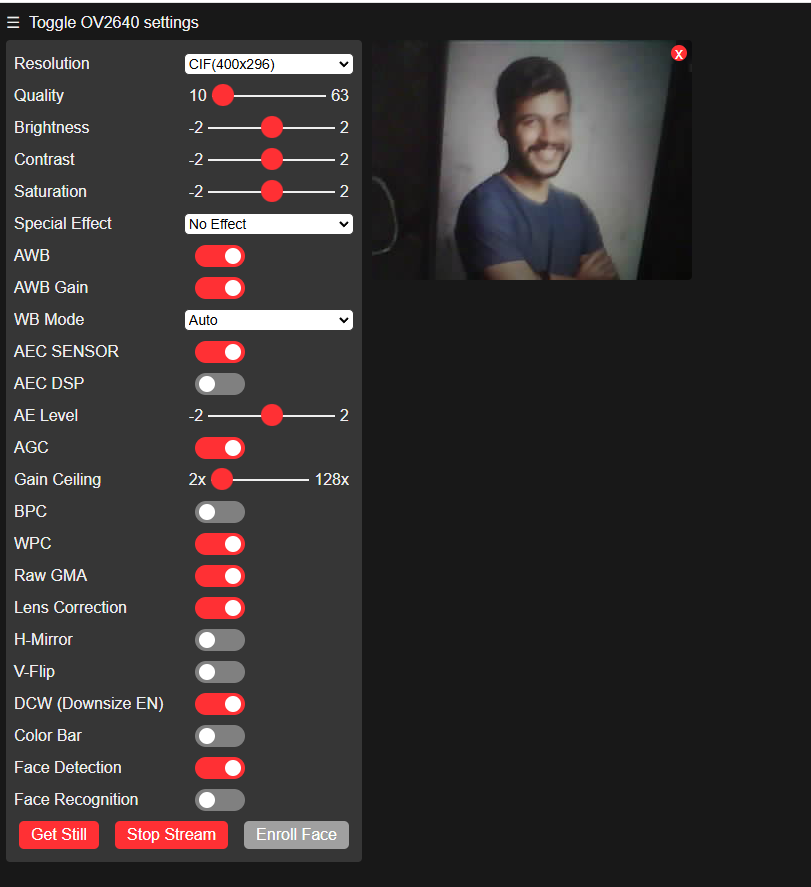

    Something didn't sit right with me at first, and then I realised that I had tested without removing the protective film from the lens! It was because of this that everything was so blurry. Here's another one now, with the film off:
    ESP32-CAM settings panel with image preview. User interface with ESP32-CAM camera settings and a blurred image. OV2640 configuration interface with camera image .
    Face detection in both cases did not work either on my person or on photos from the internet.

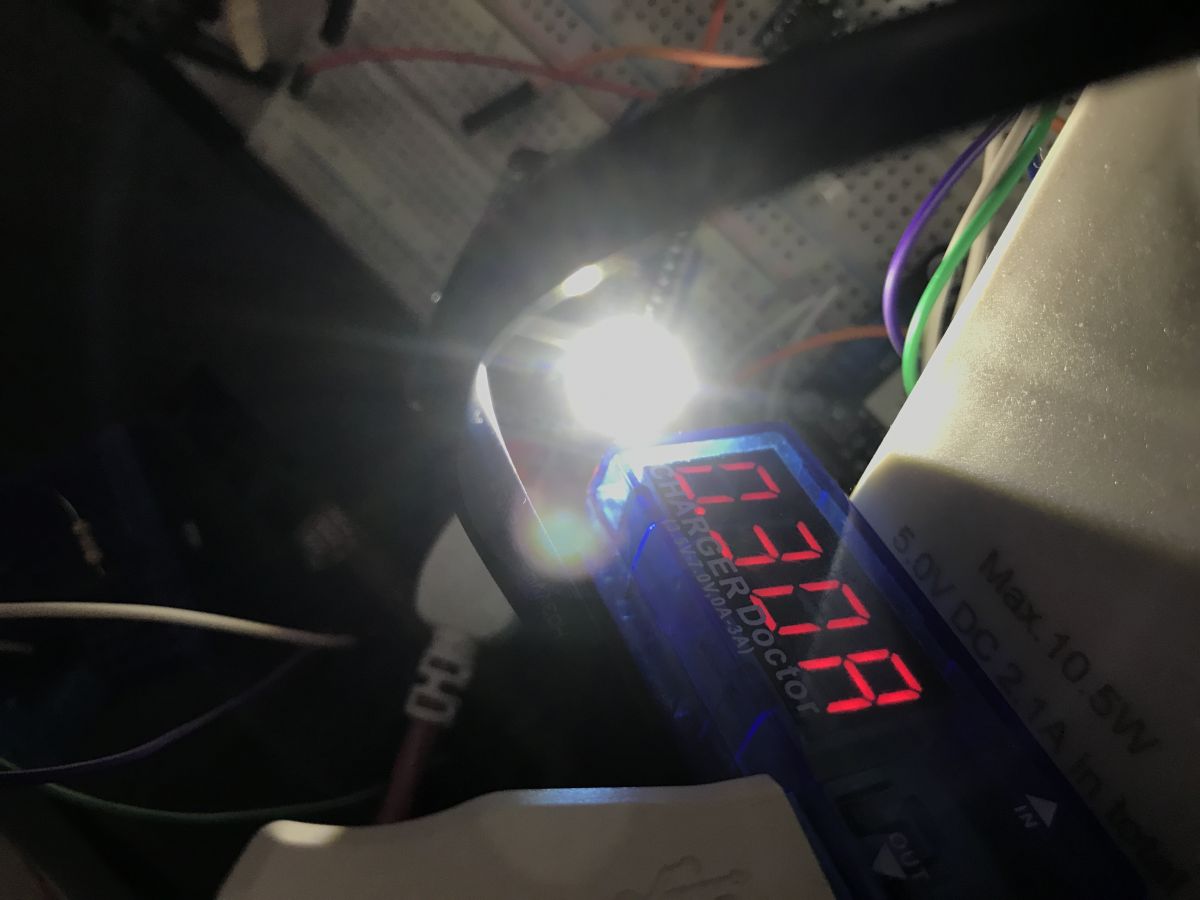

    Here is the current draw when streaming video, 250mA measured before LDO, at 5V:
    ESP32-Cam connected to power with a display showing 0.25A .

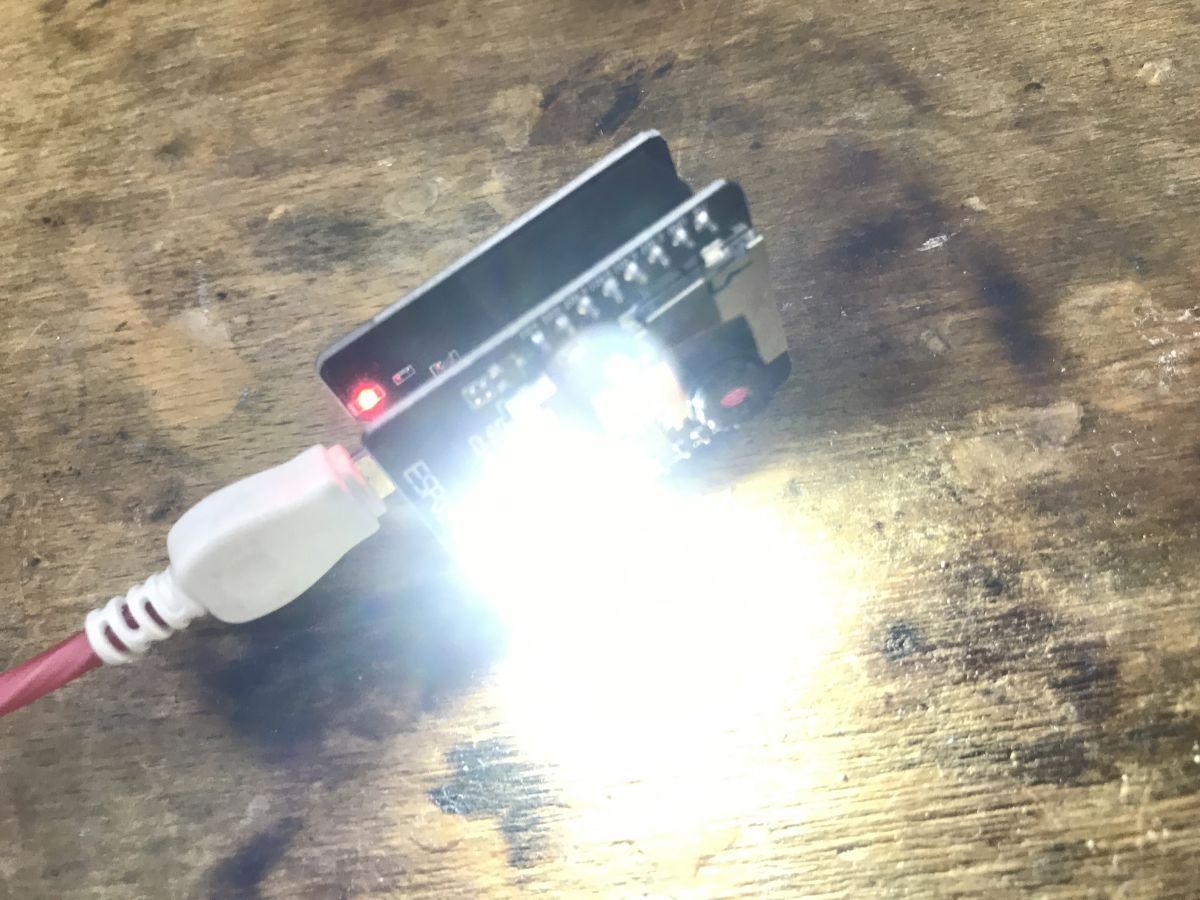

    <br> LED operation .
    The LED in question is located on pin four:
    Code: C / C++
    We set this pin to output mode just like on the Arduino:
    Code: C / C++
    We will add an HTTP endpoint to handle the pin:
    Code: C / C++
    The endpoint also needs to be registered:
    Code: C / C++
    It would now be possible to send a manual POST to control the diode, But it is easier to add buttons on the control panel:
    Code: HTML, XML
    From now on it is possible to control the LED from the web page:
    ESP32-CAM with control interface .
    The LED consumes approximately 50mA:
    ESP32-Cam current consumption meter ESP32-Cam with USB cable connected and LED light on .

Why does the ESP32-CAM image look blurry out of the box, and what should I check on the OV2640 lens before troubleshooting software?
First check whether the protective film is still on the OV2640 lens. In this thread, the image looked bad until that film was removed, and the author states that this was why everything was so blurry. Do that before changing frame size, JPEG quality, or web code. This is the fastest hardware check, and it can save hours of pointless software debugging. [#21360136]
