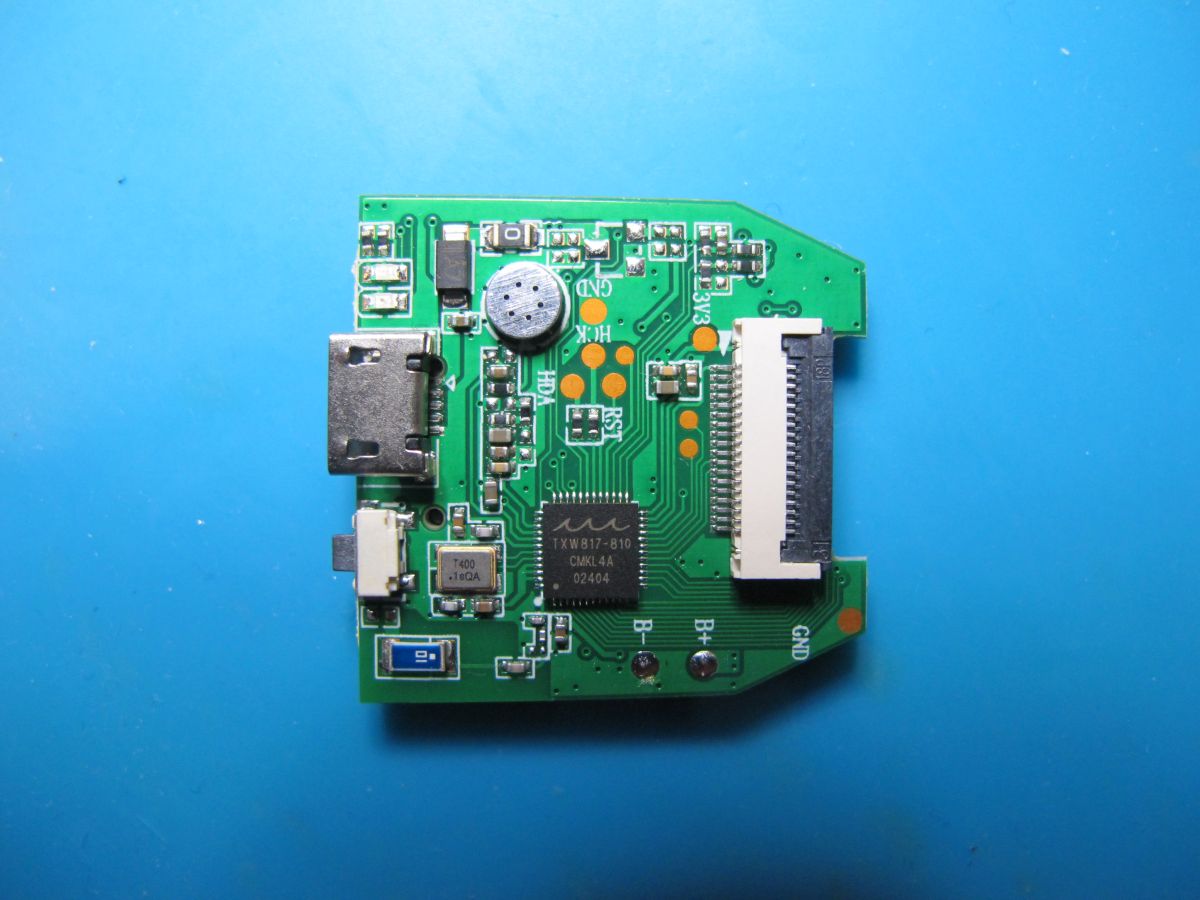

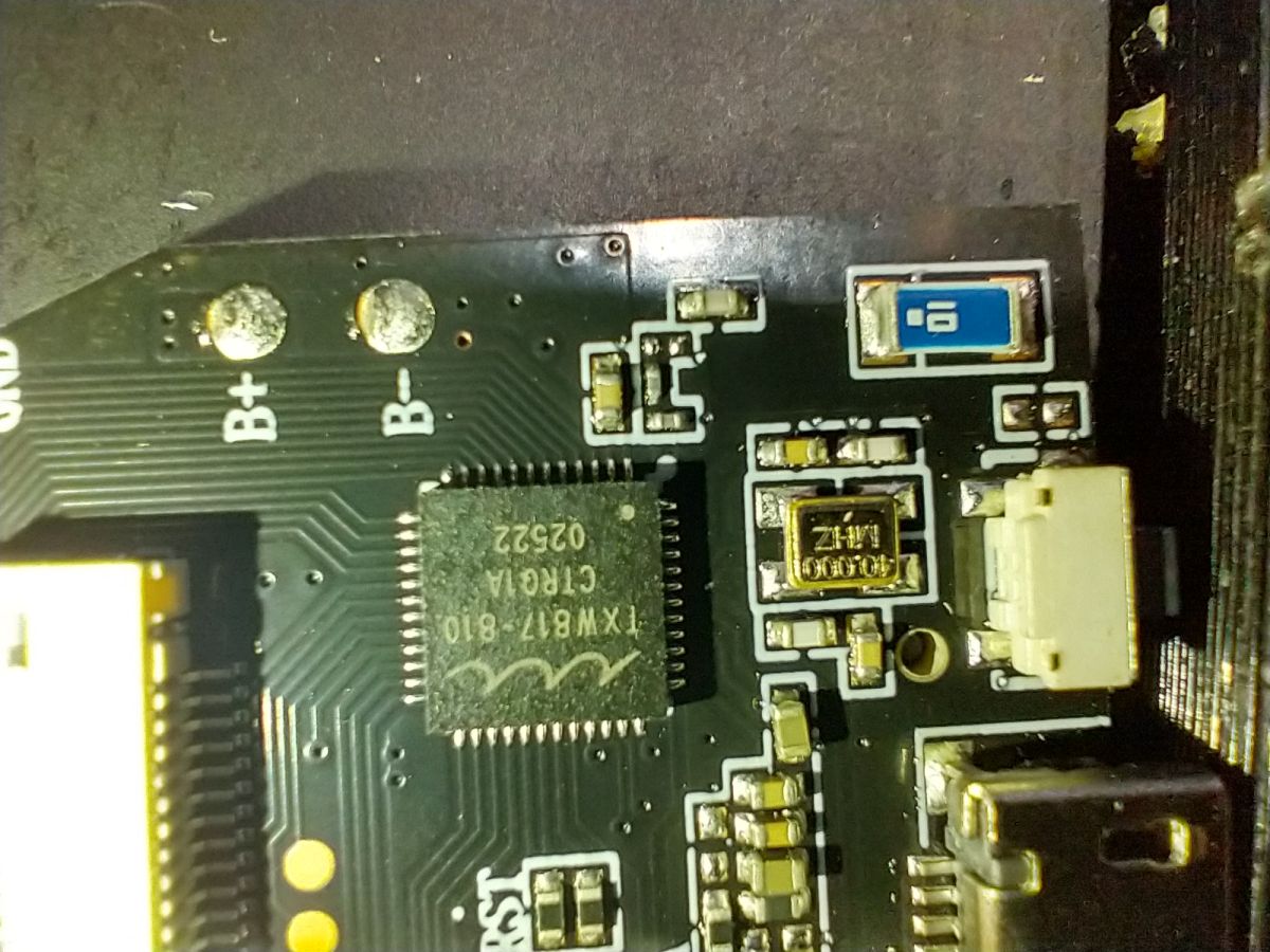

    out of interest, what does your X5 PCB look like?

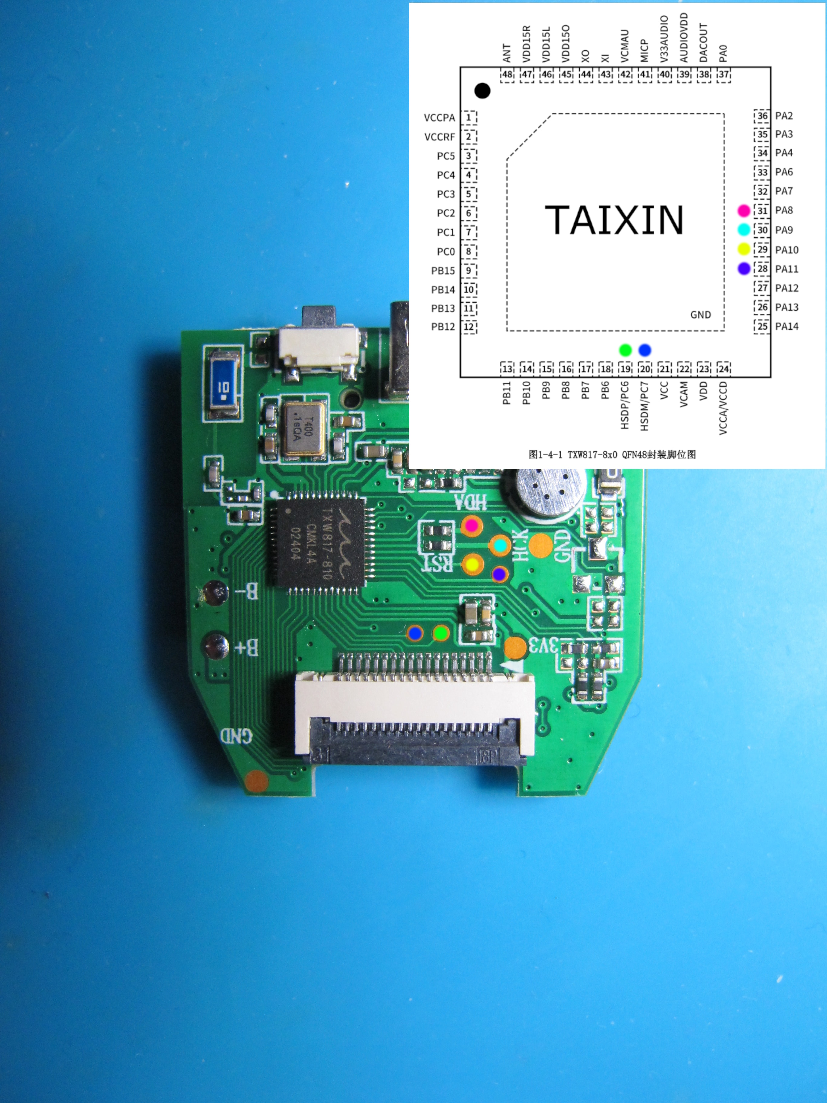

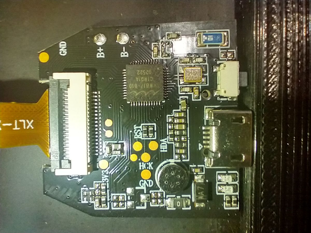

  • #4 21693128
    tsisaris
    Flashing Open-Source Firmware on X5 Mini Camera (TXW817-810 SOC): UART & Logic Analyzer Help

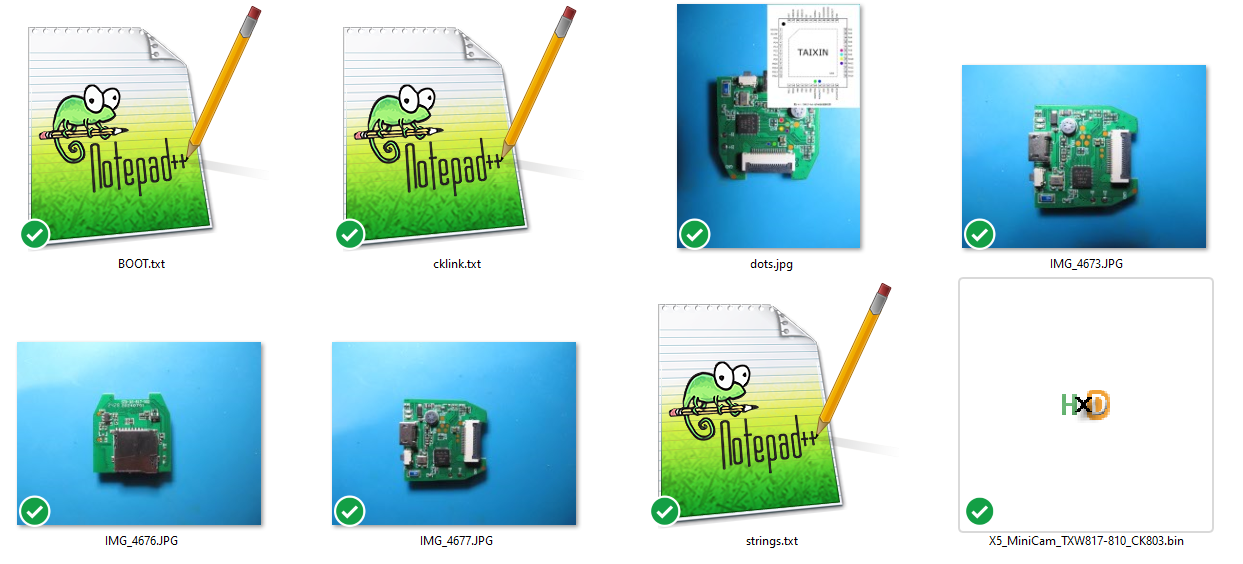

  • #5 21693151
    Posts: 5234
    Help: 449
    Rate: 918
    cool. looks familiar. don't think I've posted about mine anywhere yet. definitely not tried OpenTXW81X on it
    backup was same process as other TXW817s
    Green PCB with USB ports and a large ribbon connector on a blue background

  • #13 21695322
    max4elektroda
    Posts: 758
    Help: 49
    Rate: 189

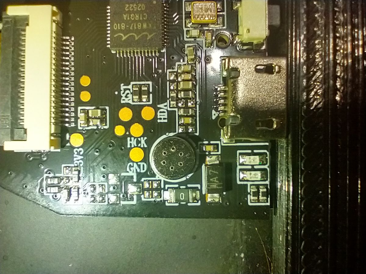

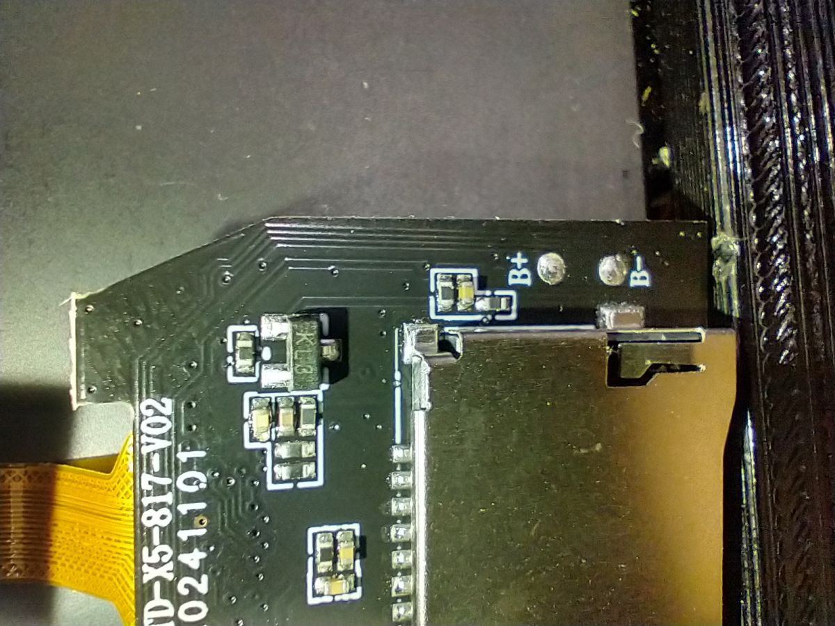

    If you allready made an backup, could you please add labels to the picture?
    Which point is P10 (DebugCLK)?
    I assume P9 (DebugIO) is the HCK point and P8 is HDA as on the other X6 device shown in this post?
    Thanks!
  • #14 21695336
    Posts: 5234
    Help: 449
    Rate: 918
    sure. this is from November 2024, so I assume it's correct because I would have used it in May when I made the firmware backup. I recall the labelling was a little wrong on this, so it would make sense that the RST pad is indeed actually PA10

    you can visually trace most
  • #16 21695378
    max4elektroda
    Posts: 758
    Help: 49
    Rate: 189

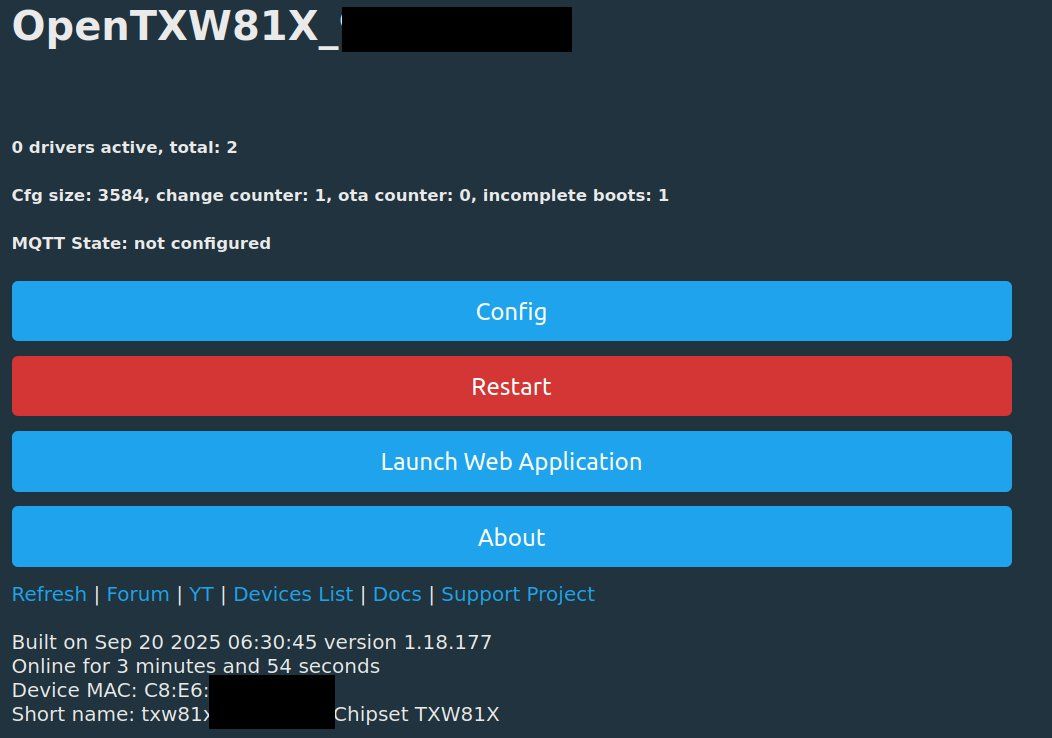

    Indeed, Thanks:

    cool. are you finding that board has stuck to SDK defaults re cam/mic or maybe you're yet to get to that point. The TXW adventure does span several threads now.
  • #18 21695407
    max4elektroda
    Posts: 758
    Help: 49
    Rate: 189
    I think I didn't understand the question (maybe I need to get to that point?)
    I get an RTSP stream with some (distorted) audio - sounds like there's an engine running, but I can hear sounds ...

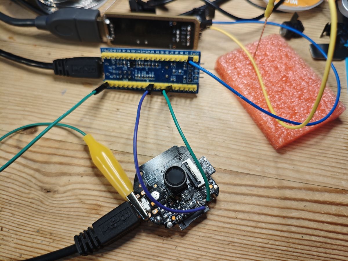

    yet to get that point = at the stage where you know if the cam is using SDK default pin assignments. Sounds like you are ;)
    What cam did yours come with?
    Added after 5 [minutes]:
    at least the mic is default I guess.
    Mine sounds crap anyway but with grounds connected to usbttl and STM32 it's worse. Not *too* bad though

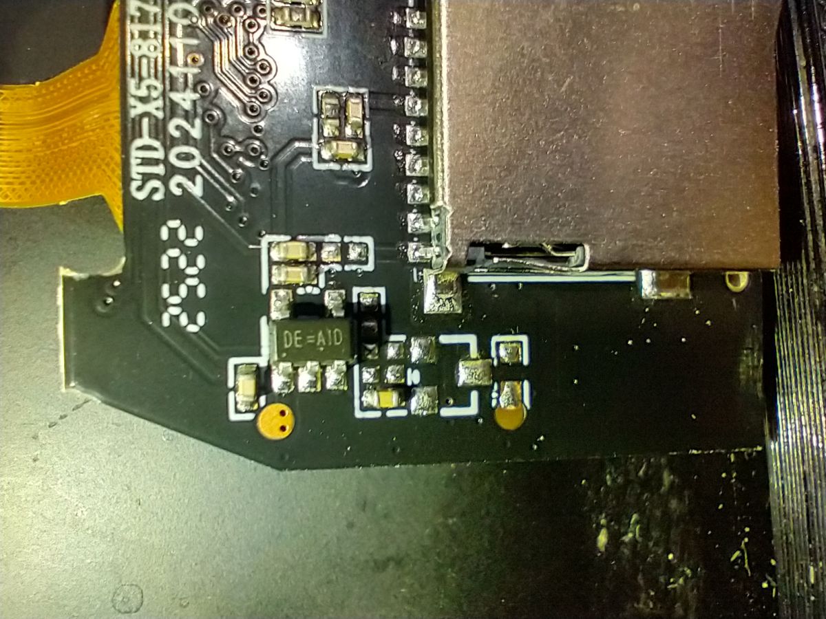

  • #20 21695439
    max4elektroda
    Posts: 758
    Help: 49
    Rate: 189
    Cam is labelled X5-G29-2364V1 (it's allready mentioned in the "Identifying Mini Cam Modules"-thread.)
    Soldered TX line, so I can also give the output from loading the driver:
