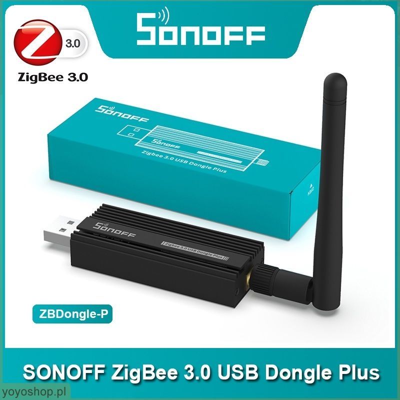

    Hi do you have any tutorial on how to properly install the zigbee dongle 3.0 sonoff on Linux debian and bundle it with domoticz.

    Give some number of this dongal or a picture of anything. Because dongli is from zajjj.... . Also, I personally recommend HA for zigbee support, not domoticz.
    Edit:
    Is this the kind of dongle you are referring to?
    Installation guide for the Zigbee 3.0 Sonoff dongle on Debian with Domoticz .

    1.SONOFF Zigbee 3.0 USB Dongle Plus is a universal Zigbee USB stick. It can be used as a universal Zigbee gateway in Home Assistant or other open-source platforms via ZHA or Zigbee2MQTT to locally control all your Zigbee sub-devices, so you don't need to invest in the Zigbee hubs for different brands, all you need is a universal gateway - Dongle Plus!
    2.The dongle plus has a wide range of supported devices, such as BASICZBR3, S31 Lite zb, SNZB01, SNZB02, SNZB03, SNZB04, ZBMINI, S26R2ZB , and various sub-devices from various brands or flash router firmware to extend the network range.
    3.The limits of ZBDongle Plus are 21 direct children and up to 40 children (Default values from official firmware). Supported to connect more by configuring yourself.
    *Updated version (in the near future) will be supported to work with maximum 200 children
    Pre-flashed with Z-Stack 3.x.0 coordinator firmware
    Can use ZHA in Home Assistant or use Zigbee2MQTT
    Base on TI CC2652P + CP2102N
    +20dBm output gain
    SMA interface external antenna
    Aluminum housing effectively reduces signal interference from peripherals
    Optional 1.5m USB extension cable for better signal range
    With HA there is a bit of a combination, you have to make a docker container or virtualBox.
    So what you have shown in the picture.

    The SONOFF Zigbee Dongle Plus is connected to open source smart home platforms such as Home Assistant, openHAB, Zigbee2MQTT, etc., as a coordinator in the ZigBee network, i.e. a gateway to manage ZigBee sub-devices. Users can also sflash the router software themselves and use it as a routing device in a Zigbee network to extend the network coverage.
    Added after 3 [minutes]: .
    From what I've found you're either faced with uploading a different software or putting up a container.
    See maybe this will help
    https://youtu.be/h3HBtdA6AmI
    Watch the video
    Added after 7 [minutes]:
    Here are some more things you need. Unfortunately I couldn't find it in Polish.
    https://www.domoticz.com/wiki/Zigbee2MQTT
