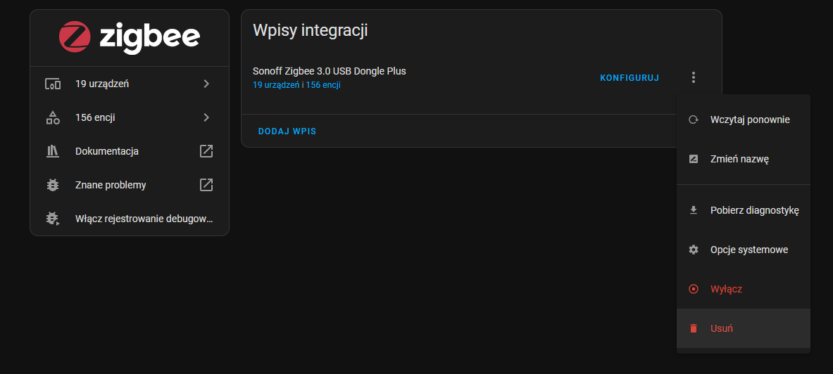

    I have a Home Assis os and a Sonoff dongle 3+. The zha detects the thermostat but there is no way to adjust the temperature and other functions and the zigbee2mqqt so average it wants to work.
  • ZHA device needs dashboard control and configuration

    So should I uninstall zha first and then install zigbee2mqtt?
  • Steps for migrating from ZHA to Zigbee2MQTT

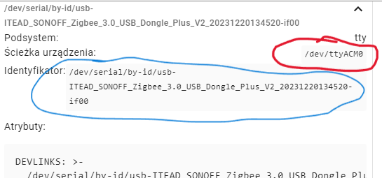

  • #8 21274194
  • Malformed serial port path with extra adapter text
    #9 21274203
    hkielp745
    Posts: 43
    Take something in the logs:

  • Malformed Zigbee adapter path causing startup failure
    #13 21274249

  • #15 21274260
    hkielp745
    Posts: 43
    Rather so something I don't know in the end which of these to copy?
    AVATTO Tuya ZigBee3.0 thermostat integration ZigBee3.0 actuator smart thermostat TRV with home assis
  • #16 21274261
  • Missing udevadm and Zigbee2MQTT startup failure

Which adapter string should I use for a Sonoff Dongle-P V2?
Because V2 runs Silicon Labs firmware, set adapter: ezsp for firmware ≤ 7.3 or adapter: ember for ≥ 7.4, then reload the add-on [Elektroda, sobel23, post #21274393]
I get “Failed to determine if path is valid” for /dev/ttyACM0. Fix?
Point port: to the actual device (e.g., /dev/ttyACM0 on HAOS, or the full /dev/serial/by-id/... entry on supervised installs). Remove extra spaces and reboot Home Assistant after saving [Elektroda, sobel23, post #21274257]
How do I migrate from ZHA to Zigbee2MQTT without losing devices?
  1. Back up Home Assistant.
  2. Remove the coordinator from ZHA, disable the integration, then unplug the dongle.
  3. Install Mosquitto → create mqtt_user → install Zigbee2MQTT → plug dongle back in and set port/adapter.
  4. Re-pair devices in Zigbee2MQTT UI. [Elektroda, sobel23, post #21274172]
