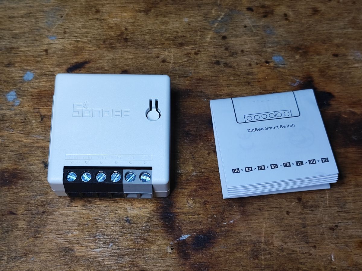

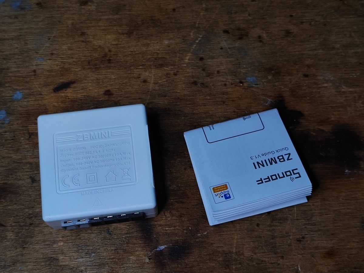

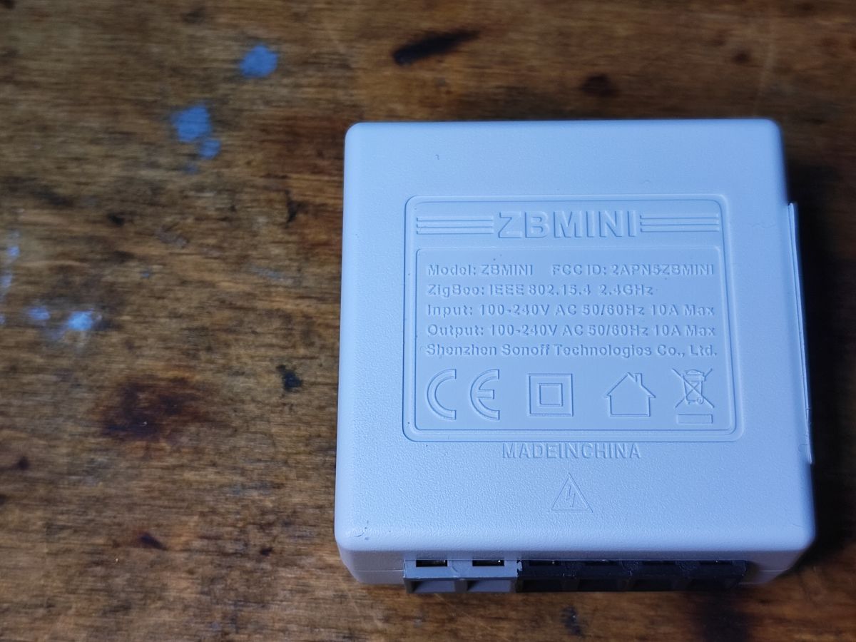

    Contents:

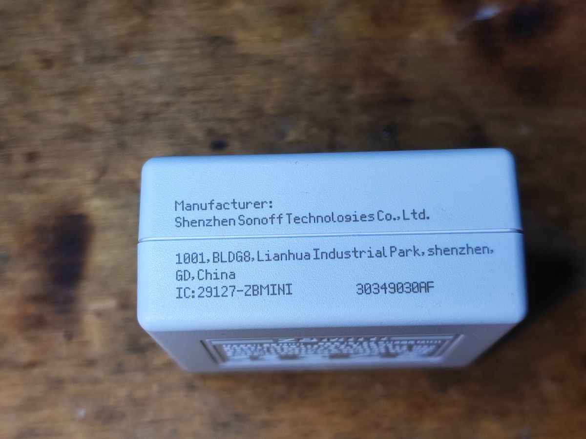

    Small Sonoff ZBMini relay next to a user manual on a wooden surface. Sonoff ZBMini relay with manual on a wooden table Photo of the Sonoff ZBMini device with visible technical markings on the casing. View of Sonoff ZBMini with manufacturer information Shenzhen Sonoff Technologies Co., Ltd. View of Sonoff ZBMini with manufacturer information Shenzhen Sonoff Technologies Co., Ltd. .
    There is nothing else in this kit.
    Instructions:
    User manual for Sonoff ZBMini relay showing pairing instructions. Sonoff ZBMini user manual in various languages with a QR code. Sonoff ZBMini manual in multiple languages. User manual for Sonoff ZBMini relay. Sonoff ZBMini user manual with multilingual instructions. Sonoff ZBMini user manual with multilingual instructions.

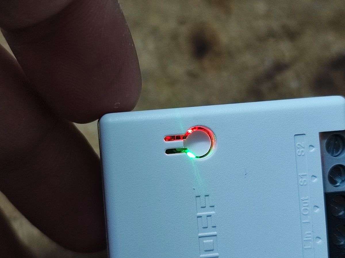

    ... but we are not interested in it apart from entering pairing mode, as we will connect to our Home Assistant via Zigbee2mqtt.

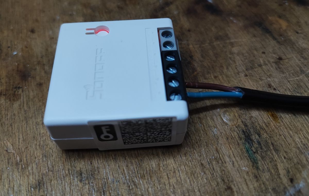

    Sonoff ZBMini is a small, white Zigbee relay with wiring, placed on a wooden surface. Close-up of Sonoff ZBMini with an illuminated button. .

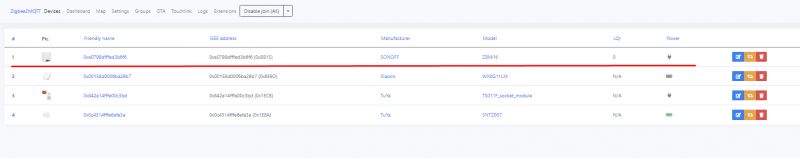

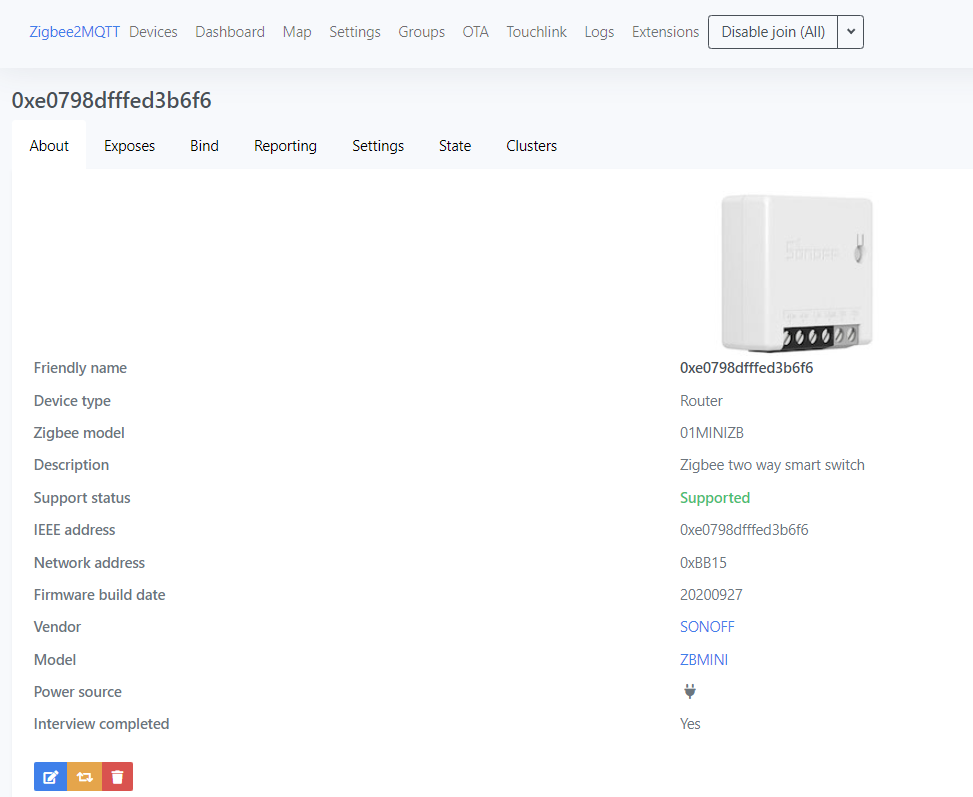

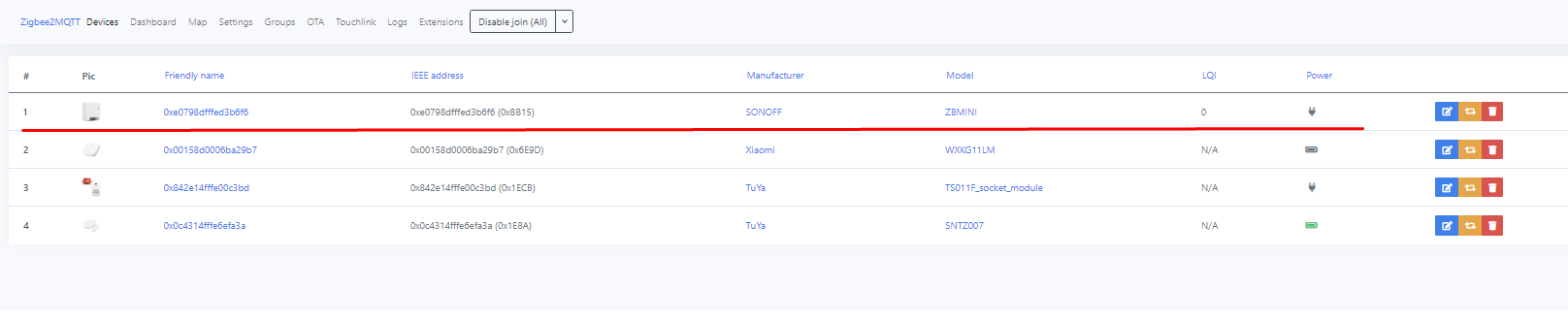

    There is no problem with this, with me a new device is immediately detected: .
    Screenshot of the Zigbee2MQTT devices panel showing a list of connected devices. .
    Information:
    [/tr] [td:9a274500bb] SONOFF [td] [td] Model [td] ZBMINI [td] Friendly name
    0xe0798dfffed3b6f6
    Device type Router
    Zigbee model 01MINIZB
    Description Zigbee two way smart switch
    Supported status Supported
    IEEE address 0xe0798dfffed3b6f6
    . Network address 0xBB15
    Firmware build date 20200927
    Vendor

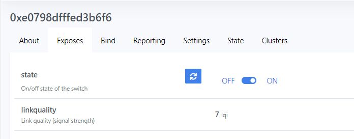

    Communication works both ways, we can control the relay both from the physical switch and from the HA:
    Screenshot of the Zigbee2mqtt interface with details about the Sonoff ZBMini device. Interface for controlling the Sonoff ZBMini relay, displaying the switch state and signal quality. .
    Additionally, this device extends the reach of our Zigbee network.

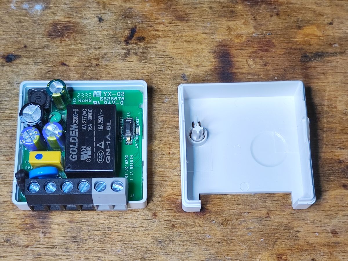

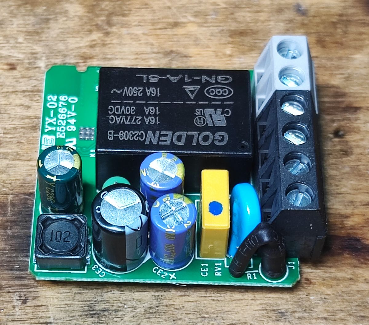

    Interior of Sonoff ZBMini .

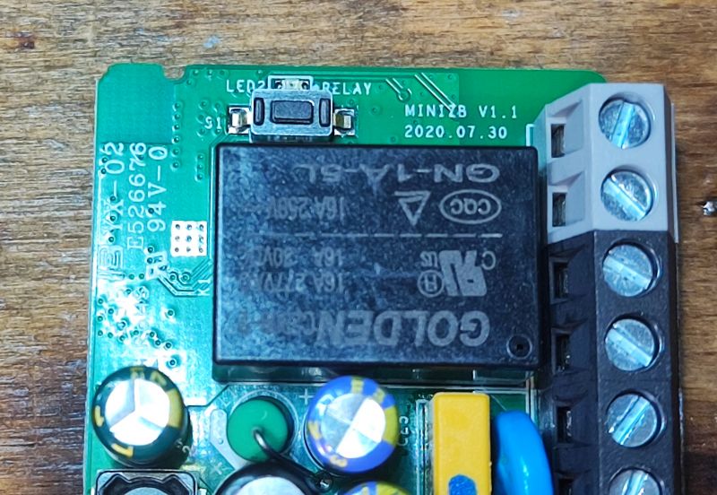

    This device uses Zigbee, there is nothing to flash inside... we are not changing the firmware here. Nevertheless, I will look inside anyway - out of sheer curiosity:
    Interior of Sonoff ZBMini relay with visible electronic components .
    Interior of the Sonoff ZBMini module showing electronic components. .

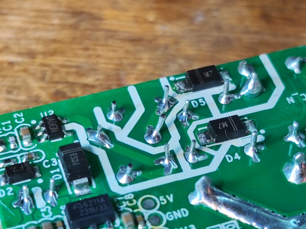

    As befits Sonoff products, the inside is slightly better than the cheapest pieces from Tuya. We have a visible varistor at the input, a filter capacitor, and there are two electrolytic capacitors behind the rectifier bridge too. I don't mention the fuse, because it is practically always there.
    Then there is a non-isolated step-down converter.
    The relay is a GOLDEN G2309-B, GN-1A-5L, 16A 250V.
    Interior of the Sonoff ZBMini relay with visible electronic components. .

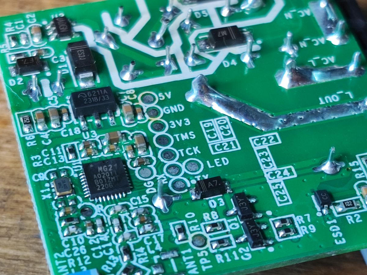

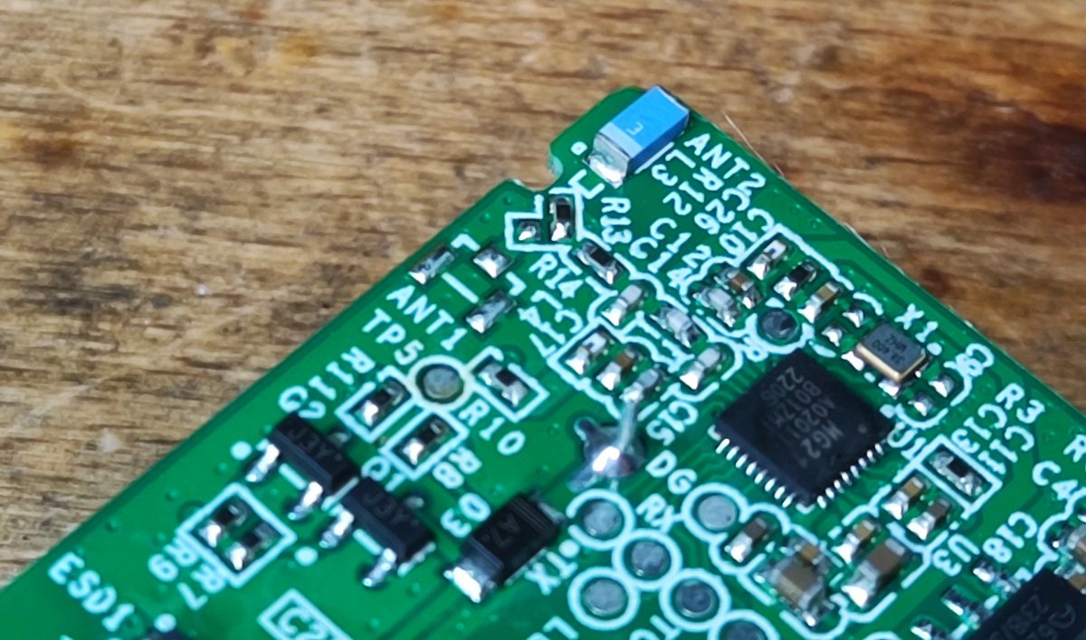

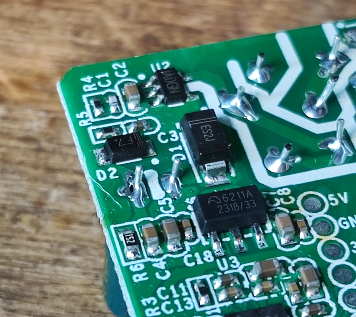

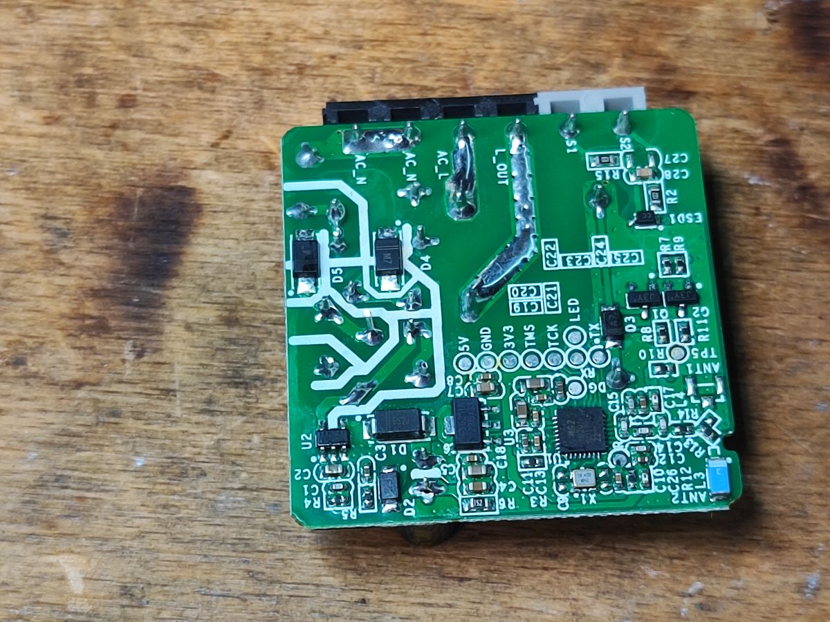

    Now the underside of the PCB:
    Interior of Sonoff ZBMini printed circuit board on a wooden surface. .
    From what I can see, the chip inside is the EFR32MG21 - nothing new, I often see it in this type of product.
    Close-up of a PCB with electronic components. Close-up of the interior of a Sonoff ZBMini circuit board. Close-up view of the PCB of the Sonoff ZBMini device with electronic components. .
    Those pins could be shortened....
    Close-up of a printed circuit board with electronic components.
    Of course, there is still a 3.3V LDO and a transistor to switch the relay and an input circuit from controlling the switch.
