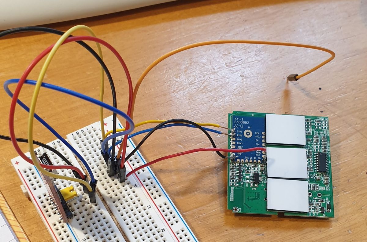

    Flashing
    I soldered wires onto the TXD1, RXD1, GND and VCC pads of the WB3S and connected it up my USB/UART converter set to 3V3, Got the appropriate file to flash it with by this method ( OpenBK7231T_UA_1.15.700.bin), downloaded and 'installed' BK_WriterV1.60.exe, and tried to flash. No joy - got a Failed message!
    Teardown of a Smart Life Curtain (Shutter) switch, Flashing, Configuring and setting up with HA
    After some advice from the ever so helpful p.kaczmarek2 I had the solution. The Tx and Rx pins are both used by the device as Button input and LED output respectively and the circuitry interfered with the flashing signalling. So I cut the Tracks leading away from those pins in the positions shown.
    Teardown of a Smart Life Curtain (Shutter) switch, Flashing, Configuring and setting up with HA Teardown of a Smart Life Curtain (Shutter) switch, Flashing, Configuring and setting up with HA
    Tried to flash again using BK_Writer at the default settings but still no joy. Tried again at 115200 baud and this time it started to erase but then failed. I found then that i could read and save the whole of the preloaded firmware so that was progress.
    I then turned to another method of flashing using a python program. This was successful so I'll just give the details.
    I opened a command window on my PC and created and moved to a directory called 'OpenBKT', then I got the program using the command
    git clone https://github.com/OpenBekenIOT/hid_download_py
    I already had Python installed from years back but you might need that too. When I tried to use the flashing program I found I needed something called 'tqdm' so I got that with the command
    pip install tqdm
    I then successfully flashed the device with the command
    python uartprogram C:\Users\Grumps\Openbkt\OpenBK7231T_UA_1.15.700.bin -d com3 -w -b 115200
    You will need to change the path and com port as appropriate.
    I then repaired the cut tracks. One was easily bridged with a blob of solder but the other just wouldn't so in the end I used a very fine wire.

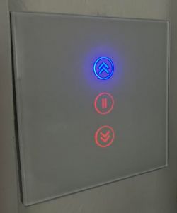

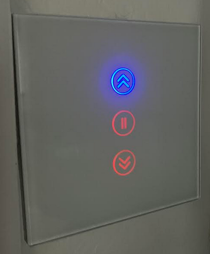

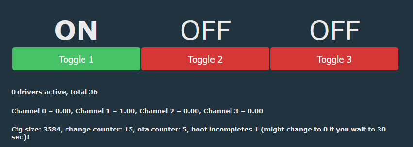

    The Tuya controller has 3 buttons, 3 LEDs which illuminate the buttons and 2 relays. I set them up thus:
    "pin":"function":"channel"
    "6": "Rel;1",
    "8": "Btn;3",
    "9": "Rel;3",
    "10": "Btn;2",
    "11": "LED_n;3",
    "14": "LED_n;1",
    "24": "Btn;1",
    "26": "LED_n;2"
    Everything worked as expected but not how it needed to function so don't connect the actuator at this point!!!!!

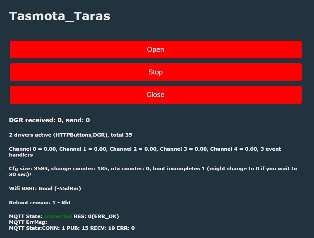

    With more help from p.kaczmarek2 I wrote an autoexec.bat file to emulate the way the Tuya firmware operated. eg pressing the Open button would turn everything off then turn on the Open relay and LED for 10 seconds. It would then turn all off before turning the Stop LED on for just 3 seconds. I think just to confirm all was off and to not leave power going to the actuator when not necessary. As it turns out 10s is not long enough to open the skylight fully so I increased it to 15s. Here's the autoexec.bat file.

    I hid the default buttons since they could be used to turn both relays on at the same time and I don't know how the actuator would cope with that! After lots of testing, pressing buttons at random, I was satisfied the code worked ok so connected the actuator.
    And it works

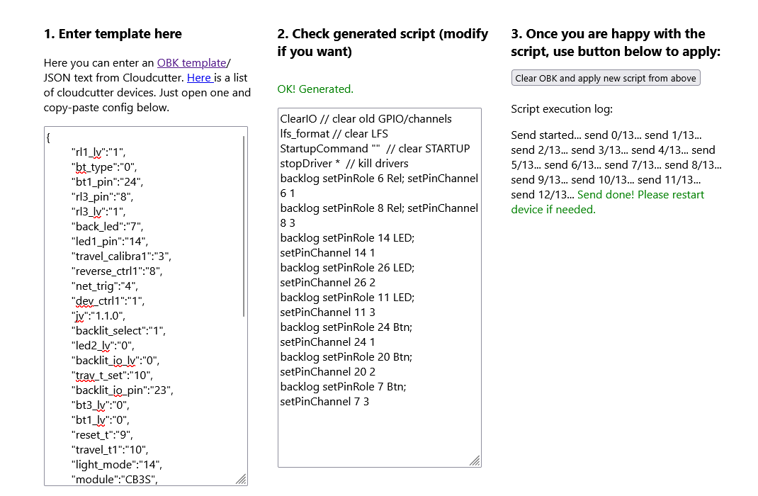

  • Autoexec improvements for stop behavior and persistent timers
    #8 20639305
    Acefx
    Posts: 23
    Hi,
    I wanted to thanks you for your work, that helped me a lot.

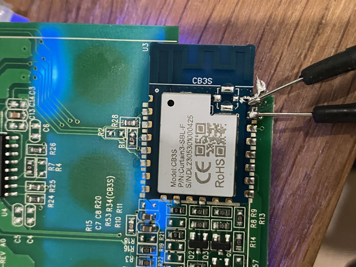

    Just flashed a "Etersky" wf-cs01 roller shutter module with some of your recommendation
    Despite the fact it's running on CB3s and the wiring aren't the same i succeed making it work as intended.
    I write to you about the Autoexec script which may need some improvement. :-) :-)
    First, do you think it's possible to have the closing/opening delay time variable into the web command interface.
    I think it's not very handy to edit the delay inside the Autoexec.bat
    The second improvement is that when you touch a second time the button up/down button, it should stop the opening/closing if i was operating at this time.
    I also have a strange bug that occurs on the physical touch of the up button, the relay seems to do an on/off/on very rapidly.
    Does @p.kaczmarek2 the script wizard could improve the integration ?
    I will post my template as soon as it's completely tested
    Cheers
    [EDIT] Ok i got some more time to edit it a little bit.
    Now the switching between relay with the stop condition is fast
    I also add a variable for the Mouvement timer, and the led ( on my model )
    all the data are reboot persistent.
    Here the script

  • Dashboard button workaround for autoexec states
    #15 20665983
    marnypopis1
    Posts: 12
    I have the same problem, and for now, I'm living with it - I've built a button in the dashboard that triggers states from autoexec, and then it works as it should. Through MQTT, there's only relay 2 working independently. So, it's possible to turn both on at once and boom.
    That's how it is for me now.
    It resembles TASMOTA, but MQTT doesn't see these three buttons and doesn't create three entities from them. I'm waiting patiently until someone figures it out - then it would be complete. Heck, one could even combine TASMOTA with Openbeken and create a single platform ;-)

  • Open and close buttons stay latched on BK7231T DS-151
    #20 20870978
    Romanusss
    Posts: 6
    Hello !
    Thanks richardsg307 for your great work about this device.
    I flashed my own Smartlife DS-151 and got a strange behaviour, if I press Open or Close the button keeps ON or OFF.
    Touch panel with illuminated buttons: blue and red.
    I have the same on OpenBeken web interface,
    Screenshot of an interface with three buttons labeled Toggle 1, Toggle 2, and Toggle 3.
    I also have the pause button that doesn't respond.
    Here the pin settings
    Any idea?
  • #21 20871172
    marnypopis1
    Posts: 12
    You haven't done the most important thing - you need to add entries to autoexec.bat as mentioned earlier in the posts. Without that, it won't work.
    Moderated By p.kaczmarek2:
    On com domain, please use English - I translated the post
  • #22 20871307
    Romanusss
    Posts: 6
    Wow!
    Sorry for my lack of attention, it works perfectly...
    Thanks for support :)

    Romanusss
    Posts: 6
    Hi Everyone !
    Have you tried to configure DS-151 with BK7231N chipset?
    I tried but it seems to get only 1 relay, close and stop (physical) don’t respond to pressure.
    I got multiple strange logs regarding PIN 8 (Close):
    Info:GEN:8 Button_OnLongPressHold
  • #27 21752395
    Posts: 14823
    Rate: 12994
    Hm do you know how pin 8 is connected physically? Can you do Tuya config extraction? That message would mean that you configured it as a button but it's permantently shorted to ground so OBK sees it as a button that is held all the time.
  • #28 21752494
    Romanusss
    Posts: 6
    >>21752395
    Hello p.kaczmarek2,
    Thanks for your reply !
    I don’t know How PIN 8 could be connected but I join you a picture took during the UART flash.
    How to extract Tuya configuration?
    CB3S module on PCB with attached test probes and visible SMD components
  • Suggesting Tuya config extraction with OpenBeken
    #29 21752496
    Posts: 14823
    Rate: 12994
    Tuya config extraction:
    Thanks for the pic, but it just tells us there is a CB3S and that it may or may not be TuyaMCU. It doesn't show where P8 is connected. We would need to investigate the PCB a bit. Maybe with multimeter.
    Maybe let's try Tuya Config extraction first. It's a very useful feature of OpenBeken, maybe it can work here as well? Not all Tuya devices have this config present, but we'll give it a go.
  • #30 21752510
    Romanusss
    Posts: 6
    >>21752496
    WOOOW, you are just so genius !
    It seems kindly better, All the physical button seem working properly now.
    Just to help the community, please find a screenshot of the config import from Tuya config extract,
    Screenshot of Cloudcutter config interface with JSON template input and generated OBK script.
    Great thanks !!
